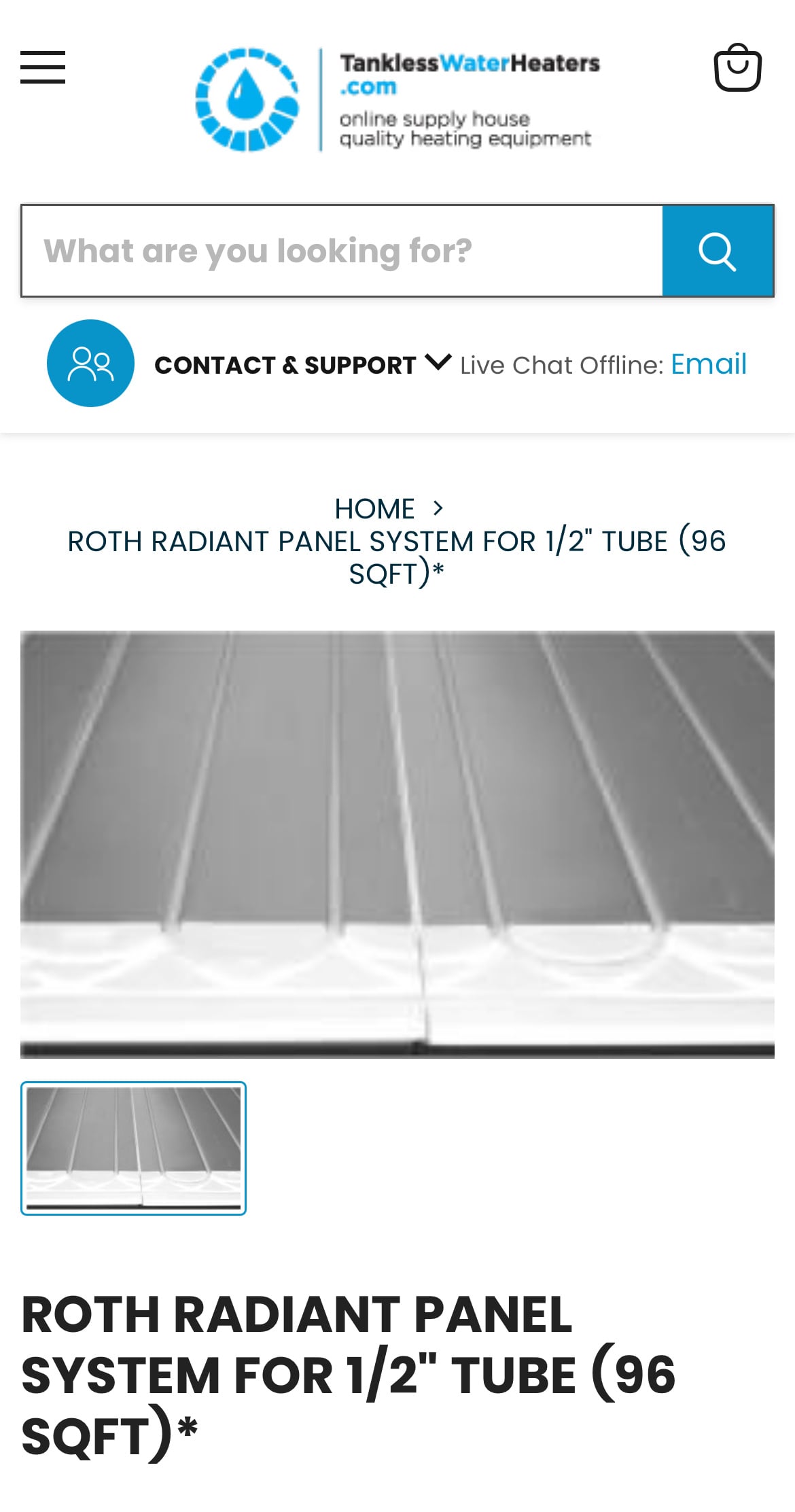

    The panels with foam work well for over the top. Roth for example, although other brands are available now.
    The Roth panel lets you use 6" OC spacing, 3/8" tube for easy installation.

    Thanks for the responses, I'll try and answer some of your questions.

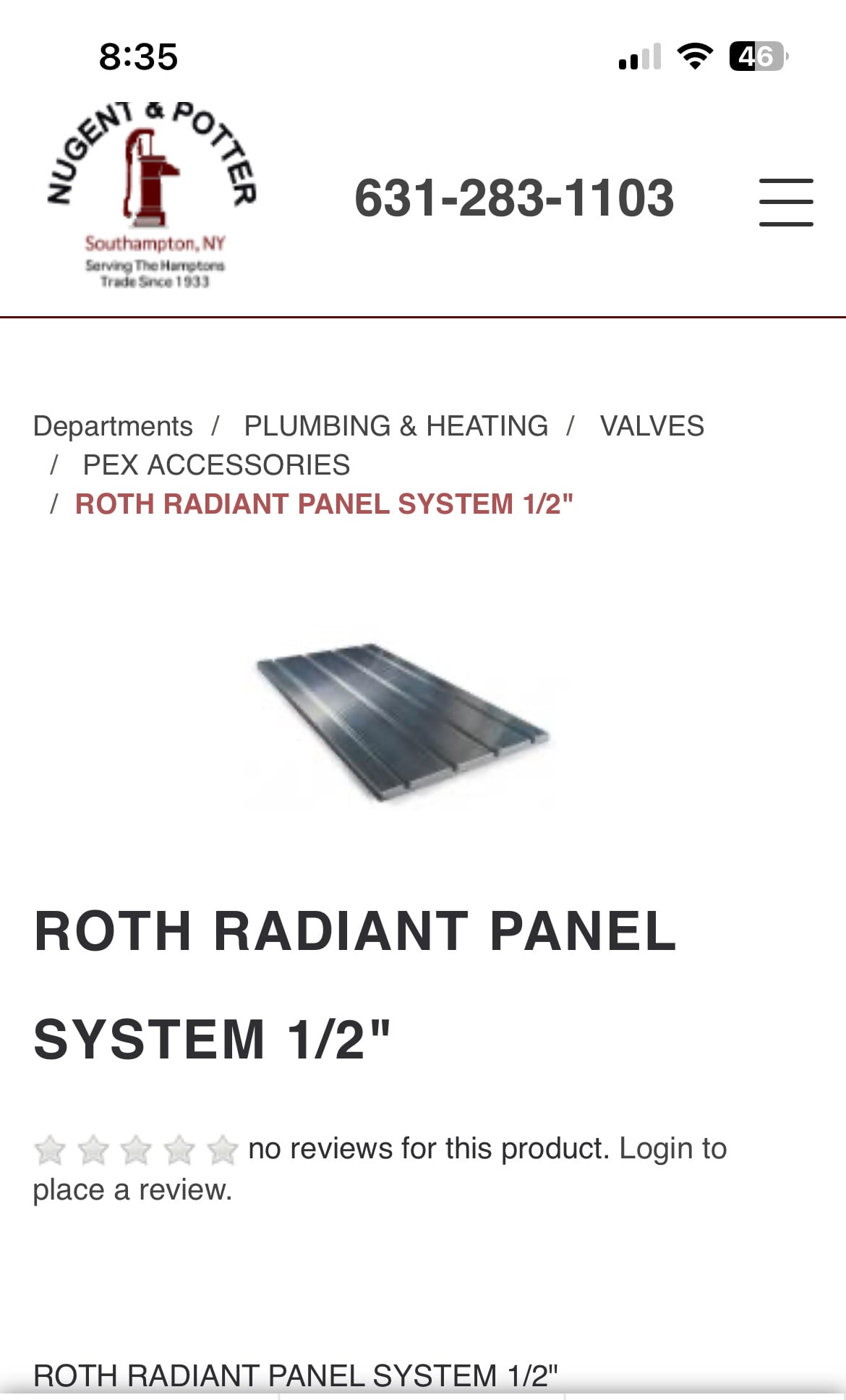

    The bathroom is 50sqft, 28sqft of heated floor. The bathroom is on the 2nd floor of a two story 60 year old house and the space beneath is heated living space. The bathroom is currently heated like the rest of the house with forced air but due to some renovations below I need to remove the duct that supplies the bathroom. I haven't done a full manual J but chatgpt helped me come up with about 900 BTU/hr, but that number presumed adequate insulation in the floor.
    The roth panels you mentioned look like they'd do the trick. Unfortunately I can't find anywhere online to buy them, so I'm guessing they're one of those B2B contractor only companies where I'd have to jump through all kinds of hoops with a sales person, so I'm going to stick with the uponor products that are easily available and seem to be competitively priced.

    hot_rod Posts: 28,705
    I get them from LowEnergy in Denver
    Also available in NY
