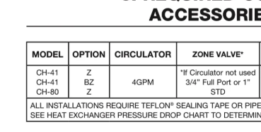

    The 007 is running 2 indirects and 4 heat emitter zone. The manual for the indirect says to use 3 gpm per zone so that is 18 gpm. If I shut two zones off the 007 will keep up.

    The Amtrol chart shows 4 gpm which will heat the tank, but take a bit longer. 4 gpm is with still outperform a standard gas fired tank. 4 gpm through that zone valve and short run of 3/4 pipe is workable.
    I'm not sure what they mean by full port zone valve. A control valve is sized by Cv not pipe or body size. Even at 8 gpm through a 7.5 Cv that is a 2.6' head

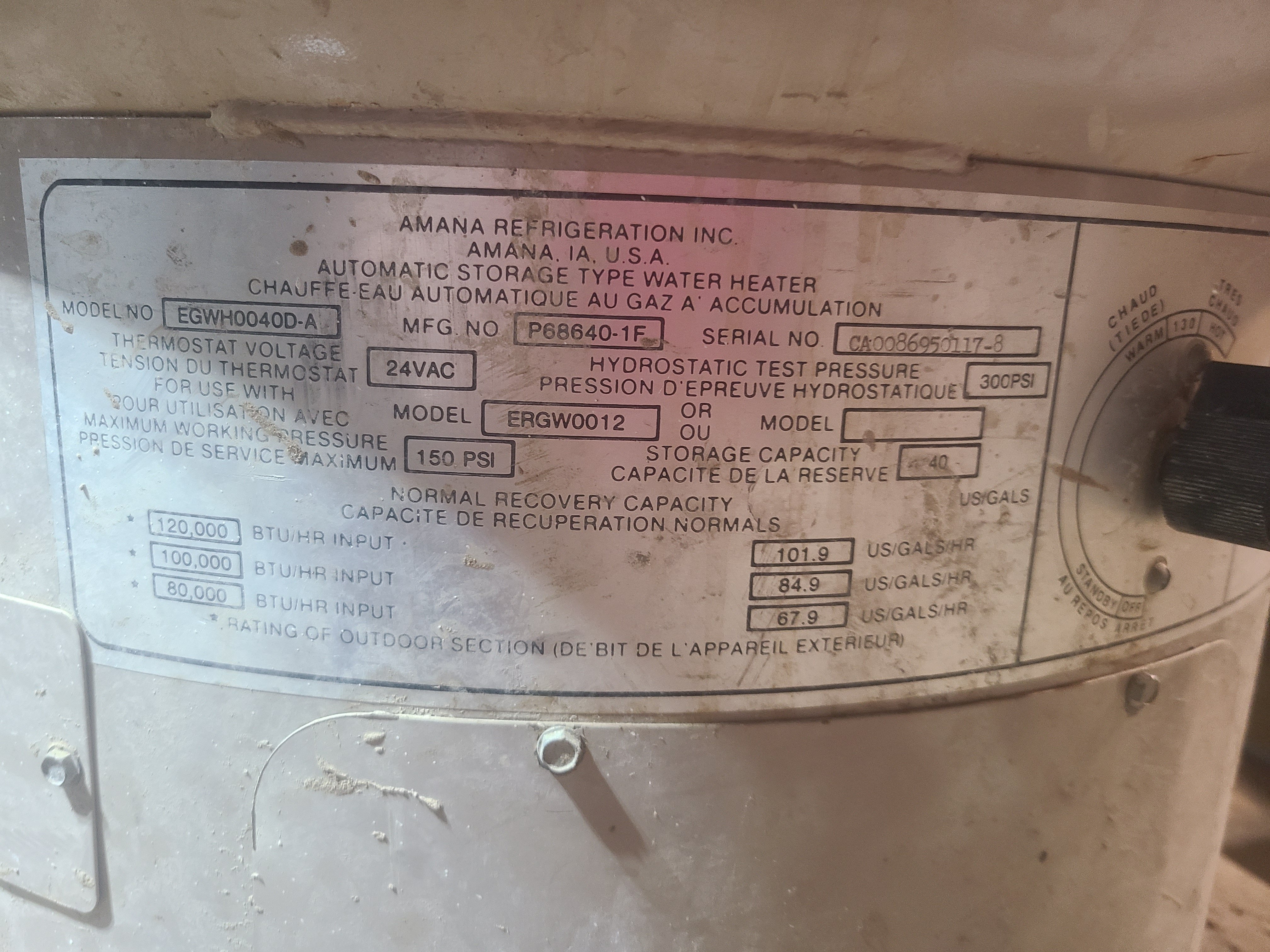

    I'm not sure what the Amana ERGW0012 is? A furnace and AC unit?

    Here's another thread about that Amana unit. In this older thread, the heating module is outside, but one of the commenters says there's also a configuration with the heating module inside, along with the tank. So maybe that's what the OP has here. Maybe previous owner abandoned the heating module in place and just piped the indirect tank to this Burnham.

    In the other discussion I posted, it was paired with tank #EGWH0040B. I think OP took the model # off the old heater instead of off the tank itself.
    Here's a parts diagram with a drawing of the tank:
    https://www.searspartsdirect.com/model/3g11e5apvc-001268/amana-egwh0040da-p68640-1f-heating-cooling-parts

    @Staddy thanks. As we suspected, the EGWH0040D is your tank, and the ERGW0012 was the original heating unit. If you don't have that heating unit now, someone may have abandoned it after it failed and just kept the tank, re-piping it to a different heat source.
