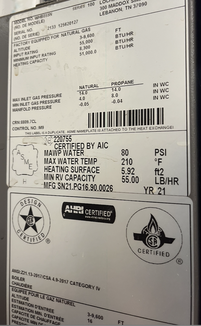

    hot_rod Member Posts: 27,904
    there are some boilers listed to 45 or 60 psi
    Look for the aluminum certification tag fastened to the boiler, it should indicate maximum pressure.

    Thanks Hotrod, yes the pump should run, it's piped for primary secondary, I think it's a malfunction that the boiler is shutting off the pump while firing. The bulb would appear to confirm this.
    If I do replace the boiler I think I will use a 50psi boiler, however I think I've seen on this forum that I need to use an ASME rated expansion tank if I'm running over 30psi? Those are pretty expensive. Not sure if that's true…
    I think the ASME tank requirement would be an inspectors call, or miss.
    I've seen some boilers are rated at 45 psi.
    My small Lochinvar Knight 55,000 shows 80 psi max on the ASME tag!
    On tall buildings the boilers sometimes get located up top,
