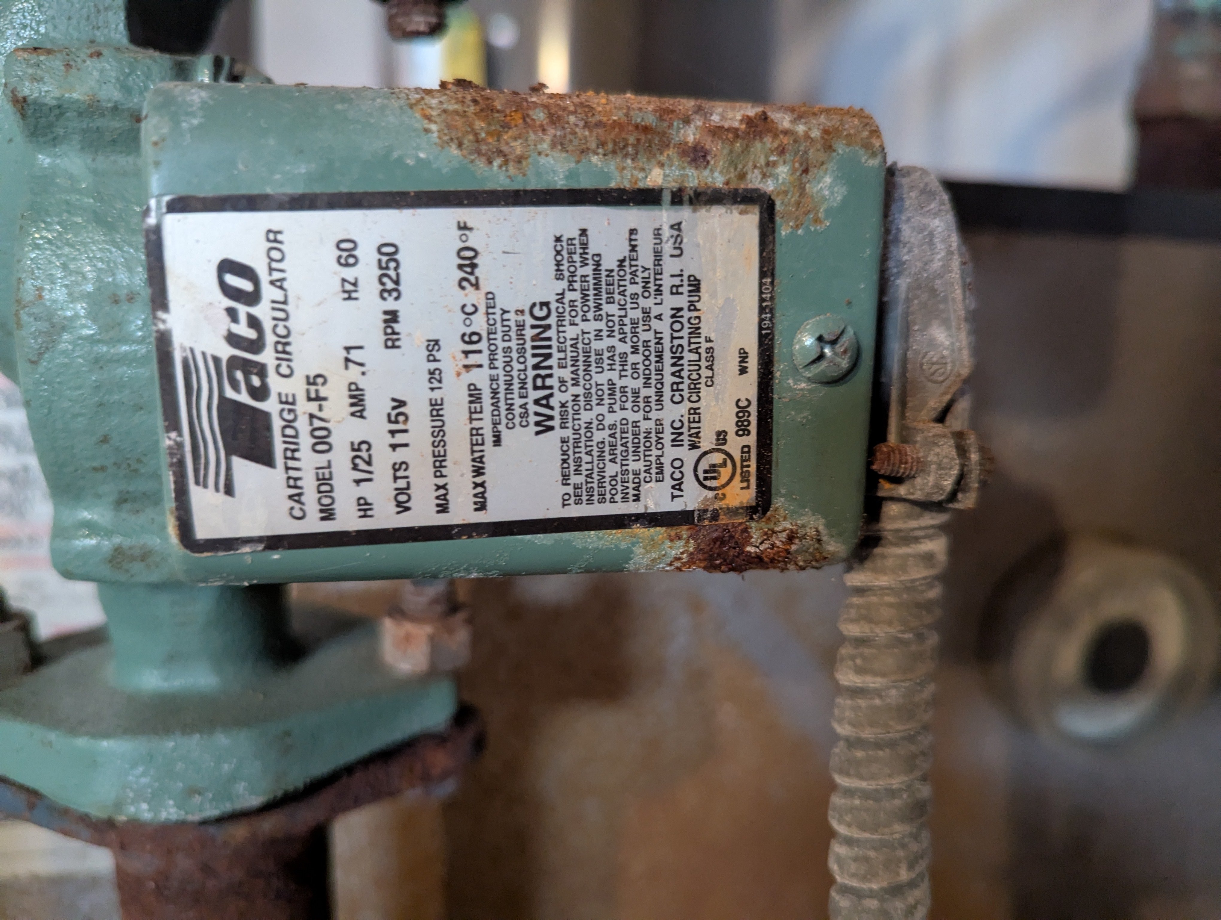

    I'm just back from a second look at the house. There are ~ 51' of upstairs emitter length and 27' downstairs if I found all the baseboards. The boiler is a 75,000 BTU input Utica that was install about 35 years ago. There's a surprising amount of corrosion on most of the valves considering how dry the basement seems to be and always has been. The boiler blipped on for a very short bit while we were there and I can't imagine it ever running hard. I'm especially impressed with the drip catching can that's rusted out;)
    Utica boiler placard.jpg Bottom of boiler.jpg Boiler pump.jpg Boiler drip can.jpg Boiler valves.jpg
    HVACNUT Member Posts: 7,613
    You could stay simple with an upgrade of what you have now. Something like the Weil McLain CGa-25.
    38K net BTU. Still more than you need but you won't find much smaller with an atmospheric gas boiler. I'm not partial to WM. Just an example. The 21st century version of your boiler gets a vent damper, Rollout and Spill switches for safety, and spark ignition. Not a lot to go wrong. Definitely cut all piping high and repipe. It looks like a split return at the boiler. Where does the supply split?
  • Hugh Mason
    Hugh Mason Member Posts: 41
    "Where does the supply split? " In my haste I really didn't look over the pipe routing but would expect it splits between the up and downstairs. Thanks for the advice.
    mattmia2 Member Posts: 17,905
    It would have been less work to fix that packing than to rig up that soup can.

    I'd be more concerned with the frozen valves and leaky air scoop than the boiler.
    If you're only paying $65/mo for both gas and electric, a mod con's additional cost and maintenance will probably never be a break even for you.
    What's you're aquastat set at? 180?

    I agree that the frozen valves and leaky air scoop are troubling and will deal with them. My purchase offer will be considered at 2:00 today and then the real fun may begin. I've never actually seen the utility bills and am relying on the sells word on this. My realtor wasn't helpful in getting actual data. I failed to check what the aquastat is set to.
    If the boiler itself isn't leaking just clean it and fix the leaking piping, no reason to replace it until it leaks.
