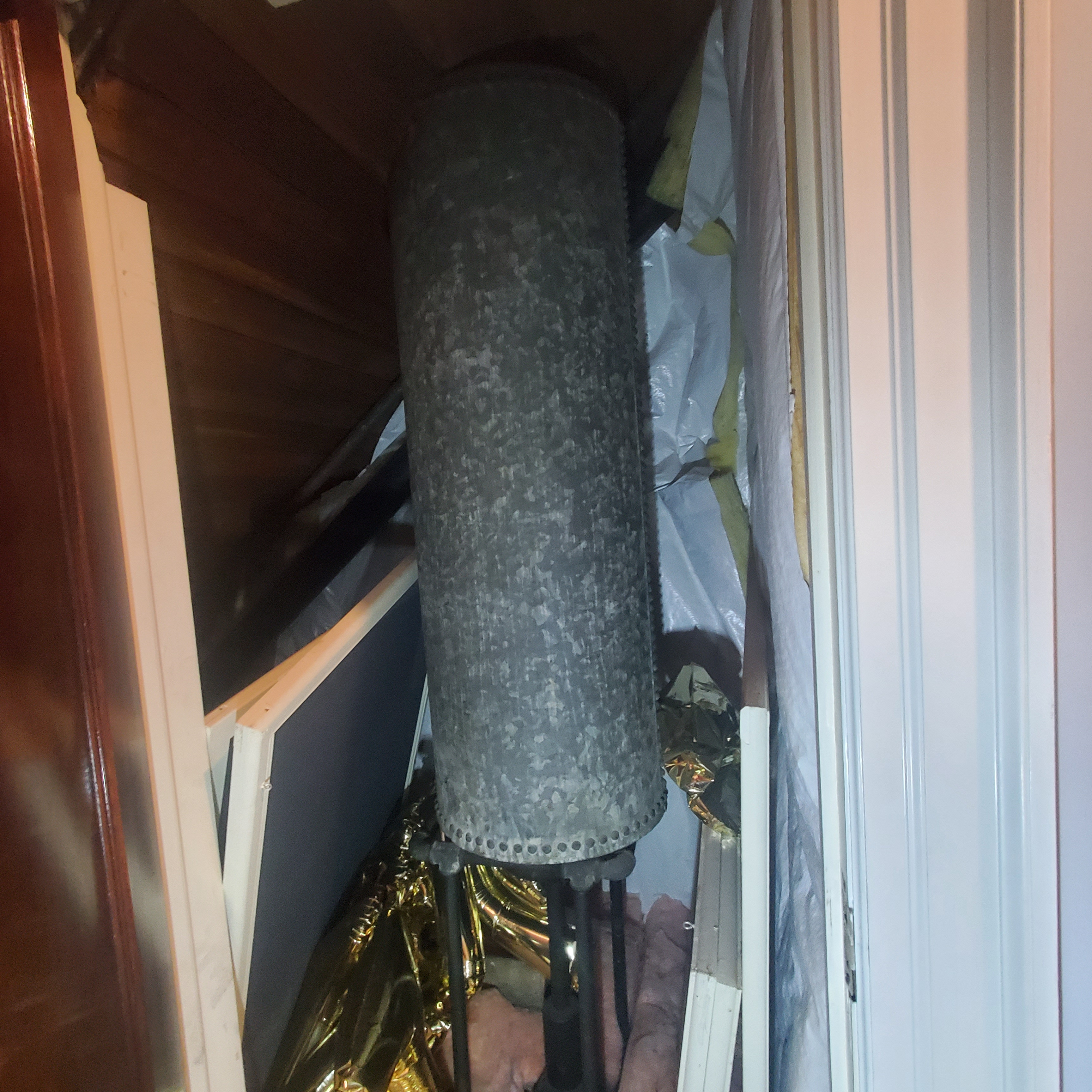

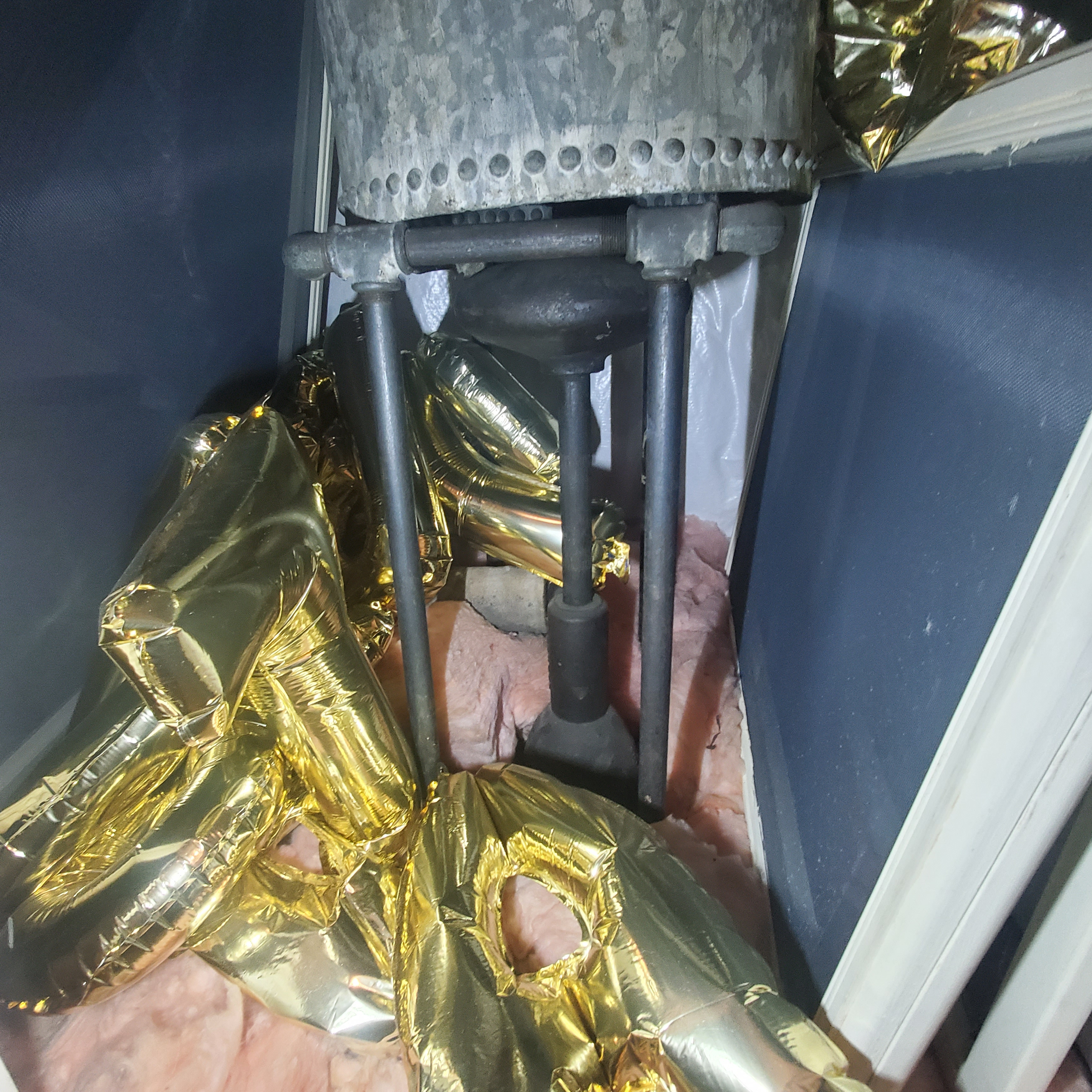

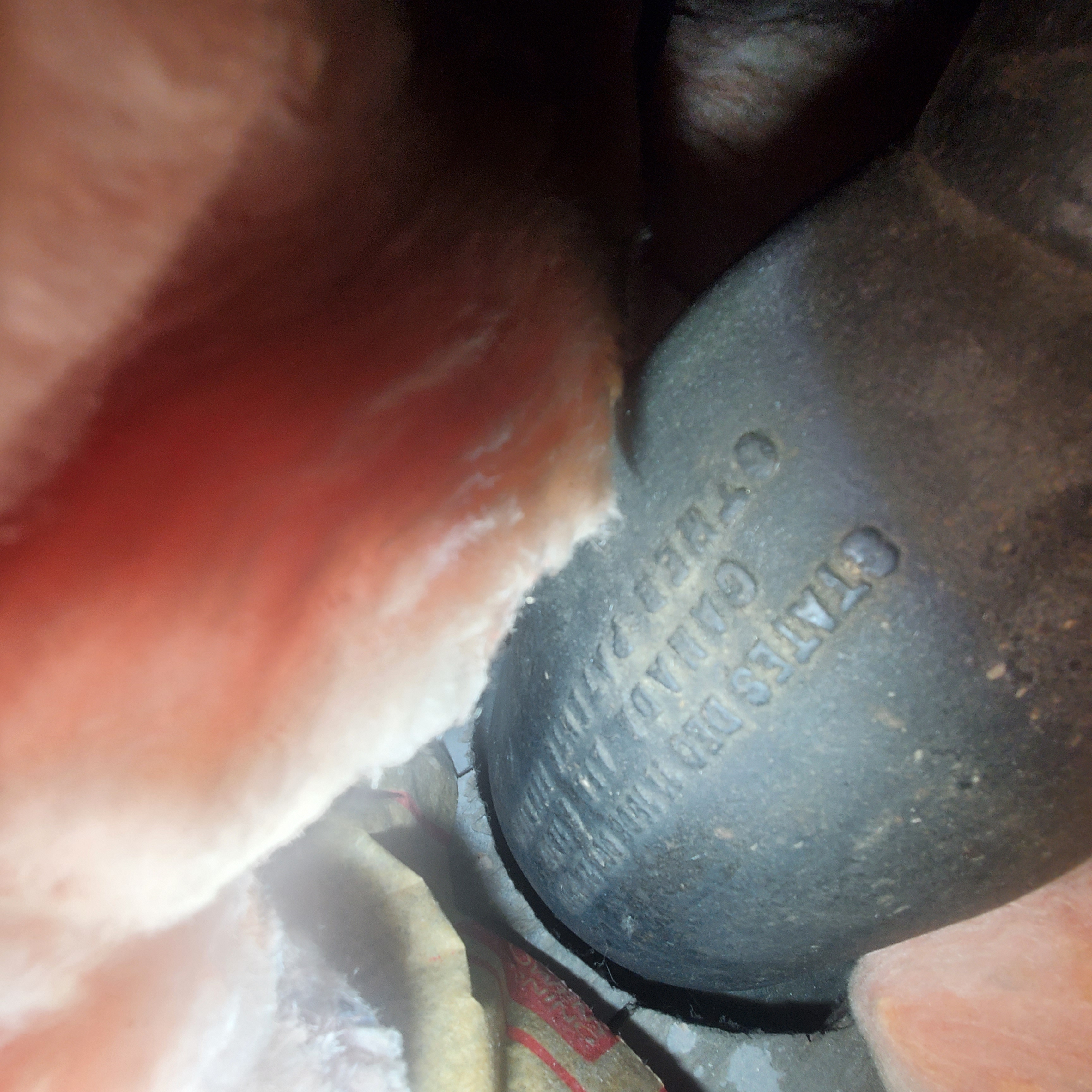

For your viewing pleasure- another Honeywell Heat Generator (No2) found in the wild. This one residing in an attic in South Bend, IN.
A contractor in the past converted system over to expansion tanks. The customer asked me if they need this removed or if its fine. Seeing as ive never removed one, I said its been fine sitting there so far. Thoughts? Any dangers yhr mercury could pose if it's still in the heat generator?
Is it still connected? is there a relief valve at the boiler?
Someone with a gravity system may pay some cake for an intact one. Ebay.
Trying to squeeze the best out of a Weil-McLain JB-5 running a 1912 1 pipe system.0 -
Mine is still active but since this one has already been decommissioned, and in an attic space, I would leave well enough alone. It will not cause any harm. However, if the homeowner does ask you to remove it, make sure not to tip it over or all the mercury inside will spill out and you will have a serious situation on hand. Let the customer know this as well.
If you haven't already, please watch Dan's video on the subject. Send it to the customer to watch as well. Knowledge is power.

Only if you tell.......In this day & age, I'd make the building owner fully aware verbally & in writing of the mercury content & possible hazmat condition. Let THEM get it removed, Professionally by an abatement company. Mad Dog
