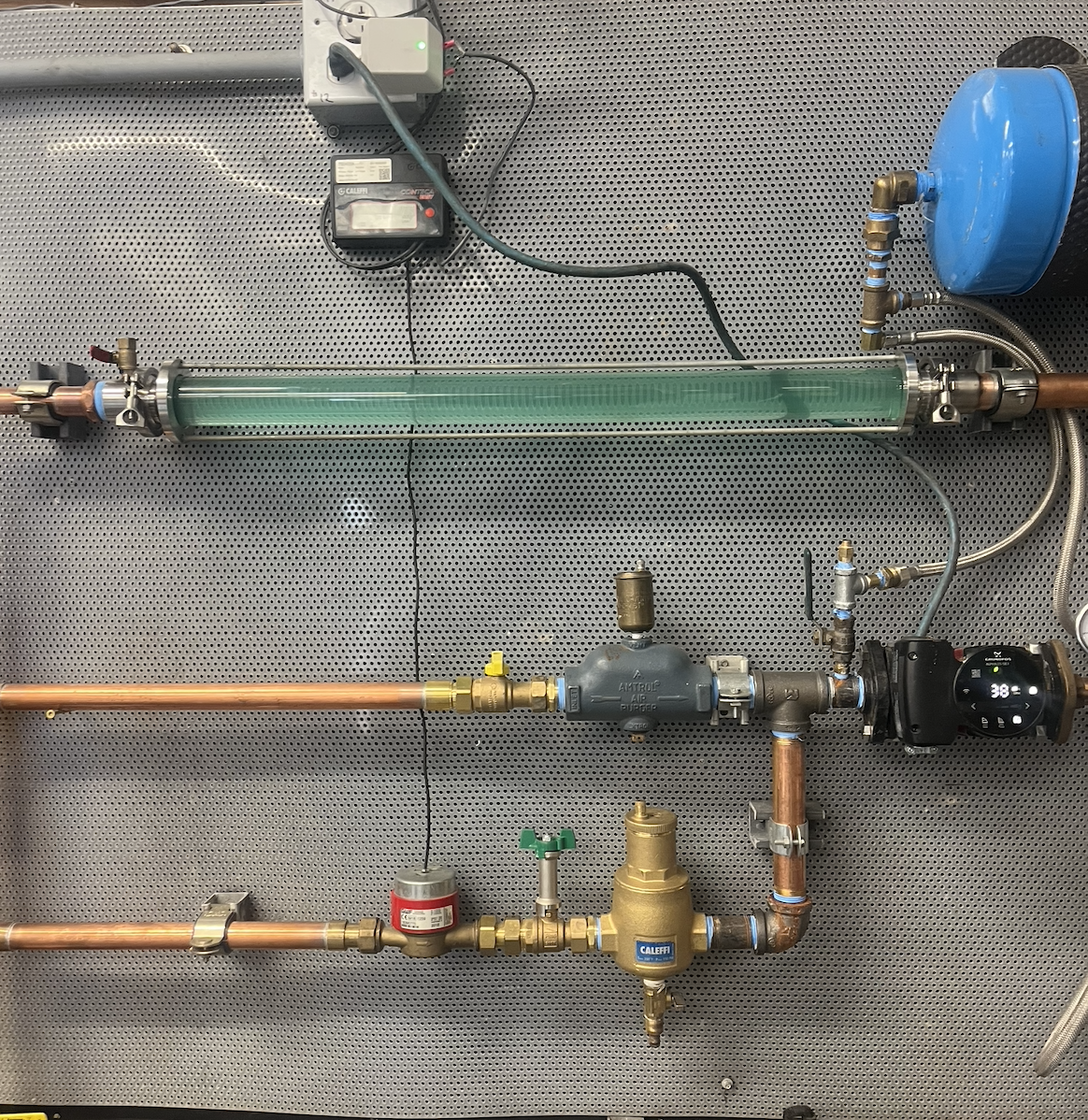

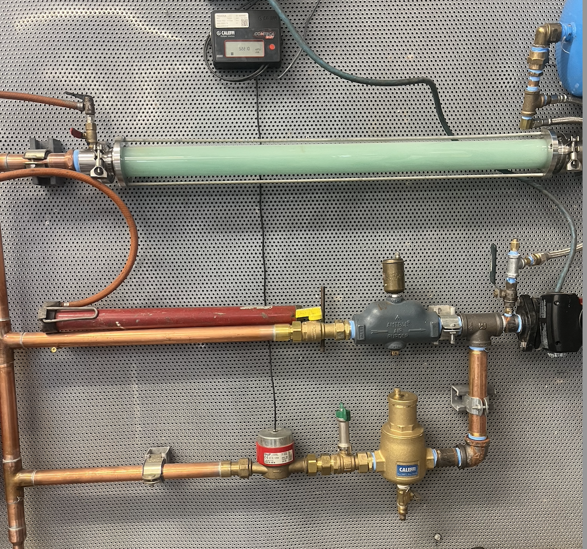

Air elimination demo
I built this demo, 1" copper tube running 8.8 gpm, room temperature.
30- 35% glycol.
I pump 1/2 tube of air from the hand air pump. Run until the fluid turns clear.
The Discal cleared the fluid 100% within 20 minutes.
I switched to the ramp purger, wit 18" upstream piping for best performance. I ran it for an hour and 15 minutes and the fluid is still cloudy, foam.
Switched back to the Discal and same 20 minute result to clear the air microbubbles out.
I'd guess maybe 20% of ramp purgers are properly installed with 18" straight piping upstream, making performance even worse.
I'll try the demo tomorrow with plain tap water for comparison.

    Glycol will always foam especially when pushing the velocity. The air will probably leave the water much quicker.

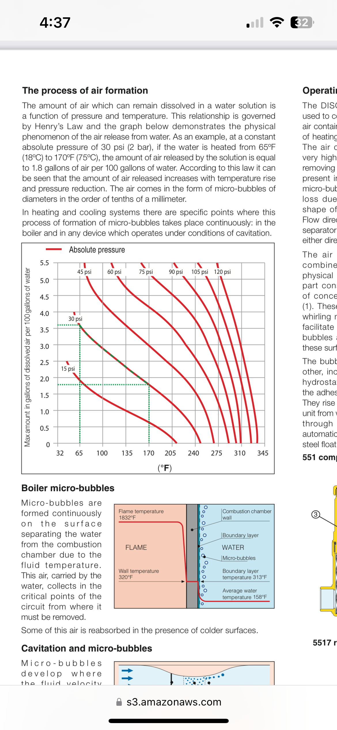

    The Caleffi Discal has a large chamber, the low velocity zone. The bigger the chamber the more you slow the fluid to grab the air. Larger composite media inside. Very easy to disassemble and clean or replace top cap. You can see the needle valve and remove dirt/ rust or teflon tape particles, the two main reasons a vent dribbles.
    I can actually hand tighten these pieces together with the fine thread o-ring seals it holds pressure.
