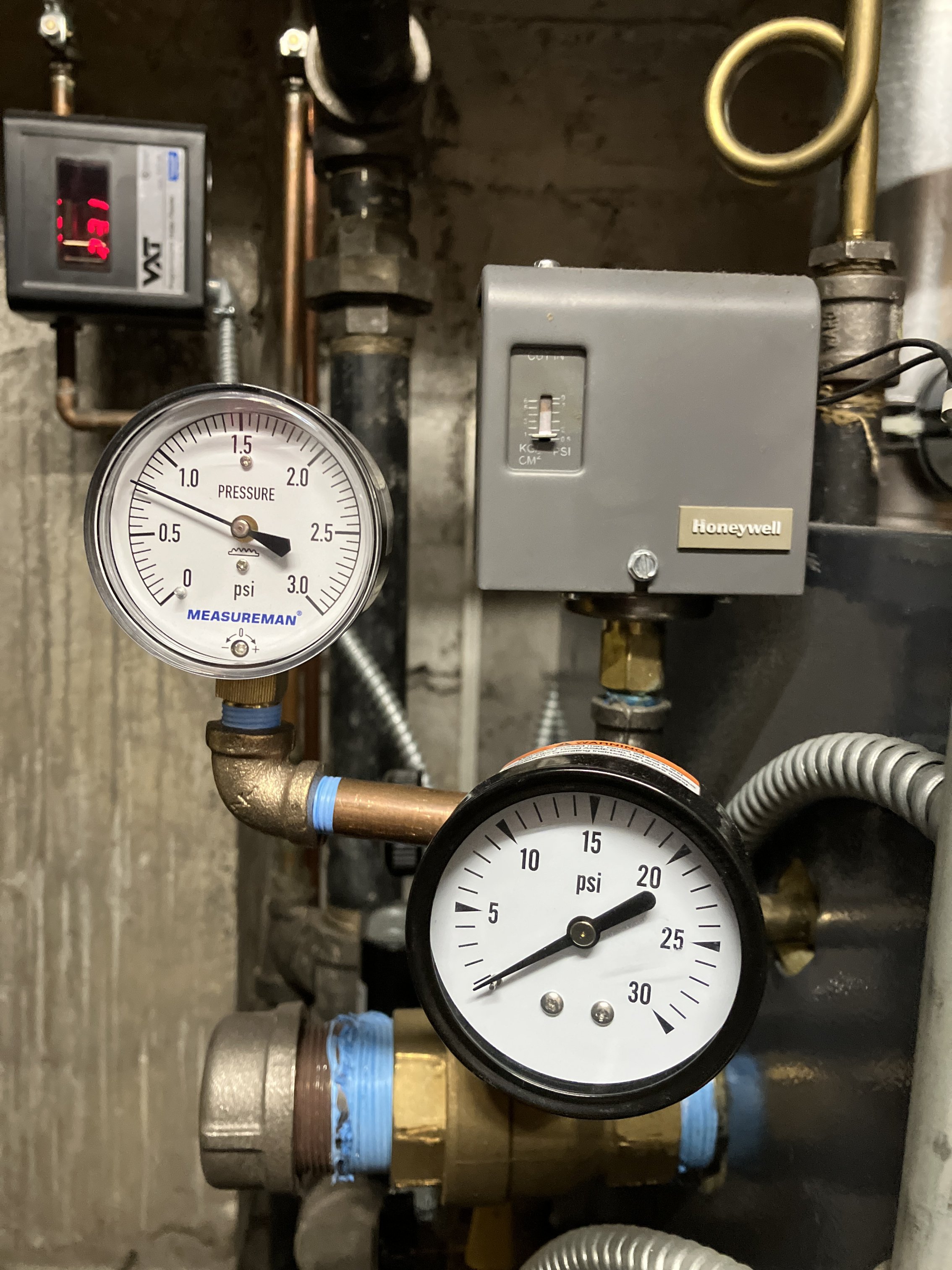

    I finally got the gauge in place and working:
    As predicted, when I turned the screw all the way down it popped out and I had to re-thread it to get the boiler to start again. So that's as low as it will go — and it still didn't trigger at 2 PSI.
    I guess I'll need a vaporstat after all? This would explain why my radiator vents don't last more than a couple of years.

    Did you verify the pig tail clear ??? If it is blocked it does not matter what pressure switch you have on there, it won't work.
    The difference is the pressure range and the maximum pressure.
    With a quick look I'd buy this one  L408J1009, but maybe clean out the pig tail and buy nothing.
    EDIT: Actually if the new gauge is after the pig tail the pigtail is probably clear. I just looked at the other pictures in the thread.

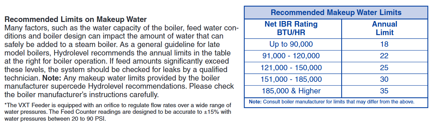

    What number is on that VXT ? Looks like a lot of water.
  • neals
    neals Posts: 66
    It's 231. The first year we went through a lot until I replaced all the vents, tightened leaky valves and connections, then skimmed the boiler. This season started at 223 in November.
    And yes, I cleared the pigtail with a long zip tie when I installed the new gauge. I suppose just the pressuretrol could be clogged, but that seems unlikely, it's at the top of the stack and gravity would be against it.
    109A_5 Posts: 4,759
    8 gallons in a bit over a month still seems excessive.
  • neals
    neals Posts: 66
    Last season it was 28 total from mid-October to mid-May. So yes, this is about double that rate. I am hoping it will calm down, as it did that second year.
