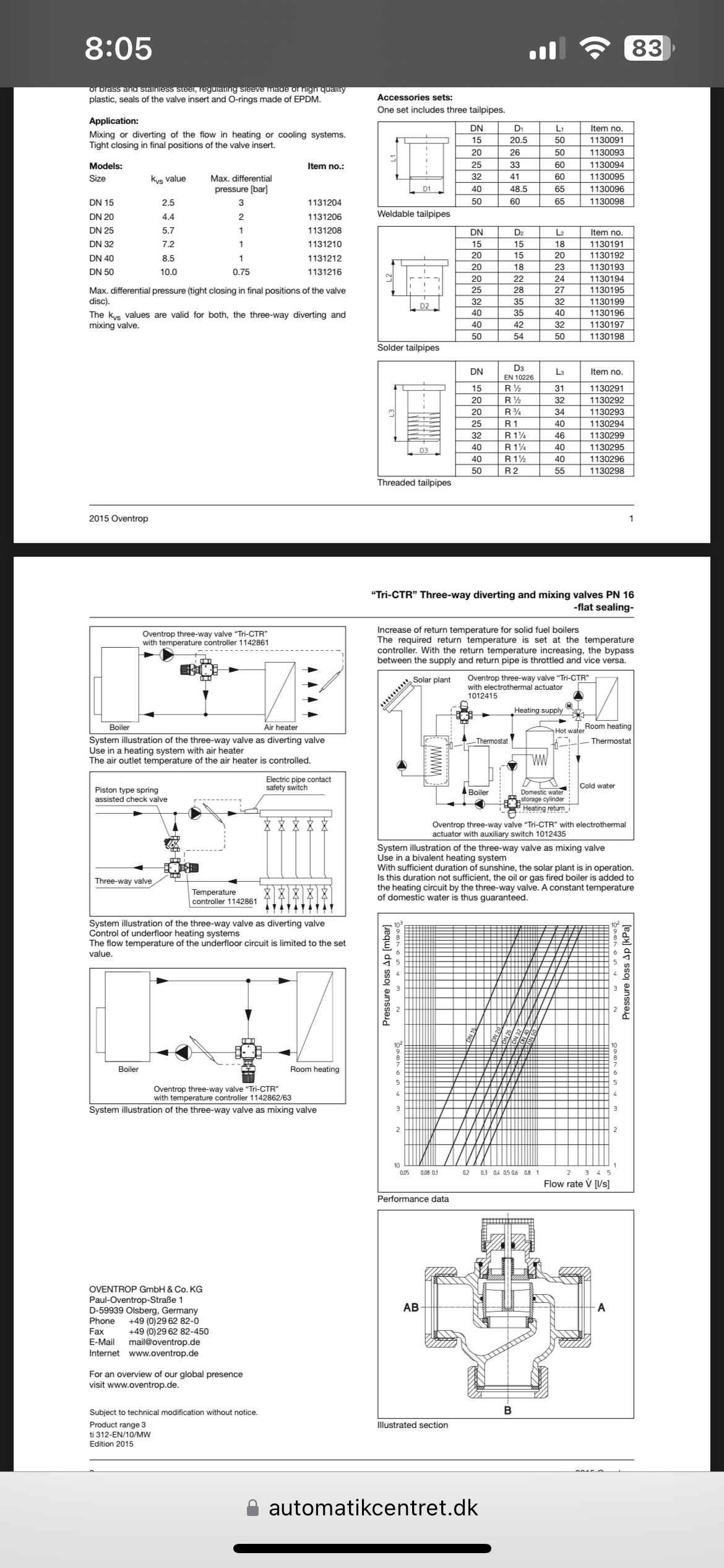

    DN is the pipe size, PN is the pressure rating in bars
    That valve shows up in Oven trop catalog as a 3 way diverting or 3 way mixing valve.
    Most manufacturers have legacy valve data somewhere on their sites.
    Its possible the valve is stuck in one position or the thermal cartridge inside has failed, if it is not regulating properly
    It looks old enough to need some maintenance or rebuilding

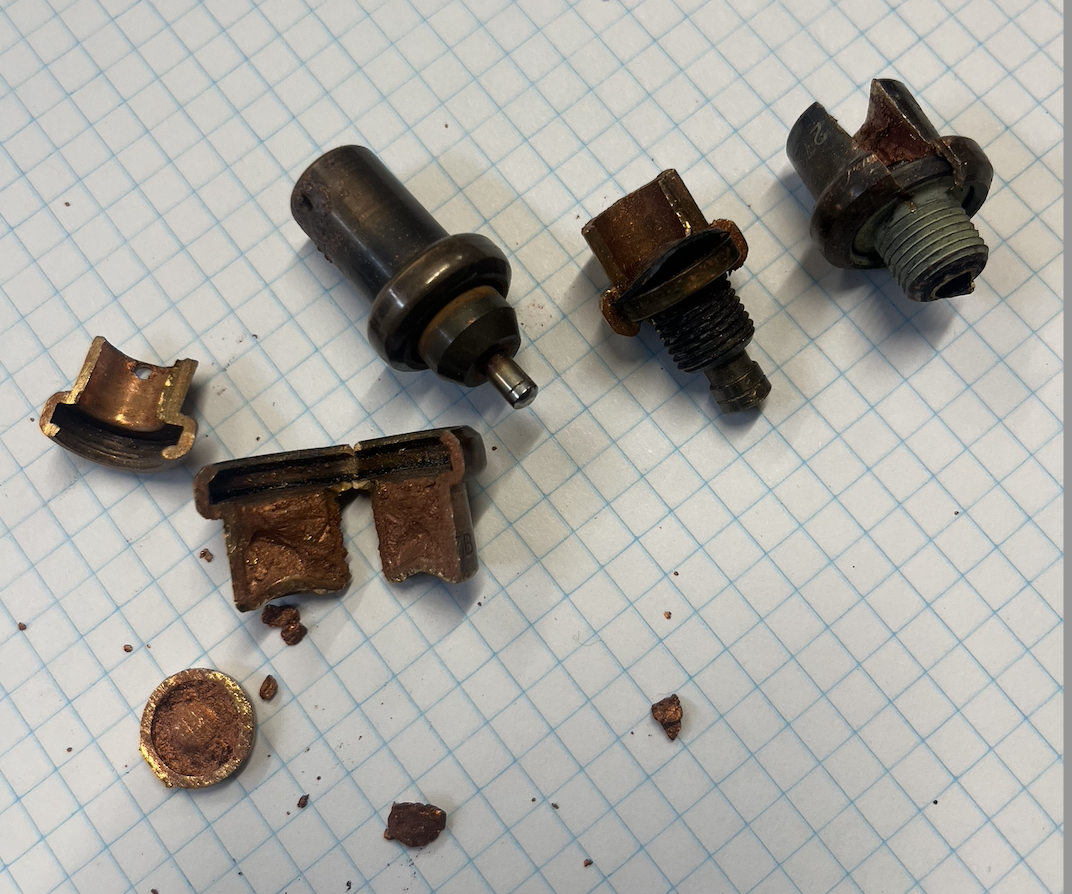

    You do want to be careful checking thermal or oil filled actuators. They want to be attached to the valve when testing with hot or ice water. If you remove it the pin inside the thermal motor may over-stroke and blow apart.
    Here is an example of what is inside some thermal operated valves.
    Basically a copper capsule with a mix of paraffin wax and ground copper. Heat applied causes the wax to warm and expand. A very simple technology.
    On a capillary tube actuator you have there is usually a mineral oil inside the cap end and that small tube, instead of wax. It is not a wire.
    Those small tubes can get pinched or broken.
    So either the capillary tube portion is bad, or the pin inside is stuck from dirty water.

    Oventrop closed down the US operation, you may need to shop the UK sites for parts or just replace the entire valve if parts are obsolete
    The cutaway pic shows the flow path when the actuator is removed, but Im still not clear if it is being used as a mixing valve or diverting, on your system. So, hard to know what happens with the actuator off.
