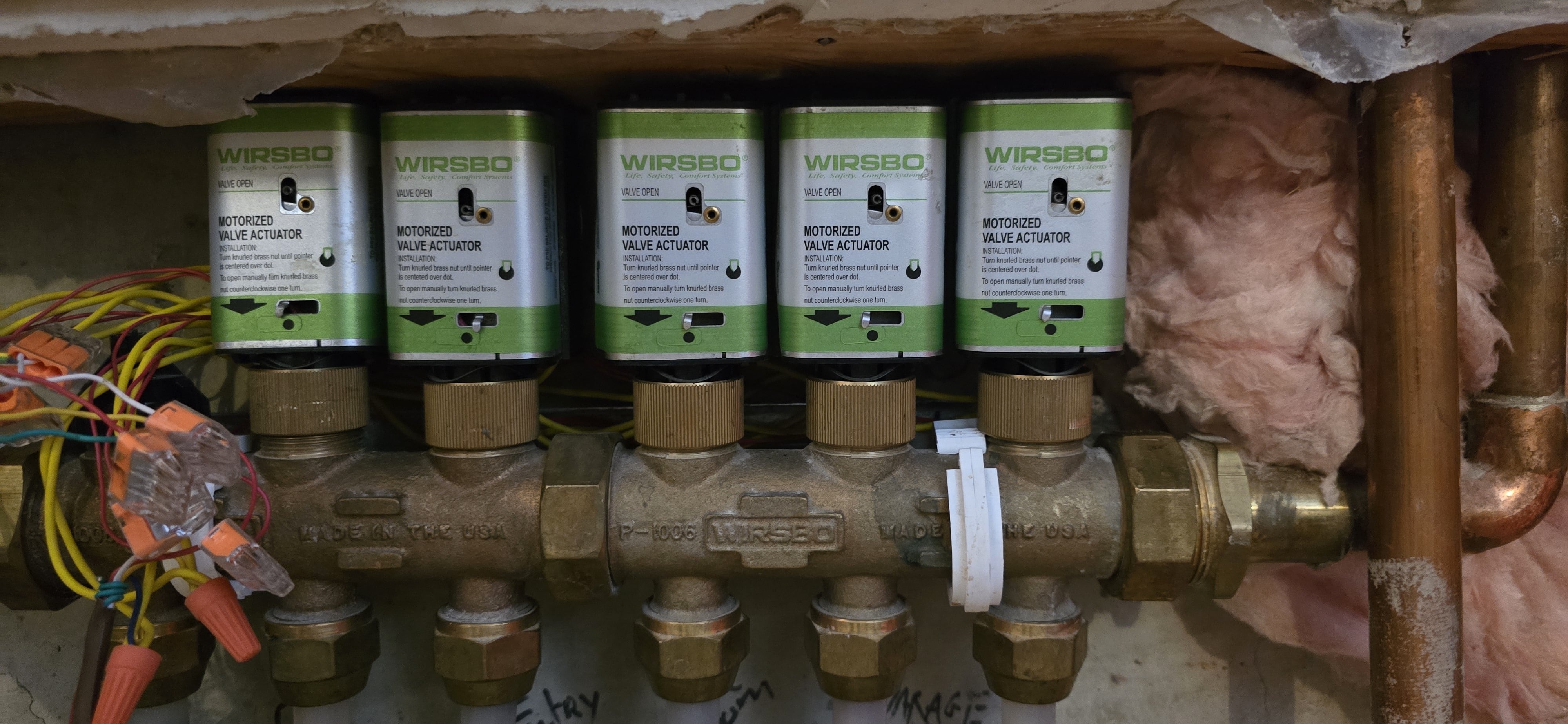

  • Thanks to everyone, Here are more details about my problem.
    None of three thermostats will turn on the Taco Radiant Mixing Block (RMB) circulator. The home is a cabin in the woods constructed with big timbers and masonry and is buried in snow. Parts of the heating system are not accessible. I don’t know where the Zone Valve Actuator Control board, Valve Actuators and Zone Valves for this section are. I do have access to the 24VAC Transformer, three Thermostats, and RBM (used as a circulator only). When I jumper the “Heat Demand” terminals on the RMB to make it run, and set heat “demand” on the thermostats each room (zone) does warm up. Conclusions; The Actuator “End Switches” are not closing when the valve opens, or the Actuators only partially open, or the “End Switch Relay” is broken, or there is a bad wire.
    FOR NOW: I’m looking for a packaged system that uses three 2 wire thermostats (24VAC) or hub that can wirelessly (RF not WI/FI) close and open contacts on the RMB.

    There are zone valves but the end switches (somewhere that you can not access) are not completing a circuit and you want to find a way for the thermostats to continue to operate the zone valves and also operate the pump on the RMB. some with wires other wirelessly.
    That thermostat does not exist.
    The best solution is to get a snow shovel and find the access door to the heating zone valves to correct the problem. If I were a heating professional called to your home to solve this problem, I would tell you that if I can't access all the components, then call me when I can get access. And you owe me for the service visit, especially if I had to use my 4WD for more that 30 minutes, to access your cabin.
    Sorry for the blunt answer. But for the amount of $$$ you would need to create this electrical / electronic / wireless configuration to solve this problem, you could buy a pretty good snow blower

    My thing with the mid level mystery zone valves and zone valve controller is; If they do exist something is powering them either 24 VAC from a local (mystery) transformer or 24 VAC from a known transformer. If it is believed the mystery zone valves and controller are powered the 120 VAC, you could shut of all the 120 VAC circuits and run the RMB independently to prove it. Since theoretically the zone valves would close (unless locked open) and with the RMB running the mid level zone would not heat.
    " I do have access to the mid level thermostats (3), 24VAC transformer, and RMB. Everything else is located in the garage. The only mid level wiring accessible is one seven wire cable. Two wires go to the transformer and two go to the RMB “Heat Demand” terminals. The remaining three wires are not connected. The cable disappears into a hole in the plywood heater mounting board. "
    This sounds like there is three zone valves (maybe not a controller) for the mid level. The thermostat that is calling activates the zone valve and the zone valve end switch activates the RMB. The three end switches should be wired in parallel. So with any call of any one of the three thermostats the RMB is activated. I suspect the seven wire cable goes somewhere, I'd find the other end.
    If you truly believe the zone valves and maybe a controller exist using a borescope (not that expensive anymore) and some educated guesses I would find the equipment and build an excess cover so the problem is not passed on to the next owner.

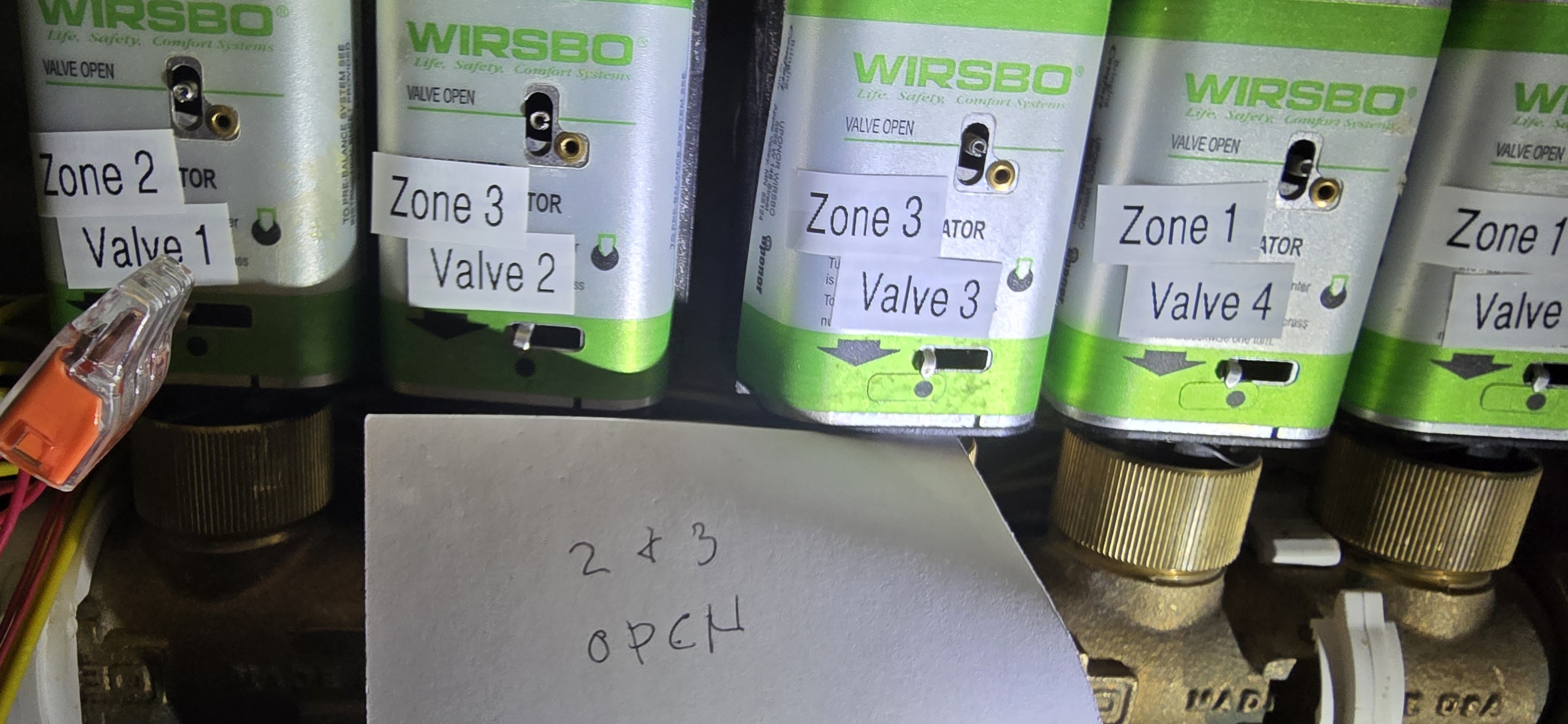

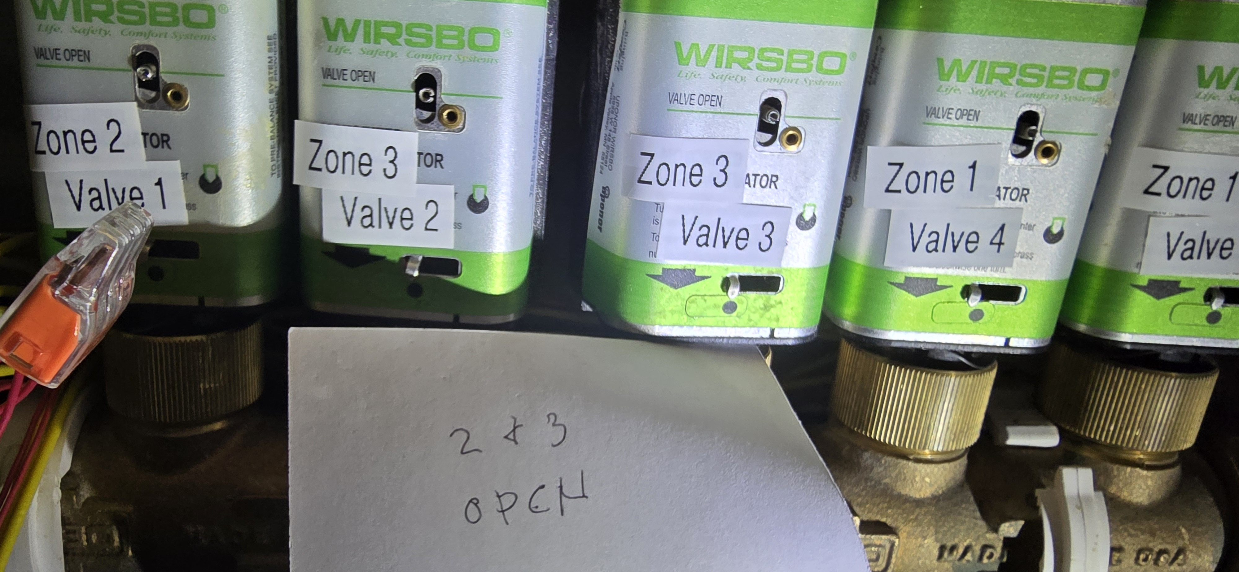

    109A_5 Posts: 4,759
    The zone valve actuators that don't operate the end switches correctly, are they installed correctly ? The indicators seem all over the place, and I don't know if any are energized when the picture was taken.
    Billiambob
  • Hello
    All of the valve actuators were energized to open. (Note: I tried to open them manually and forgot to retighten the actuator on the left.). I was told that originally everything worked “at one time” but that was from many years ago. The up/down indicators barely move, if at all. The Pin Valves do operate because I can hear and feel hot water flowing. The alignment dot moves a little when you turn the knob but not enough to line it up. I need to replace these actuators and the other hidden ones, (ten total) with Uponor Blue Thermal Actuators. Unfortunately per other posts above the Uponor actuator adapter (VA33) will not work on these old brass Wisbro manifolds. If this is true I won’t be able to change out manifolds until spring. For now I’m looking for a work around to wirelessly run the RMB.
    Thanks
    Bill
    hot_rod Posts: 28,699
    if you remove all the actuators, the ports should be open. Then you just need to signal the RMB on
    Those actuators just hand tighten until the indicator is engaged and moves to the dot
