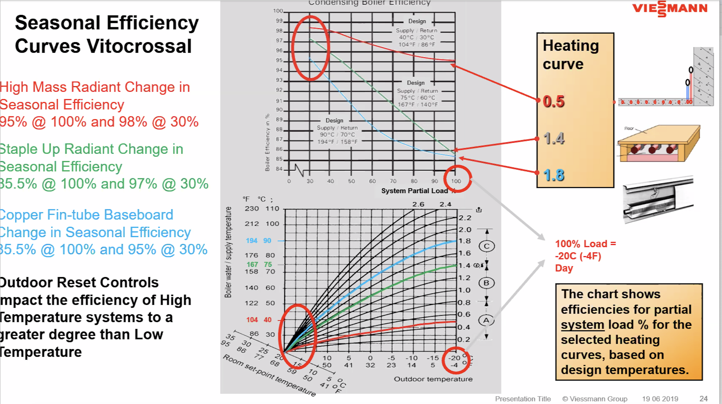

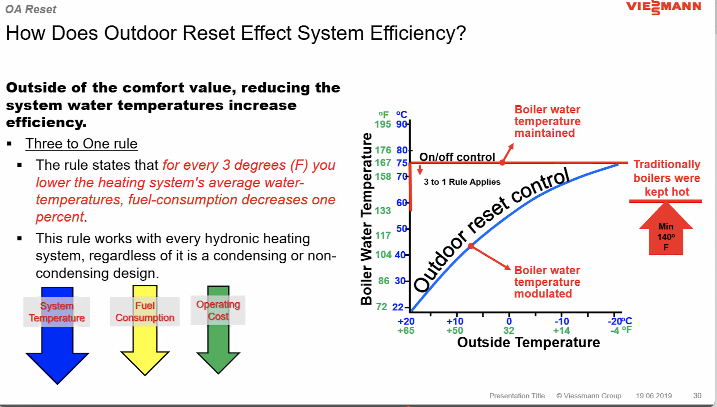

Generally, a supply temperature of 180°F is only need at design conditions. Lower temperature can and are used during warmer weather. Outdoor resets 256 - tekmar. With cast iron boilers 130° return temp is about minimum to prevent condensing in the exhaust gases.
2 -
A control that modulates the boiler temperature can save fuel and provide comfort. The boiler should only run full temperature on the coldest or highest load days.
Living the hydronic dream0 -
the not going so low that the boiler condenses is important. without doing some math or measurements you probably don't want to go below 150f.
lower boiler temps will make it run longer cycles and be more even. It is unlikely to have a significant effect on efficiency. not oversizing the boiler, sizing it to the heat loss of the structure is what will keep it from cycling or getting hotter than it needs to.
though it is possibly if they designed for 170 awt and got the sizing of the emitters pretty close to the actual heat loss, it is rather unlikely that 150 f vs 180f swt is going to make the difference between if it heats adequately at design conditions or not but lowering it 30 f degrees also probably has little benefit with a cast iron boiler and fin tube baseboard.
