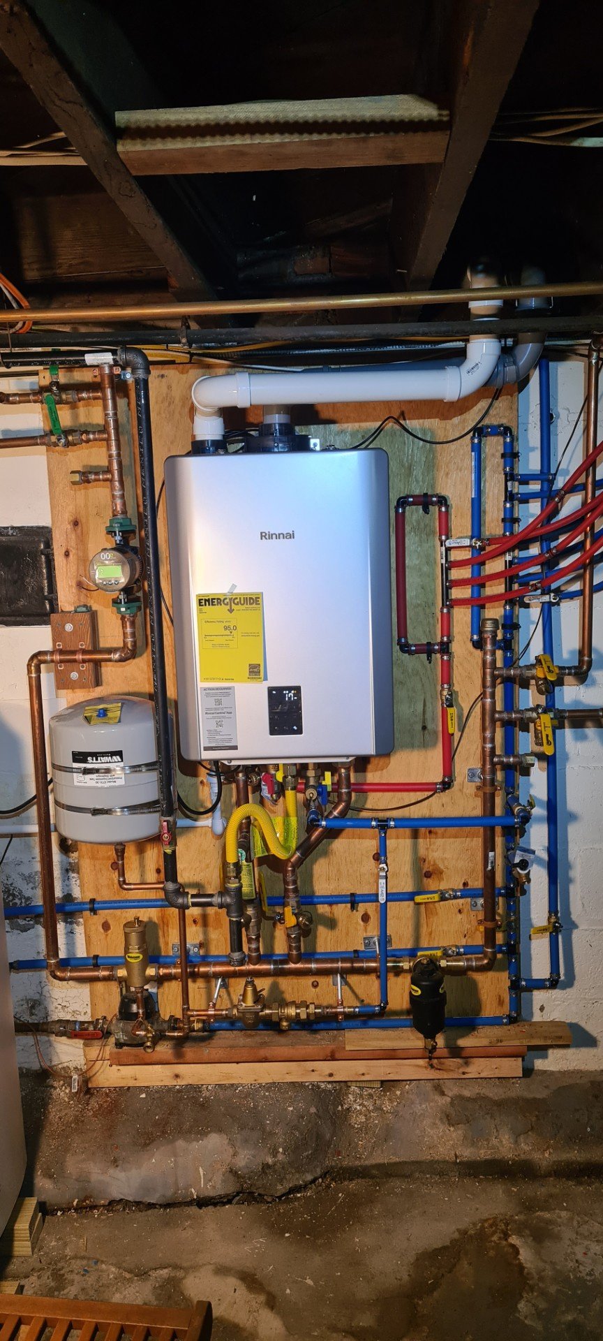

    So I finally finished the majority of my combi install and I wanted to post an update. DHW has been working well the last month and my gas usage appears half of what is was compared to the same summer month last year. The delay in hot water at the tap seems only a few seconds longer than the with the old gas fired storage tank. Im just finishing the CH piping lines to complete the piping loops with Oxygen barrier pex as it seems much easier to work with compared to the 3/4 copper.
    Thank you to everyone who commented in my previous posts. I'll give an update on the fuel savings with the new unit when the cold weather comes.

    Piping looks good.
    The only thing I don't care for is the flex gas line connector. If it was me I would drop the tee lower so the flex has a straighter run with gradual bends. Like 2 45s. JMHO
    DIY_ProRich_49

    Thanks for your feedback on my system Ed. I'll take the advice and lower the gas flex. It took me a long time to get it all assembled and working. I have a new appreciation for HVAC/plumbing trades after this project.....
  • Very, very nice. That's the straightest PEX installation I've ever seen.
    I would have liked a ball valve on the 1/2" line coming out the bottom of the air eliminator so you can isolate both the x-tank and fill valve without draining the system when they need service.

    rick in Alaska Posts: 1,533
    And in the future you will wish you had put isolation valves on the circulation pump. You do have valves above it, so at least that is covered, but another one is needed below it. Makes changing out the put faster.
    The rest looks good though.

    Billing update.
    So my DHW bill with the new combi for the month of Aug was 70% lower than the same month last year when i was on my old tank system.
    hot_rodGGross
  • Nice! Now insulate those pipes before the cold season starts.
