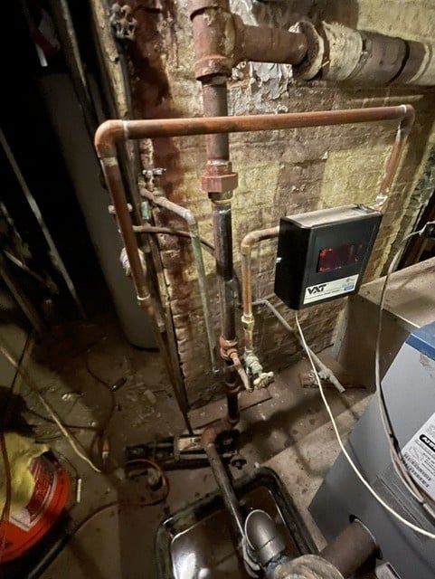

    can you post pictures of the near boiler piping?

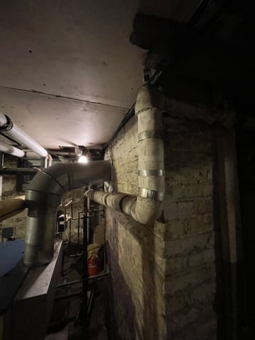

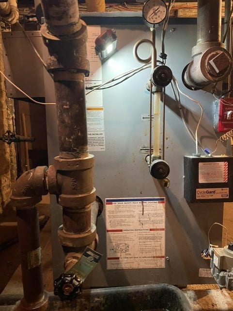

  • RNC
    RNC Posts: 9

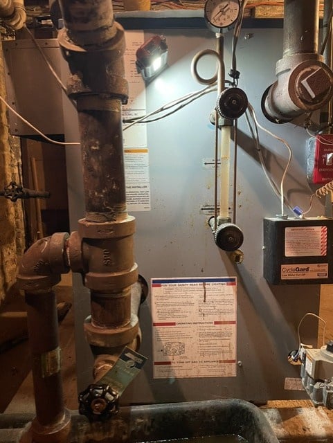

    IMG_7946.jpeg IMG_7947.jpeg IMG_7950.jpeg IMG_7949.jpeg IMG_7955.jpeg IMG_7959.jpeg IMG_7953.jpeg IMG_7958.jpeg IMG_7961.jpeg
    this was he boiler as its presently set up. I just recently repacked all the radiator valves in the house and replace all steam vents. I’m not losing water. The water feeder has not replaced any water since then. I will take clammy advice and use a wand and clean out each heat exchanger. When I first started this chat the boiler had just been cleaned and water was clear but as the picture shows the water has rust in it again. I will get those studies done and have the gas company come a check the gas flow to the boiler. The pressuretrol is on the lowest setting

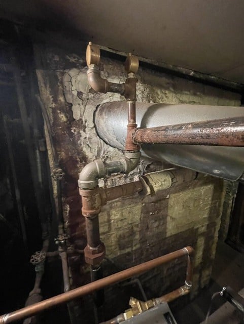

  • RNC
    RNC Posts: 9
    The naked long pipe is the return line that I lowered to increase the pitch

    A couple of quick thoughts. First, that "naked long pipe" in you pictures is not, repeat NOT, a dry return. It is a steam main extension. Where are your steam main vents? It would be best if they were just beyond the last radiator takeoff, but in any event that pipe should be insulated.
    Second, if your measurements are reasonably correct, your boiler is half again as big as you need — and that surely is not helping. Unhappily there is not good way to downfire it to close to what you need.
    And last, it is not clear from the pictures whether you used both side outlets of that boiler…

    I am going to jump in here with some observations and thoughts. But first, you refer your calculations for the size of boiler you need according to your calculations, does that number include the piping and pickup allowance? If not, you would add 34%. Some recommendation say 50% (TLAOSH). I don't recommend that high of an allowance, but many boilers are installed in that condition and that does not push water out of the boiler.
    Your reasoning that the steam is going out of the boiler so fast that it is pulling water with it…. NO! That is not happening and it makes no sense.
    1st, I would suggest that you look very closely at the installation instructions for your boiler. It is going to say exactly what size of pipe the two risers should be and also the size of the header, equalizer, and so forth.
    2nd. Check the elevation of the Hartford loop. It should be a little below the normal water level, but not so low that the water disappears from the sight glass. The manual will say exactly what it should be.
    3rd. I notice that the connections from the header to each of the two building mains go through a reducing coupling, through several fittings, and then back to the full size of the main via a reducing 90. This is very bad because it restricts the steam flow.
    I suspect you have a combination of piping errors that when the boiler is firing restricts the flow of steam, raising the pressure in the boiler just enough to cause condensate to back up in the return, or even to push boiler water out of the return port. The equalizer should assist with that, but there the Hartford should be at the right height, and most of all, you need to let the steam get out of the boiler without restrictions. 1 psi pressure in the boiler is enough to cause the condensate to back up 27" at the back end.
    Best of luck in getting this straightened out.

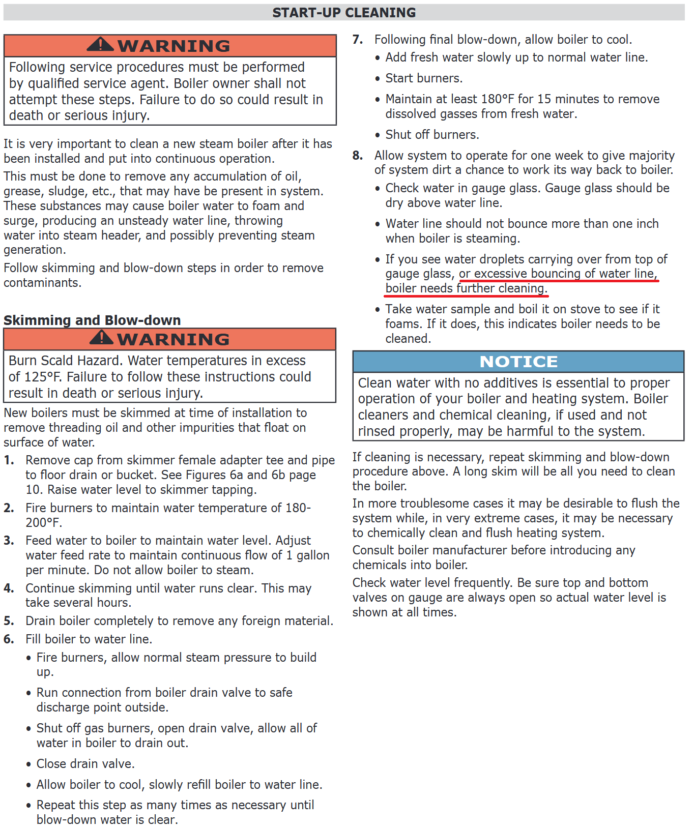

    An oversized boiler working properly should just build pressure and the Pressuretrol should limit the pressure by shutting down the burner. It should NOT puke its water into the system piping.
    Your boiler puking its water into the system piping is typically because of contaminated water, often oil.
    If your boiler is puking its water into the system piping, wanding it only once may not be enough, since the Puking action forces the oil up into the system pipes, to slowly return to the boiler and cause problems.
    Have you (or anyone) skimmed it ever ? If not why not ?
    The manual states this.

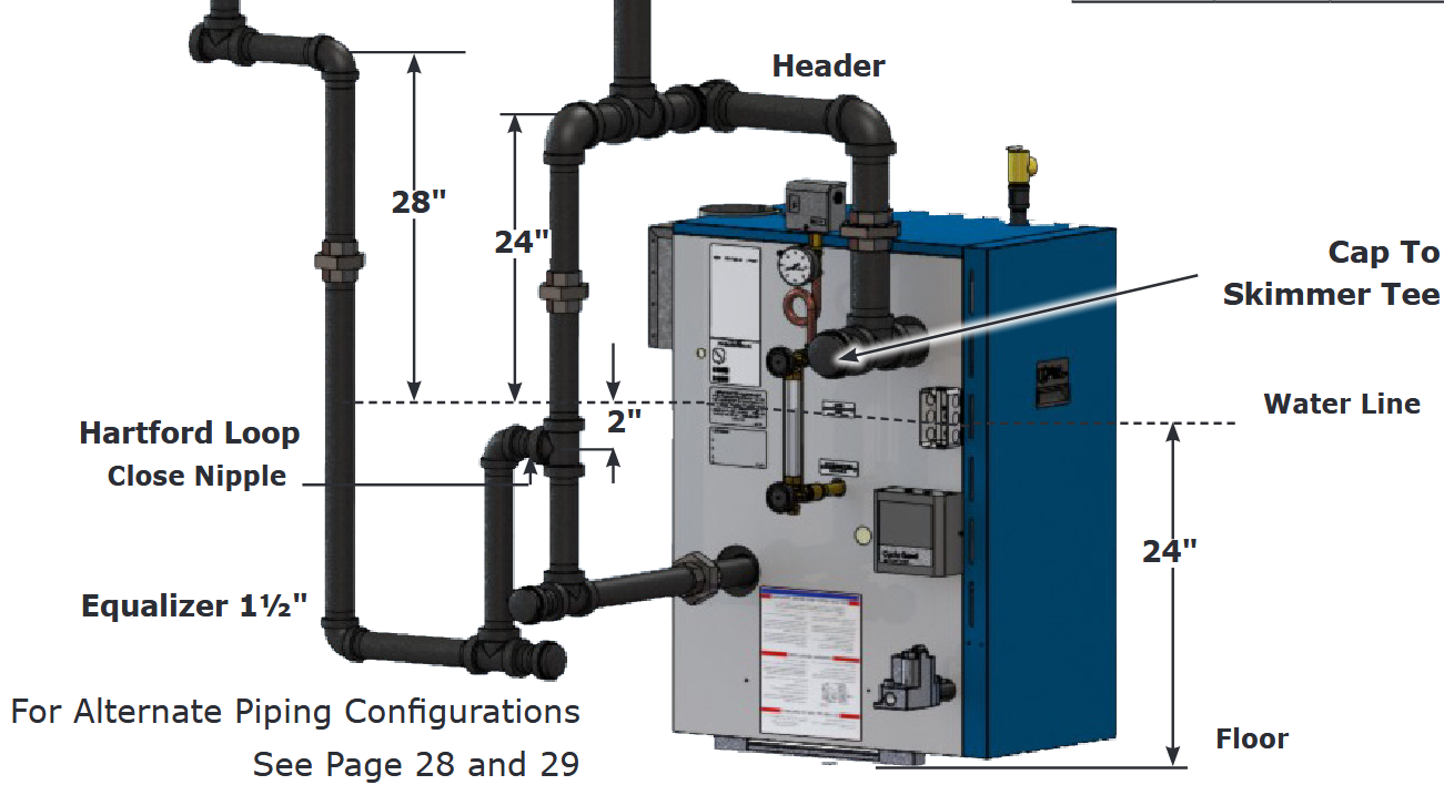

    Steamhead Posts: 19,007
    edited September 16
    Those model numbers used to be longer. Here's the piping diagram. @RNC , your boiler is the 9-section model:

    Is your Hartford loop within 2" of the normal water line, or 24" from the base of the boiler per the piping diagram @Steamhead attached? Based on the angle of the picture it looks to be much lower.
    Your boiler is rated for 782 sq.ft. of steam. What is the total EDR of all of the radiators in the building? A pickup factor is already included in the boilers 782 sq.ft. rating so no need to add more. The pickup factor is to account for uninsulated pipes.
    As for the uninsulated pipes….this should not contribute to your problem. All it will do is take the steam longer to get to the radiators as it takes more time to heat up the mains. This can use some more fuel…but with the benefit of a warmer basement which may be desirable.
    I have a single family home and a much smaller boiler….but it is still about 75% oversized. Single pipe counterflow steam. It is clean as a whistle and the water in the site glass only bounces +/- 0.25" when running.
    The only time I've had water puke out of the boiler was when I first bought the house and the water was nasty. Even after cleaning it got dirty again and would start surging in a few weeks. It took some time and many drain/fills to clean it out.
    I've since been using Rectorseal 8-Way and the boiler stays crystal clean. Never an issue since.
    I'm asking the people that know way more about steam than I do, but if the hartford loop is too low, since the returns are overhead, where exactly is the water going to go?
    As long as the returns drop to near the floor and then rise to the Hartford Loop, there shouldn't be an operational issue. But if the return breaks and the low-water cutoff doesn't stop the burner, enough water could leave the boiler to cause it to crack.

  • RNC
    RNC Posts: 9
    @ Admiral Yoda, its ironic that you asked about the height of the Hartford loop. prior to reading your post i was tending to the boiler last night and i noticed that the Hartford loop is too low. im going to post the pictures.
    109A_5 Posts: 4,759
    edited October 6
    Can't 100% tell due to the camera angle and it is out from the boiler a ways but it does not seem excessively low. Use a level to get a better measurement. Probably not the issue.

    The LWCO probe looks to be below what looks to be the "Lowest Permissible Water Level" label (near the bottom of the sight glass). And the Hartford connection look appears to be above that.
    The boiler should calmly boil water like a tea kettle on a stove. If the water is leaving the boiler abruptly the common cause is oil or some kind of contamination in the boiler's water.
    Can a picture be taken with the camera level (not looking down) and at the same level as the Tee that connects the Hartford loop to the equalizer pipe. The Hartford loop may not be at the prefect level per the manual but I don't think it is causing the water level issue.
    The boiler probably needs skimming and multiple times if it has been puking its water and oil up into the system.
