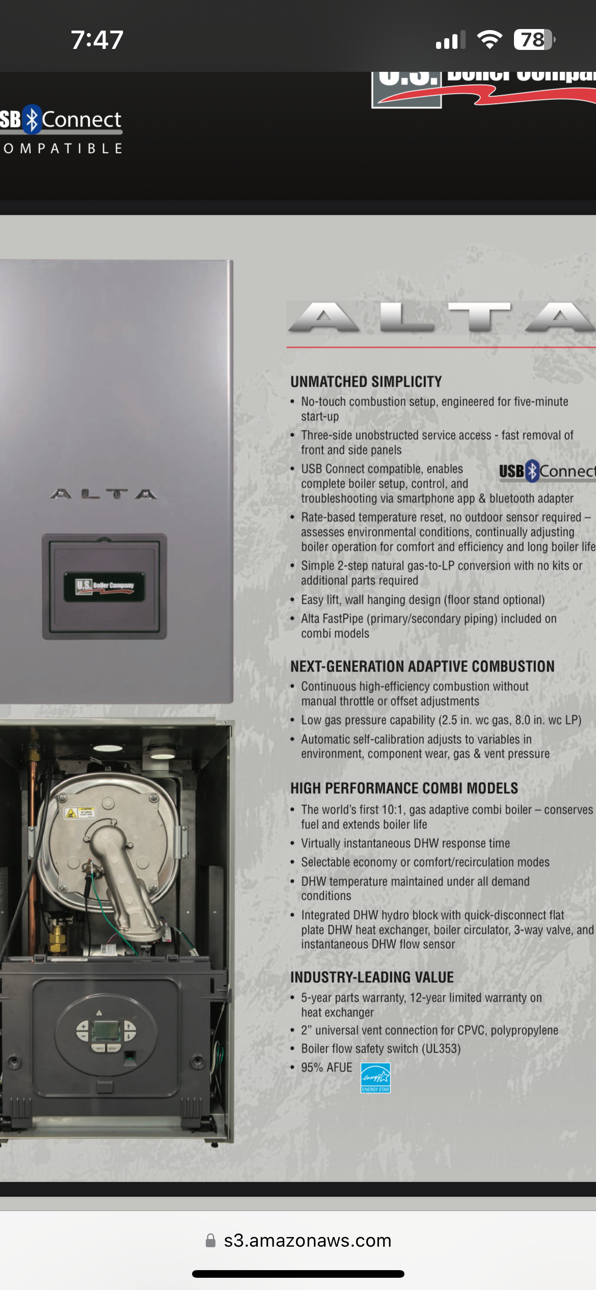

    Jamie Hall Posts: 27,907
    All this is fascinating… you would think that there would be a mass airflow sensor controlling the gas flow… apparently not? I'll grant that they aren't really cheap — a few hundred for OEM ones (don't use anything else!) but… there aren't all that many gasoline powered cars out there today that don't use them!
    hot_rod Posts: 28,529
    Burnham and Viessmann have boilers with adaptive gas valve control, maybe with more sophisticated gas valve control ?
