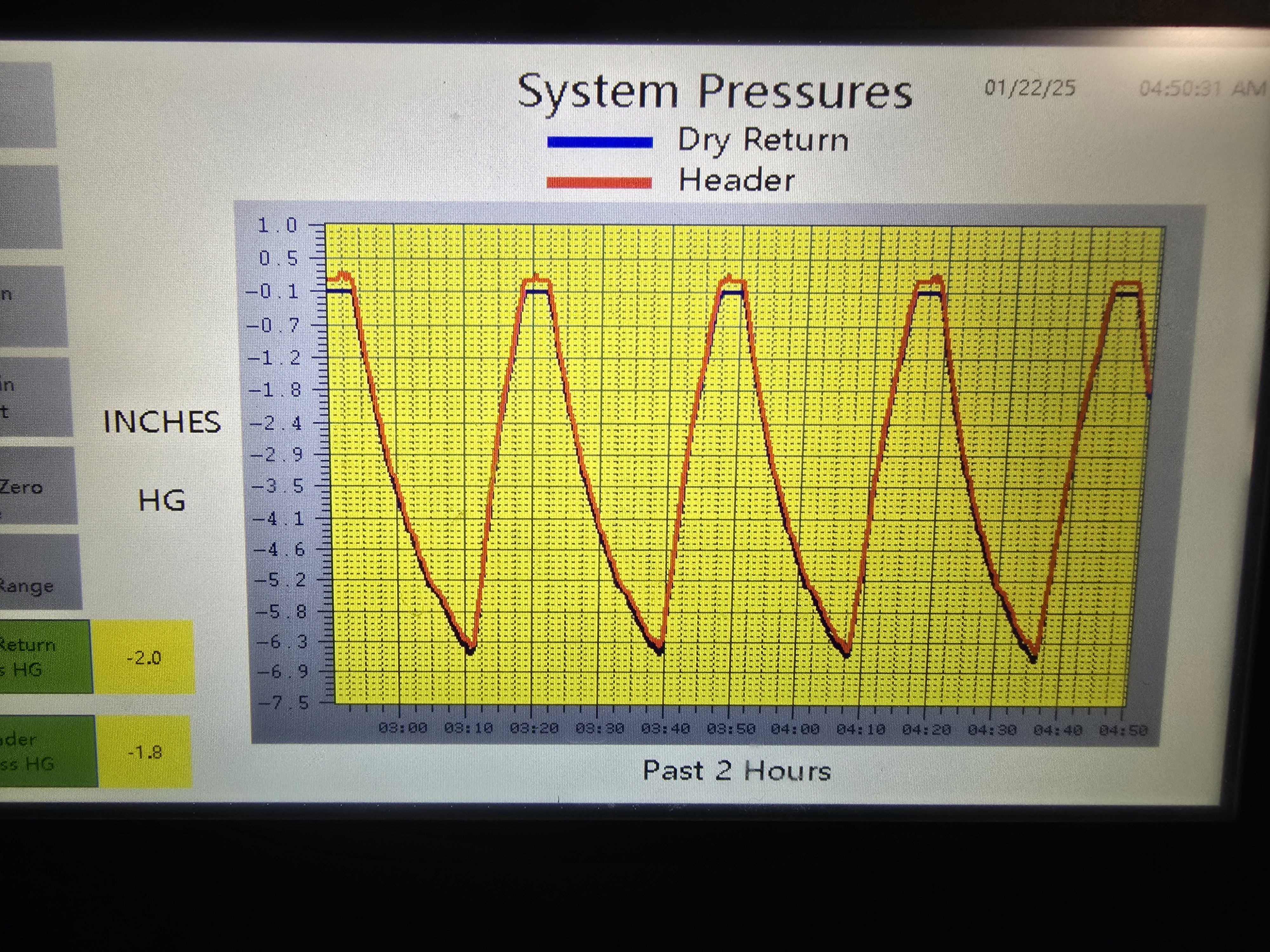

    No argument there @ethicalpaul . .22psi would be way different than 2.2psi with regard to everything including overshoot. For sure calling for a stop and wait at .22 is way better than doing nothing.
    I attach in case you are interested a plot of my system pressures at around zero degrees outside cycling right around 2 per hour. The max I ever see is about .1psi. The system was calling for heat 90% of the time(long calls are evidence of even heat) and the boiler actually firing only 37% of the time (big boiler for the job), vent open with system in positive pressure about 12% of the total time. Visual evidence of the idea I'm trying to explain. Bigger boiler, no pressure, evenly spaced burns, minimal variation in radiator conditions…very even heat.
    1926 1000EDR Mouat 2 pipe vapor system,1957 Bryant Boiler 463,000 BTU input, Natural vacuum operation with single solenoid vent, Custom PLC control

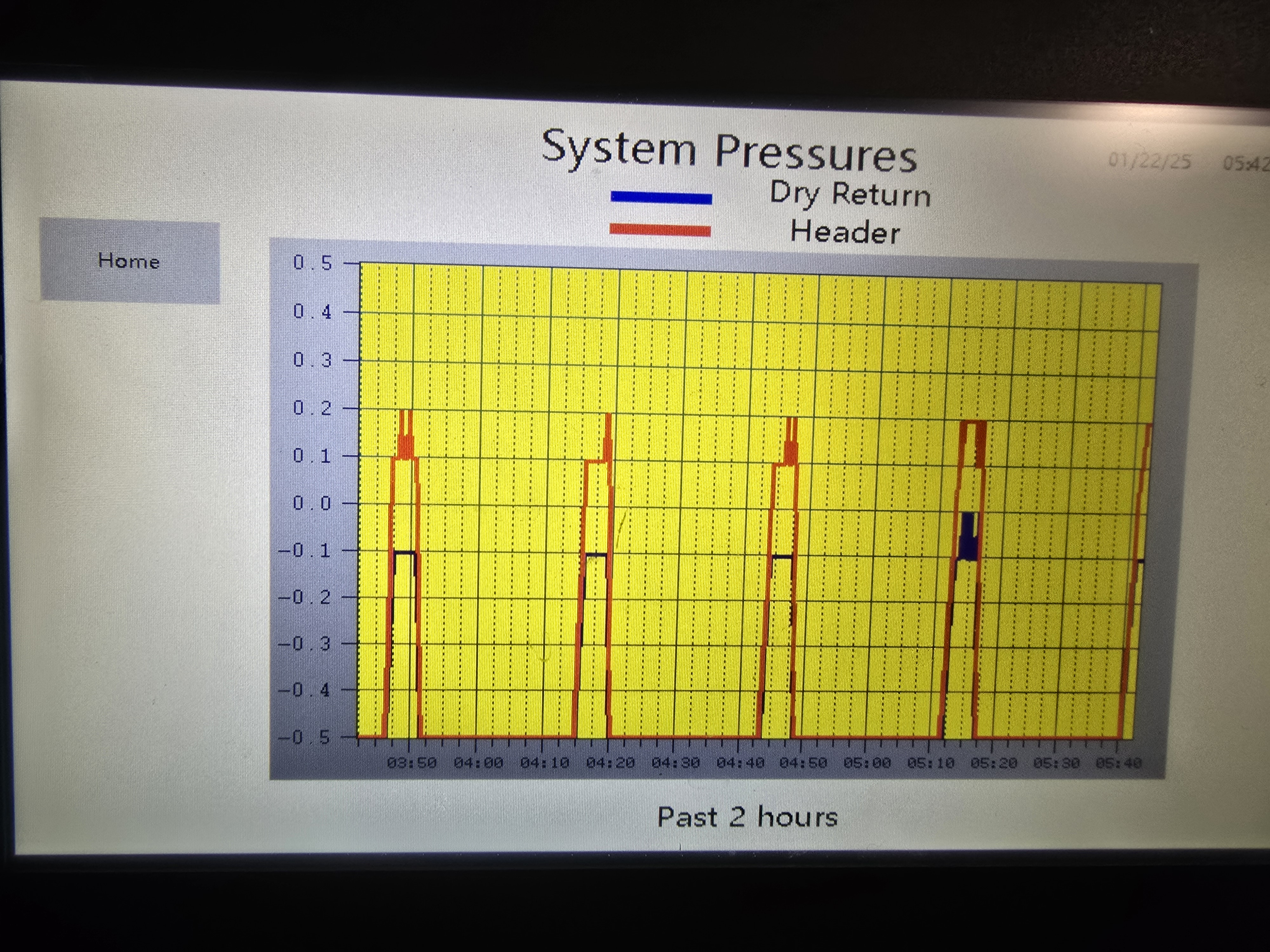

    I don't know the timing of the first cycle, obviously it also depends on how long the boiler was off/how cold it is outside.
    Exactly @DCMA1 . The amount of steam you would like to add to the system each burn depends on the starting place and differs by multiples. But you are stuck with only one possible rate - full blast, and no stopping until your tstat is satisfied.
    There is endless debate on the subject because these systems change hands and new owners experience the same frustration you are. They come to know even without any technical background that their boiler should stop firing sooner than it does on virtually every burn cycle because they can feel that there is already enough steam in the radiators to get the job done and will soon - many minutes before their Tstat knows it. They get told here that their boiler is too big, which usually is a show stopper and so they just live with it. I don't think my boiler is too big at all (it would trip on pressure with the standard control) and knowing what I know now would never choose to live with it that way.
    If you are interested, here is what I am currently doing with my big boiler and have been for at least 10 years and like a lot. I am quite sure it would work fine with an even bigger boiler than I have now.
    I installed a heat switch on the feed pipe of my most remote radiator to be able to know on every burn when new steam gets that far. On a cold start that could take 25 minutes and in continuous cycling less that 4 minutes. So first off every burn always runs straight as long as it takes to get steam to the radiators. I then have a fixed timer that I can adjust (but haven't in years now) which extends every burn to a point where radiators are filled to about 1/3 and stops the burn there. When that same switch opens again and I know that a significant amount of the steam I just made has condensed and its heat now in the rooms I start another fixed timer - again one I haven't changed in years - which delays and starts the next firing if there is still a call in progress. I'm betting you can see that how long it takes to get steam to the radiators and how quickly that steam condenses is directly related in real time to the conditions. So in this way total burn times and total wait times change themselves as the conditions do. The rate at which natural vacuum is created between burns is also an indicator of how cold it is and I use that too for the burn time adjustment but I'll leave that out for now.
    So with this setup you can take full advantage of the speed of a big boiler to recover or fill to the level you want quickly but without filling the system up and creating pressure ever. Its output is in even pulses and all that is required is to find a fill level very slightly above what is required to stay ahead of design day cold by adjusting the fixed timers. For me that fill level is around 1/2 full radiators.
    Unfortunately no contractor is going to do it because there is no commercially available control doing this available. That's a shame. It is way better than the standard control. I've run both so I know.

    I will point out that I'm quite sure the PLC is not necessary for this. It can easily be hardwired with low cost components.
    That said, I'm sure Techmar is a very good unit. The cost, however, probably well past what will work for the average homeowner.
    It is true that I have spent a long time observing and experimenting. But I have kept the actual control part very simple on purpose. I have no interest is selling anything but I wanted the end result to be accessible to more people.

    I will say that knowing what I know now assuming Techmar solves the same issues I am(and I do think it would), if my choice was buy Techmar or do nothing I would pay a contractor to install one.
