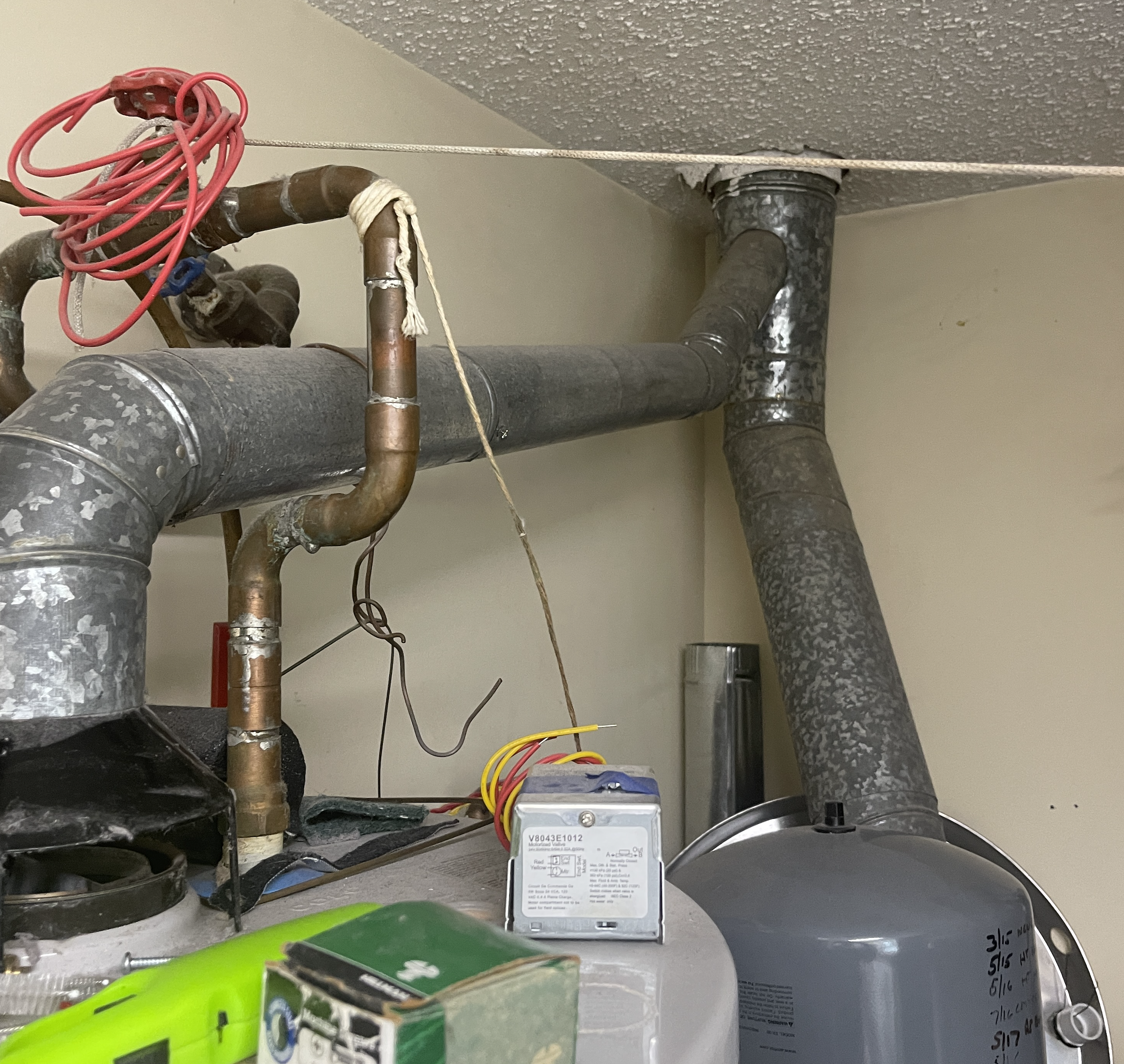

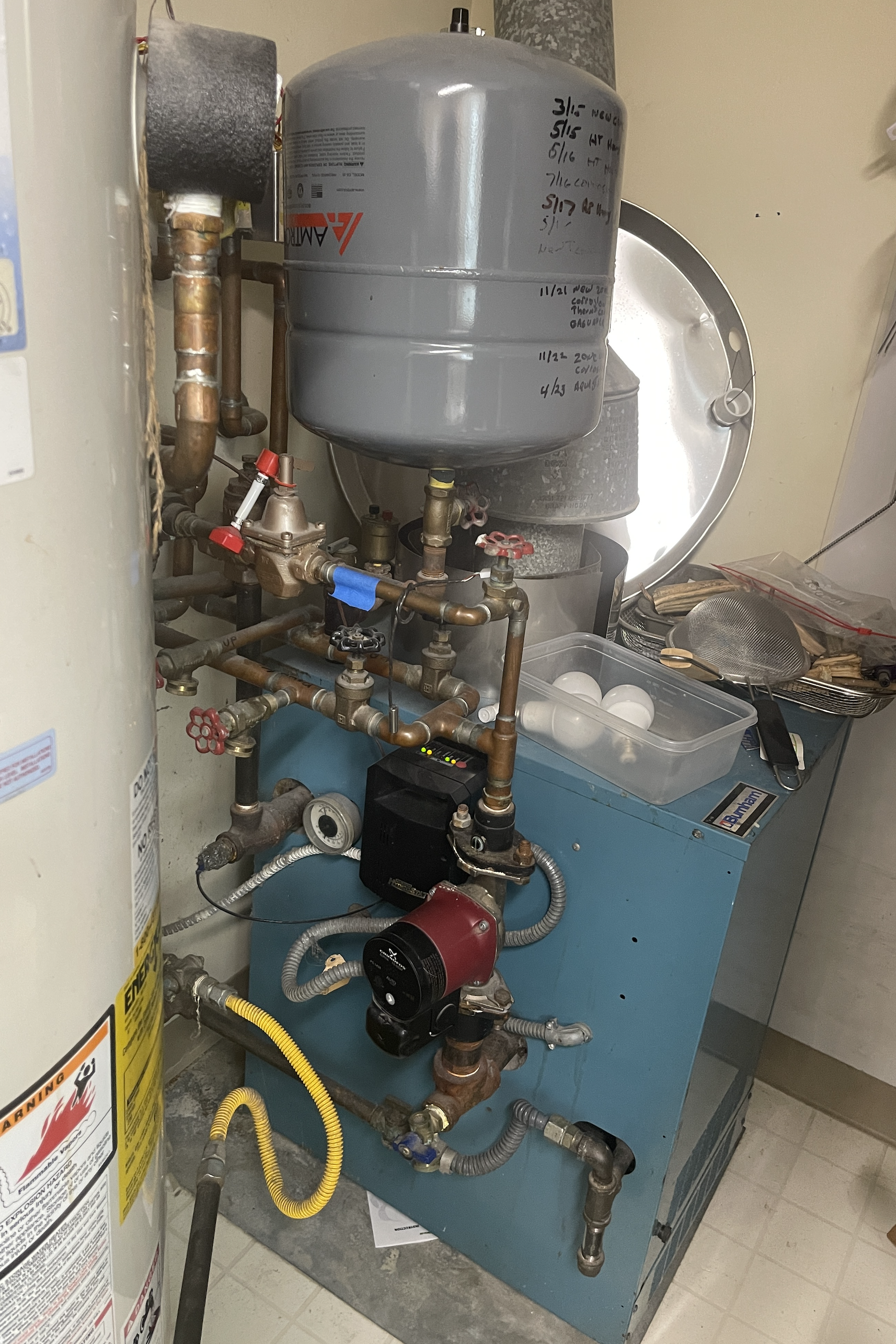

I currently have a 96k input Burnham boiler and a 40 gallon 32k input water heater, both natural draft, original install in a 1600 sq ft home built in 1983 .
2 zones, Honeywell valves, single grundfos alpha circulator. Natural gas, 1" pipe supply to boiler, just a few away from a 275cfh meter. Total of 88 linear ft copper tube aluminum fin baseboard.
Home is built on a crawl space, mechanicals are in first floor laundry room adjacent to living space. This room has a 7 " b vent for the boiler, hot water combustion products and a 4" vent for the gas dryer.

  • It has been very reliable, but looking at 42 years old for boiler and a gas water heater from 2007 .
    Since this is located indoors, I'm not looking at heat pump water heater, but a heap pump clothes dryer, this would allow closing the dryer vent.
    II would like to use outside air for boiler combustion forced draft out the side of the house.
    DHW indirect tank would be ok.

    your baseboard will transfer about 44,000 btu/ hr. That boiler seem large for the home, about twice what you need. So when you do upgrade, consider downsizing.
  • My boiler and domestic hot water are quite comparable to yours. Same age, size , baseboard and venting with some minor differences . I am waiting until my boiler leaks or is otherwise non repairable .
    A smaller boiler is certainly recommended when it comes time to replace, as @hot_rod mentions.
    One thing to consider, a cast iron power vented/ sealed combustion (outside air kit) boiler might be quite expensive when all said and done. And it will not modulate.
