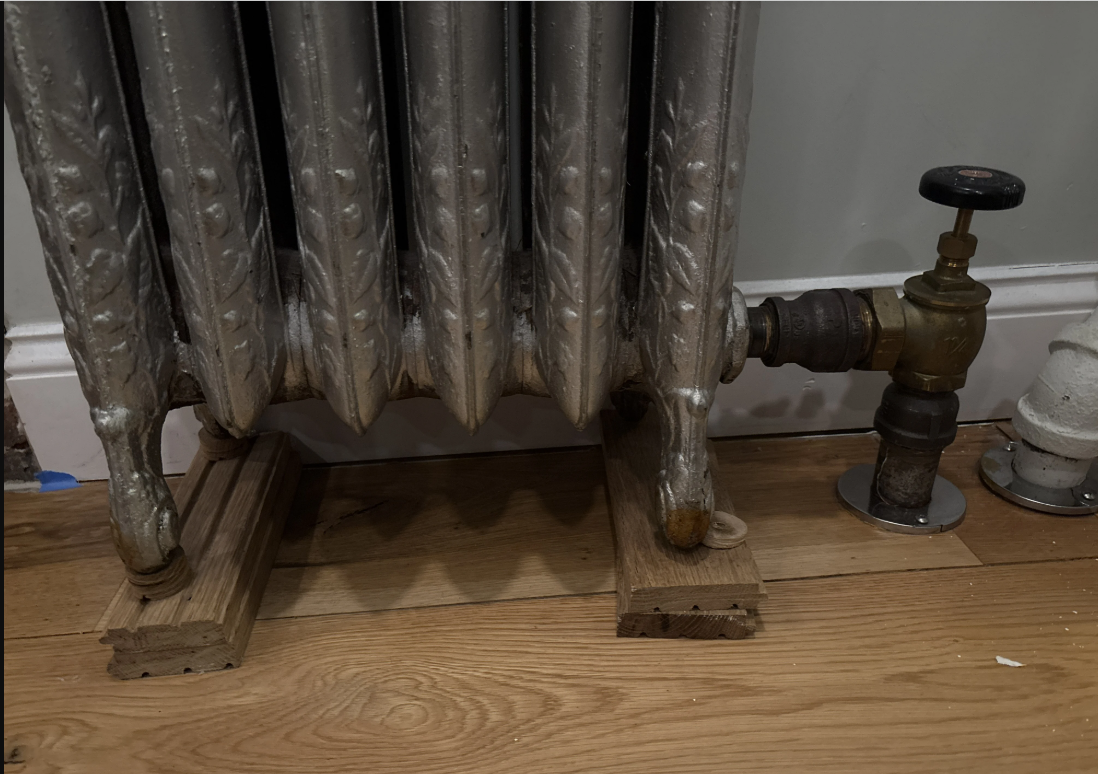

Every time my plumber has come out to replace an original old radiator valve, he ends up having to raise up both sides of the radiator with 1/2-1” tall wood slats to account for the new valve height.
Is this normal or is there different options in replacement valves which could avoid the need for wooden lifts? He’s probably just getting the new valves from a big box store so maybe there are more options at a plumbing supply which could avoid the need for these wood lifts?
He told me the new valves are sized different from the old fashioned ones so the wooden lifts are needed.
It works fine but just looks crappy.
Oh and to be clear, with the old valves the radiators used to just sit directly on the floor with no need for risers except maybe something small under one side to add pitch.
  • It looks as though he didn’t purchase the correct size radiator valve although the nipples going into the radiator looks much smaller.
    Can you take another picture further to the right and closer to the radiator that shows the pipe going into to the radiator. And another picture of a radiator valve that has not been altered.
    delcrossvmattmia2

    Why did he put a 1" extension on the riser to have to raise the rad 1" ?
  • bipbap
    bipbap Member Posts: 233
    edited February 2025
    I don’t know.
    I think those are 5/8” planks of flooring under there so with two of them stacked it’s raised up 1 1/4” and then he added a 1” extension.
    Maybe he thought 1/4” wasn’t enough room to play with so he decided to add an extension? Does that make sense?

    I think if he got the correct fittings and valve it should go together.
    You also could repack the old valve and use that.

    and lastly though, is there any reason a modern valve wouldn’t be a clean swap size-wise for an older one?
    mattmia2 Member Posts: 17,905
    Most valves that are different manufactures or series are slightly different dimensions. If you replace the valve you are likely to need to make some adjustments. Regasketing the old valve eliminates this problem.
    Long Beach Eddelcrossv
    It might be because the new valve was actually shorter than the old one, so he had to install the extension which then made the new valve too high so then he put wood under the radiator.
    EBEBRATT-EdSTEAM DOCTORJells

    I can't blame him too much, I too have found that new valves are shorter than old ones.

    It really looks like he got a 1 1/4 valve and had to adapt it to an 1 1/2 riser. Even if there was no alternative I hope he or someone is coming back to replace those flooring pieces.

    He used the wrong valve. They come in every size from 1/2" to 2" and in angle (what you have) and straight. He could have made this work without raising the radiator.
    Here is the valve he probably should have used, assuming that is a 1-1/2" supply.
    Here are the dimensions. I bet if you compare it to your old one it is close enough to call exact.
    Grallertdelcrossv

    It's always easy to criticize a man's work, and I do agree that this is a shabby job. We see lots of them. But we also understand that many customers don't want to pay for good work.
    A tradesman can rebuild an old valve, and he can provide a new proper valve. Or he can install what's on the truck. What does the customer want and what will the customer pay to do?

    Don't pick on the plumber too much. But he could have done a better job.
    I have been in that spot myself and replaced a valve on the second floor of a school and it was a 2-pipe system so I had to raise the rad and recipe both ends and the piping under the floor had no movement
    The valve I had was short compared to the old one. The old valve was corroded from leaking for eons.
    So the rad had to go up.
    In my case the rad was covered by a radiator enclosure so the blocking couldn't be seen.
    Now if you want to pay your plumber to drive around or get on the phone with every supply house in the city your going to pay for that
    There are no standards in valve dimensions, just like steam traps they are all different
    If you install a new valve and it is shorter than the old valve you only have 2 choices. Raise the pipe. If you cant raise the pipe than the radiator has to go up on blocks and you make up the height difference up with a coupling or a male x female coupling
    We all know most of the new valve are more cheaply made and are different dimensions than the old valves. In addition some are more for hot water than they are for steam.
    That being said he could have used something more attractive to set the rads on
    Get some wood that matches your floorboards and stain it to match . You can easily pull out what is there and replace it
