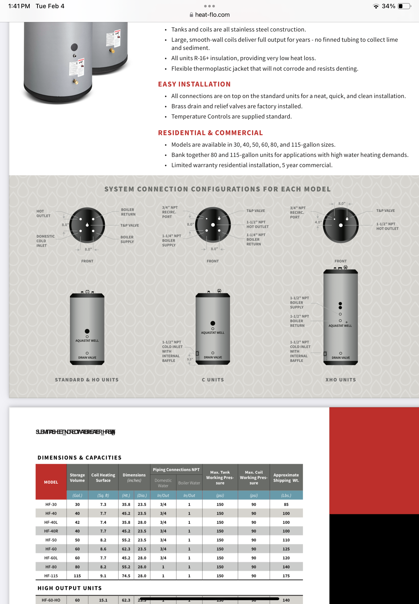

Hello. I am looking to replace my existing indirect water tank and am looking for some guidance/advice. I currently have a 40 gal Heat-flo indirect tank that is 13 years old. We just completed a bathroom remodel and noticed the shower doesn't maintain hot water very long. Can somebody recommend a good indirect unit? My house is an 1100 sq ft ranch - it is just my wife and I.

    Does this model use a dip tube? If so it may have broken apart.
    hot_rod Posts: 28,699
    do you have the manual for the tank? Some models are top feed, some are bottom. Their website has the info, probably for legacy models also.
