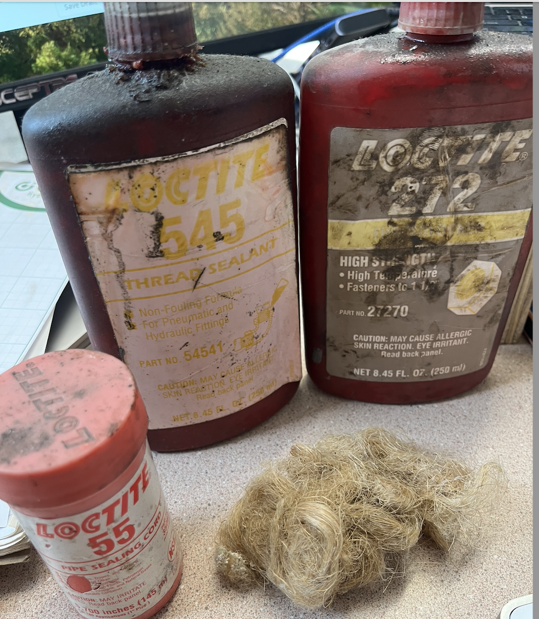

    hot_rod Posts: 28,856
    Many BSP connections are sealed with Loctite thread locker. 545 and 272 are what we use at the factory. Sometimes Loctite and a nose gasket.
    Hemp or Loctite 55 string may work, but it is not a pretty look.

    The loctite 55 is teflon string. you can also use ball wick which is thin cotton string and can make threads with larger gaps seal along with teflon dope.
    Er I guess loctite 55 is actually nylon with a dope in it.

    pipe fitters in Europe like the straight thread as every pipe they cut ends up being the correct length. With tapered threads you never know exactly how much the thread make up will change the fit. With the straight thread they can back off to make the fit exact. More like a nut and bolt.
    From my visits to jobsites around our factories in Italy, Pex tube or soft copper with either press fittings or compression fittings, is most common. Threaded fittings into radiators with hemp or 55.
