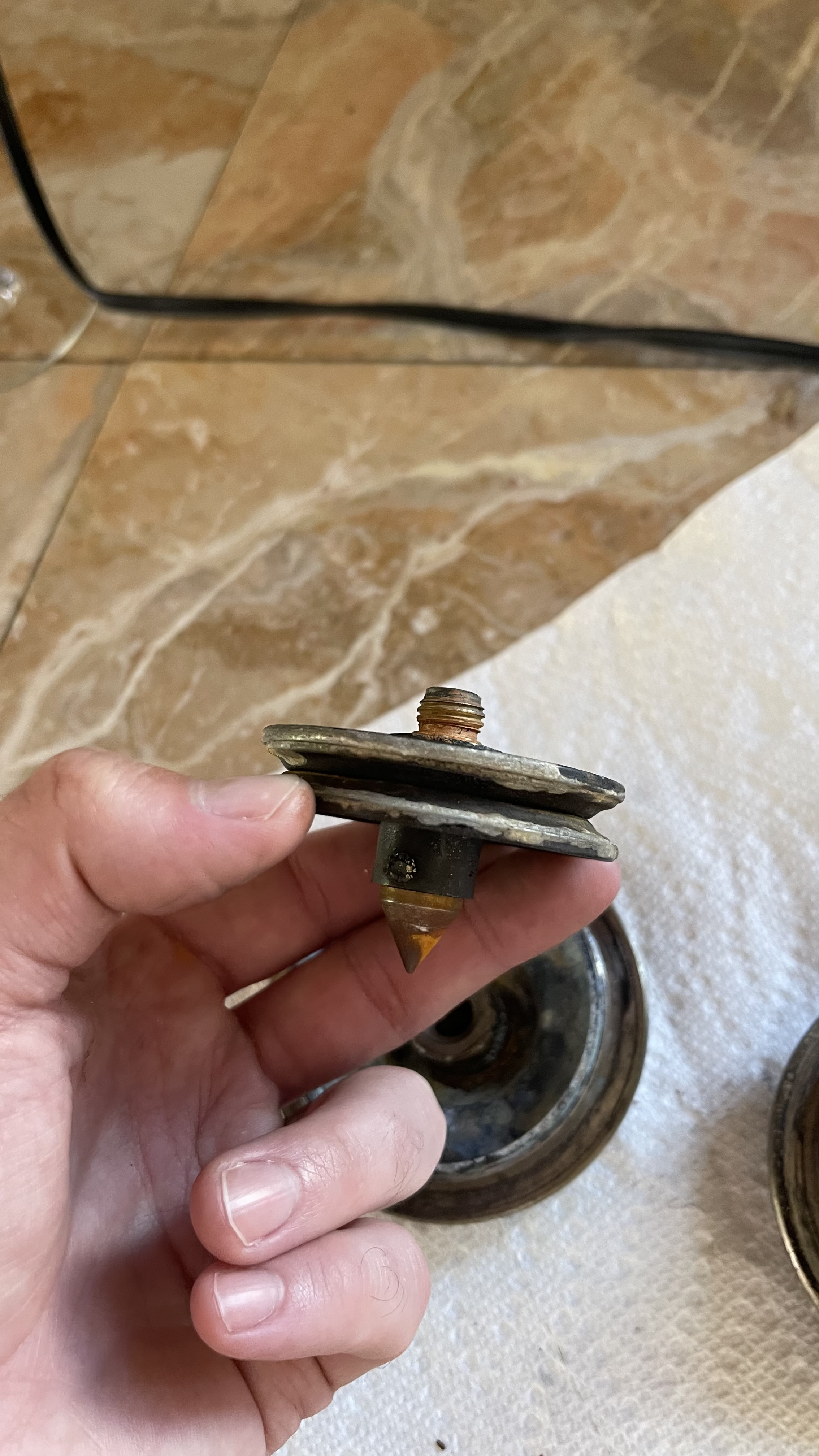

    Hey everyone, apologies for the radio silence, and a big thank you for all of your helpful info. I FINALLY found some time to get the suspect traps open and I’m ordering some Tunstall replacements:
    Trap Types
    Replacement Capsule
    Hoffman 17C
    TFHF-1409
    Warren Webster 712HB
    TFWW-2515
    Barnes & Jones 134
    TBFJ-1007
    Barnes & Jones 1/2” Model C
    TFBJ-1748
    Thought I’d share a pic of the guts:

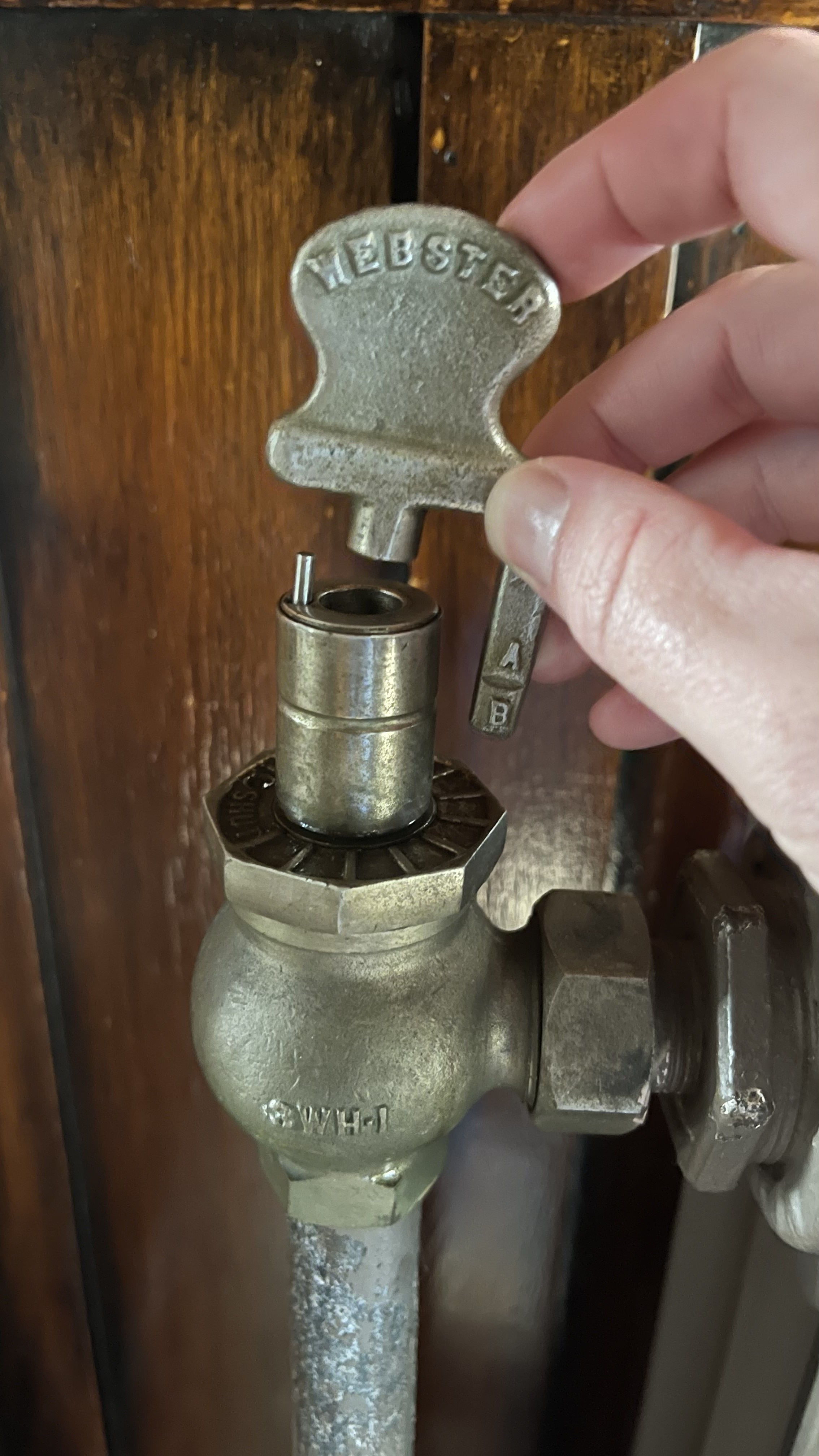

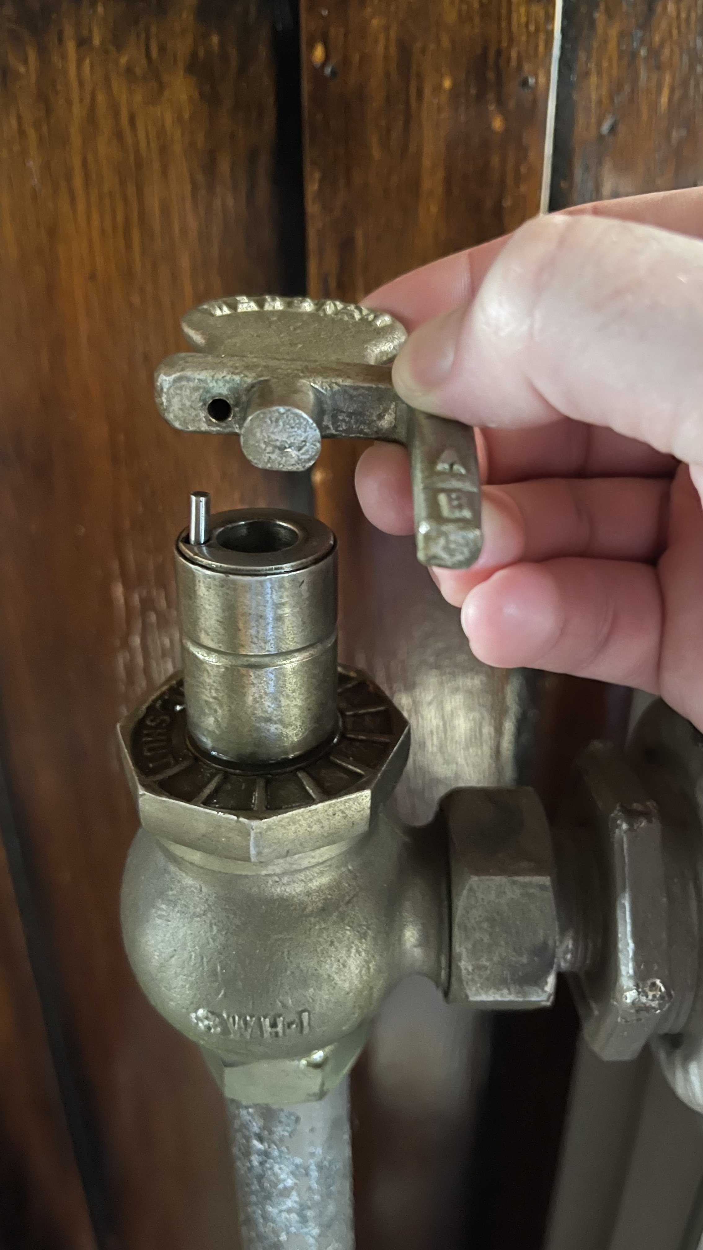

    now while I’m waiting on the ordered capsules, would anyone have any idea what type of valve this is? It says Webster on the other side of the handle and I’m assuming there’s a pin that connects the top handle to the valve itself but that is missing.
    Thanks again everyone!
    mattmia2 Member Posts: 17,565
    That is a vapor valve, it is a special metering type valve and either it can be set to only open a certain amount to match the edr of the radiator it is attached to or I think in warren/webster systems they may have had an orifice that matched the edr of the radiator.
    It may be a packless valve that uses a bellows instead of packing to seal the stem.
    It looks like the handle is broken off, looks like the bottom left had more attached to it that probably held it in place(some vapor valve used that part to index to a stop that limited how far the valve could open).
    Others will know more of the specifics of this particular valve, i am mostly just giving general vapor valve characteristics.

    Thanks @mattmia2 ! It doesn't look broken off to me (I'll get a few more pics) but either way I have some steel dowels on order to see if that can fix it.

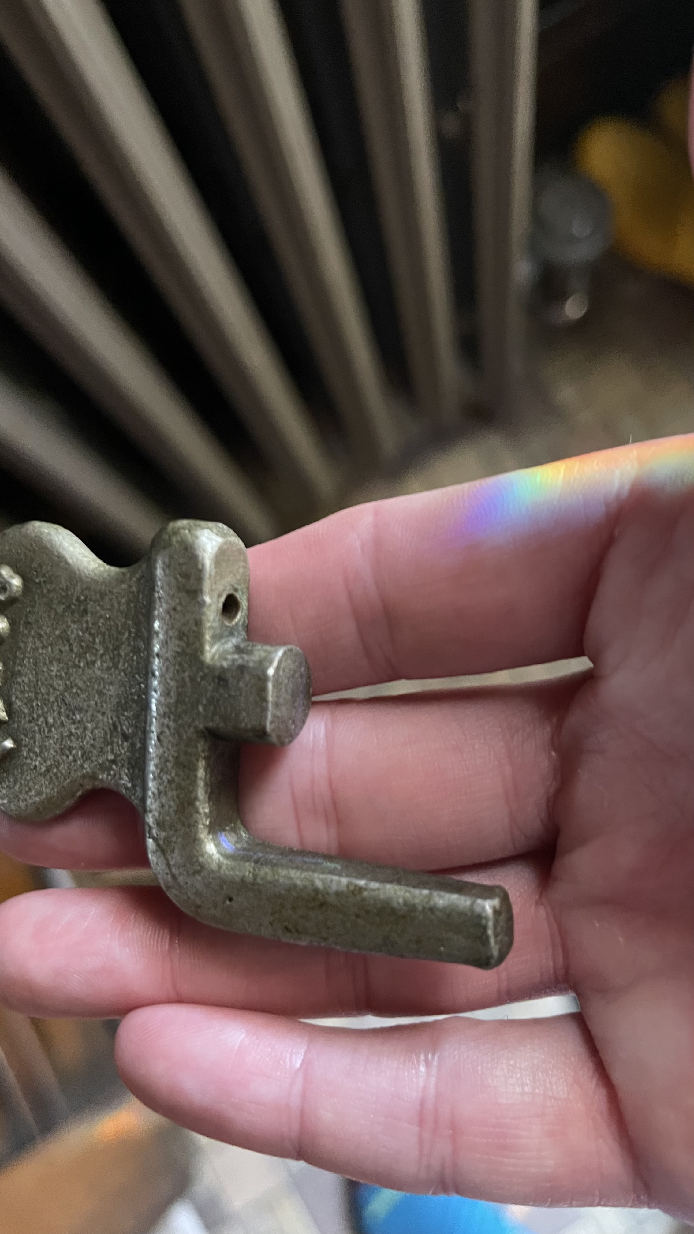

    I also got a few better pics of the vapor valve (and the new steel dowel pin I ordered!) as well:
    It very well could have broken off, but the bottom of the handle doesn't seem broken or rough. The dowel pin I ordered is sliiightly too small so there is still some play in the handle, but I was able (with a bit of force) to get it to turn, so all in all, progress.

    Oh, it was some sort of a tamper resistant valve with a separate spanner to turn it. Normally there is a handle attached to the valve.

    That's called a "lock-shield" valve. And the part you're holding in the pic is the key.

    Thanks @Steamhead, I was able to get a small metal dowel into the lock-shield key and get the valve open!

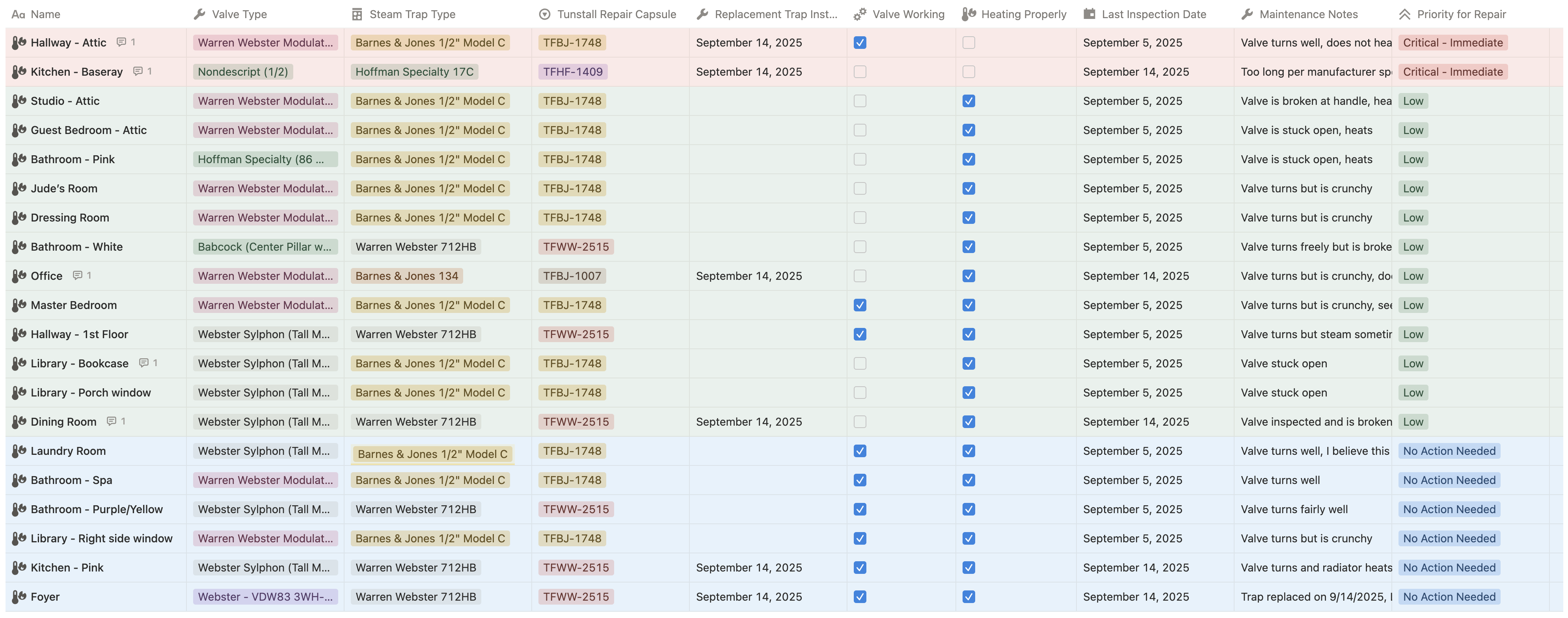

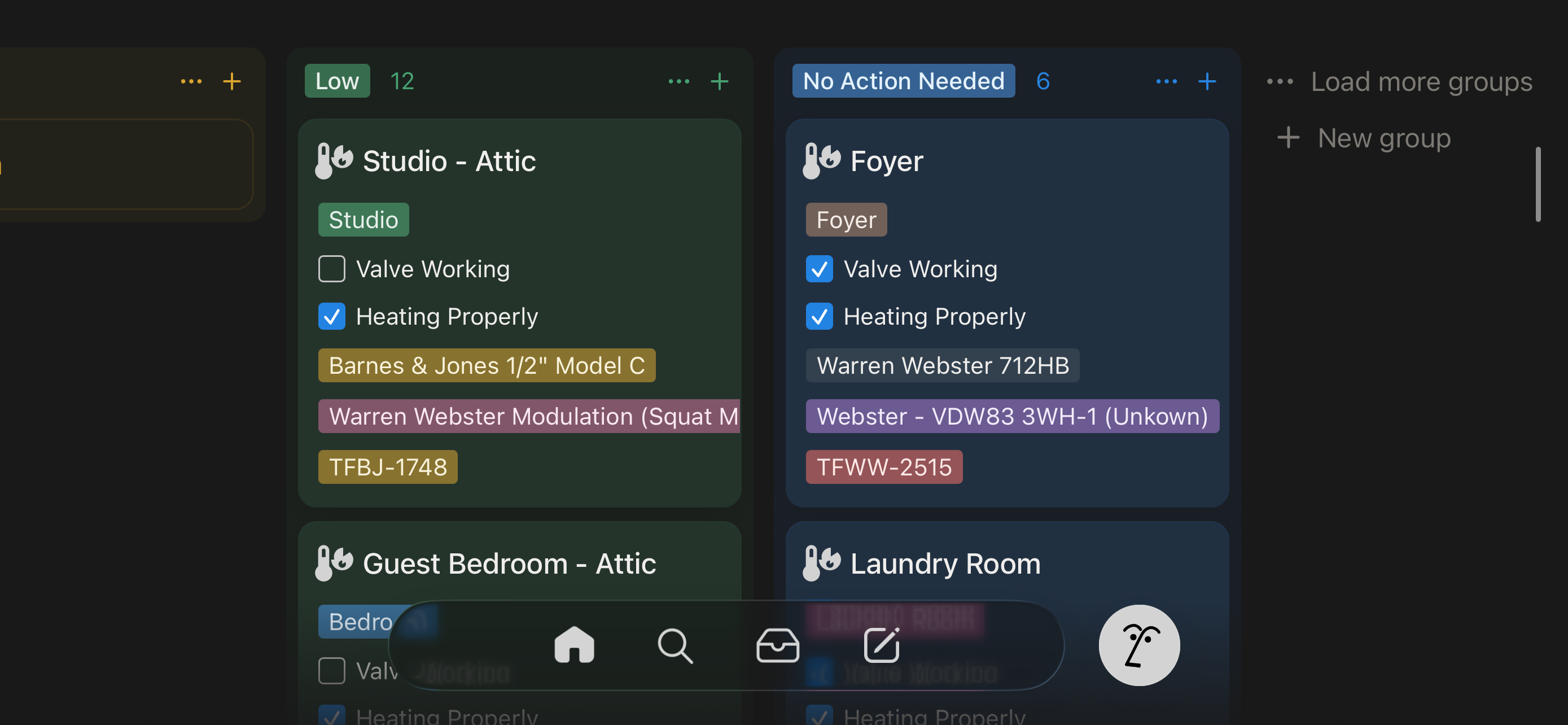

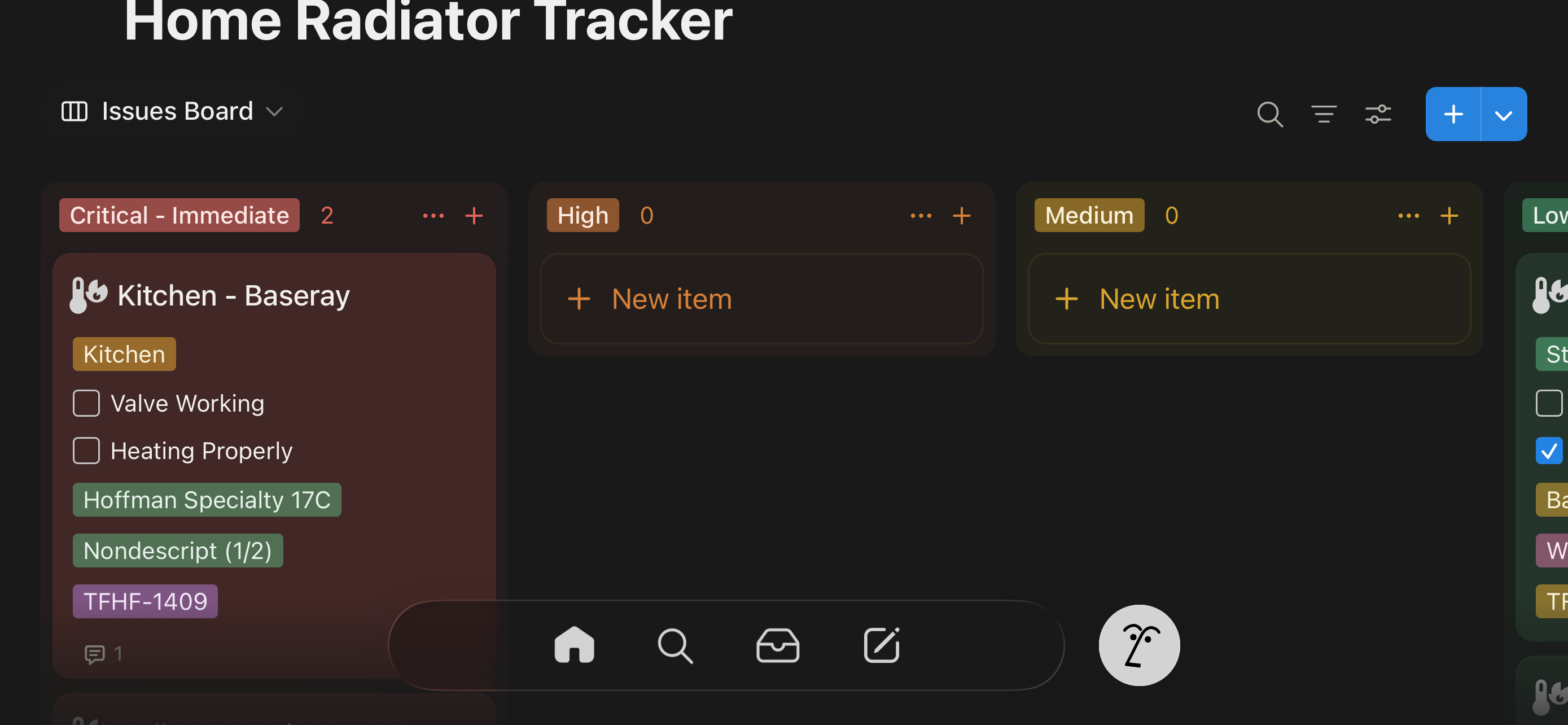

    I also built a radiator tracker on Notion (screenshot below) to keep track of all these repairs and issues!

    Can you explain what Notion does for you? (Looks like Excel)

  • Hedwig595
    Hedwig595 Member Posts: 29
    edited November 2025
    @CoachBoilermaker I’ve been curious about notion for a while and I figured this was a good use case. It’s more of a database than excel (even though that table view I included is just essentially excel). For example I can click into any of those radiators and include a photo, notes, or even create a special page for keeping track of what I’m doing on it.
    The thing I really like is that I can use the “priority for repair” property to set up an issues board where I can see what needs to be inspected/repaired/what doesn’t.
    Essentially it’s probably overkill but I’m having fun with it!

    Ok, so notion seems like a to do list, database, Google docs, Excel etc all in one tool.
