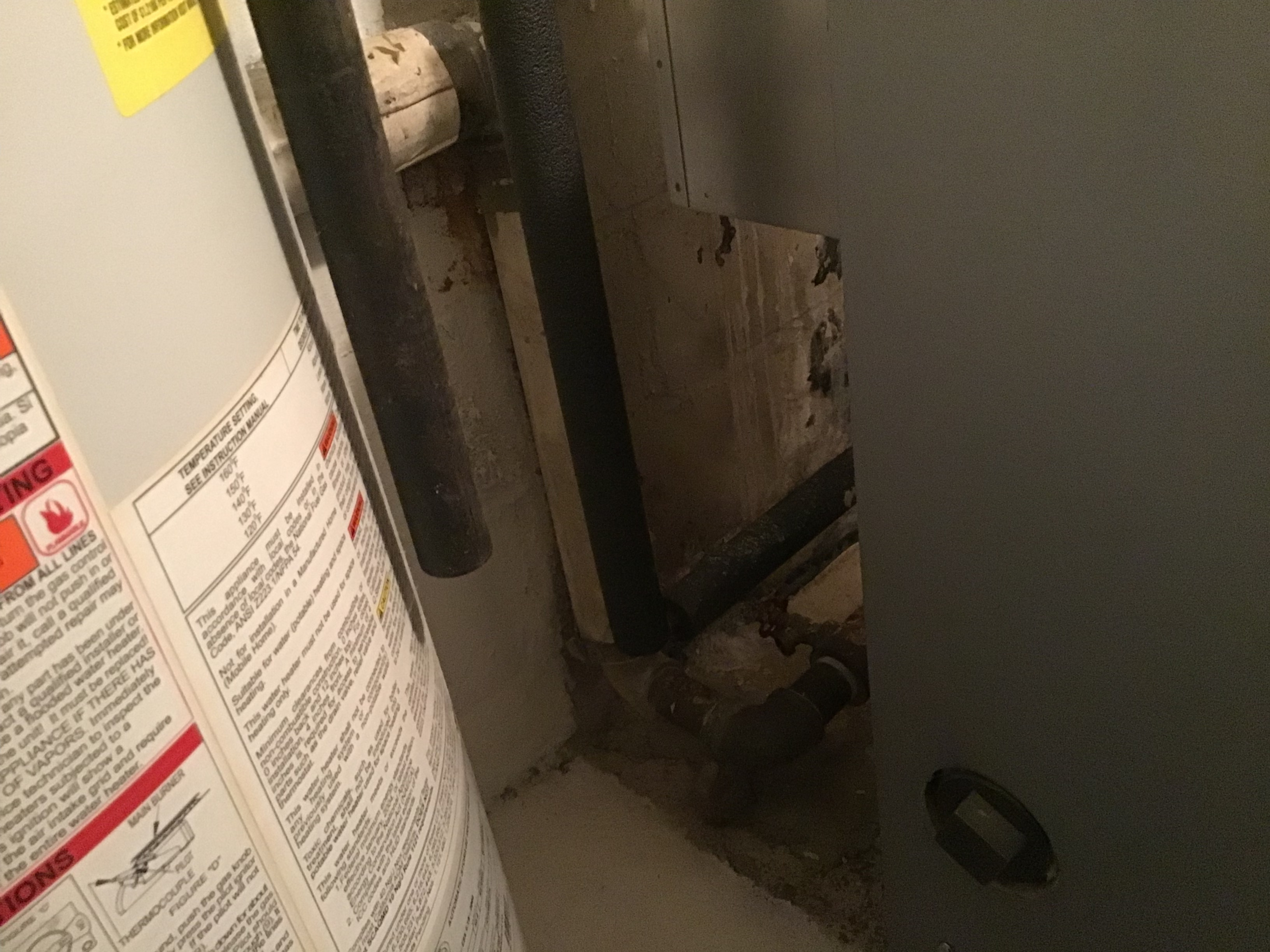

    So I’m safe to assume that the main vent should be somewhere above this line…..this is the opposite corner of my basement from my boiler. The line running to the right is the return line to my boiler.
    It's really hard to say from that photo. Finished basements are my enemy.

    At leonz….I have one single pipe going to all my radiators, so I believe that’s considered a single pipe steam system. No expert here, just going by what I’ve read and their descriptions……appears the 2 mains reconnect above this point and drop down to the pipe that returns to the boiler.
    Jamie Hall Member Posts: 27,788
    One pipe to each radiator is a one pipe system.
    Now that pipe half way up the wall may be a wet return — it should be — which is required in all parallel flow systems, one pipe or two pipe. I am, however, a little concerned that it may be above the boiler water line, in which case it could cause problems in some arrangements.
    In this particular setting, however, the system seems to be working well enough, so I doubt that there is a problem with it set where it is.
  • geemalar
    geemalar Member Posts: 104

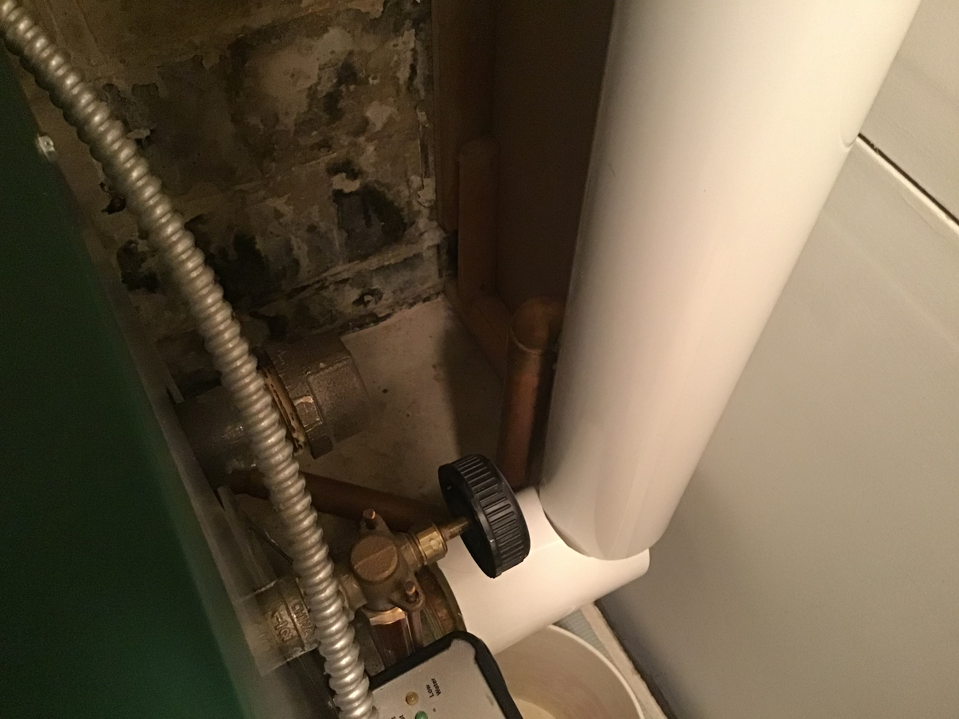

    The pipe you mention is what I believe is the wet return……..it runs approximately 5 feet to the right in the picture, makes a 90 degree turn and runs 30 feet along the wall, and then makes another 90 degree turn and runs about 10 feet on another wall. During that entire run it has a downward pitch that reconnects it to a pipe that is connected to the base of the boiler. The copper pipe in the second picture is where this wet return reconnects to the boiler system.

    That’s a very good question……my washer and dryer sit on the other side of that wall in a finished enclosure. In following the steam main from the other side of my house, I can see and feel (from the heat) how the pipe is boxed in about 5 feet away from the back wall. It makes a turn in towards the back wall and appears to drop down. It connects to that pipe coming from the left. My main from the other side of my house connects to the vertical pipe in the picture. So in that general area is where both mains connect to the return line back to my boiler.
  • delcrossv
    delcrossv Member Posts: 2,204
    OK, then the vents should be in the ceiling where the vertical pipes drop down into the common return.
    Guess some drywall needs to be opened up. I'm with @ethicalpaul: can't stand finished basements.
    You may get access by removing the panels on the right. Seems they're set up for easy removal.
