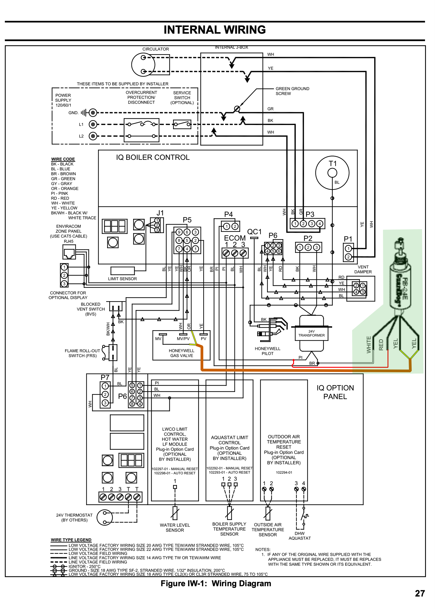

Looking for help wiring guard dog low water cut off model RB24E into Burnham ES2 gas boiler. The lwco has a grey wire harness with 4 wires. Much appreciated.

    do you have the wiring harness Y that will be connected to the vent damper? That will give you a place to connect the LWCO

    If you don't have the Y connector then you can connect the pig tail connector this way.
    In the wiring diagram there is a shaded area that represents the RB-24E with bare end wires on one end and the 4 pin connector on the other end. You need to connect 24 VAC to the red and the white on the RB-24E pig tail so the RB-24E has power (as shown on the diagram in Br and Pi). then connect one of the yellow wires to the MV terminal on the gas valve by removing the orange wire from the gas valve. Then connect the other yellow wire to the orange wire you removed from the gas valve MV terminal.

  • Thank you for the replies. It is the harness with the bare wires on one end. I located the orange wire for the gas valve. Could I take 24v from the control board where it says d.h.w. or do i have to extend the red & white directly to the 24v transformer?

    you must connect to the transformer or any wire that is connected to the transformer
    I don't see D H W on the diagram. you must connected directly to the transformer in some fashion to be sure that the RB-24E is powered all the time that the heater is powered.
    So anywhere on that pink and blue wire is a good place to splice that in. So pick an easy place on that wire to connect.
    Same holds for the Orange wire. you can pick a place anywhere along that wire to cut it apart and connect the yellow wires there.

  • Got it. Thanks again @EdTheHeaterMan
