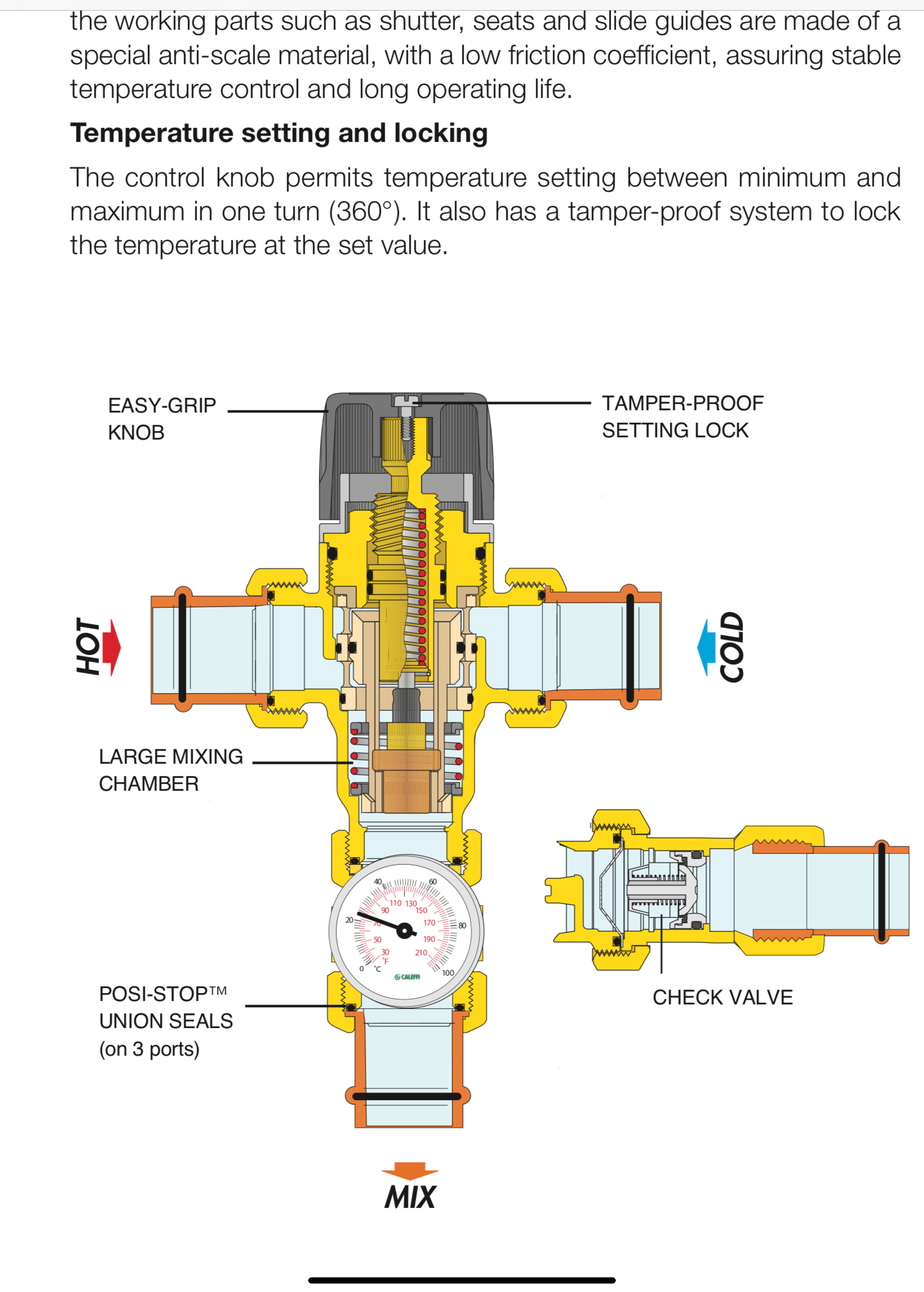

it is fairly easy to disassemble the mix valve for inspection. I have pulled the cartridge out of valves and run them, just to eliminate that variable.
Take the plastic knob off, see a large brass nut, maybe square. Unscrew carefully as it will have some spring tension.
Lay the parts out as you disassemble. Spring, plastic retention rings, spool, spring, and copper capsule at the very bottom. Put the top cap back on and run the system.

Two bran new mixing valves, no difference, I can put 1.8 GPM or whatever the bottom of the scale is through each loop using both pumps , one of them is cheap Amazon

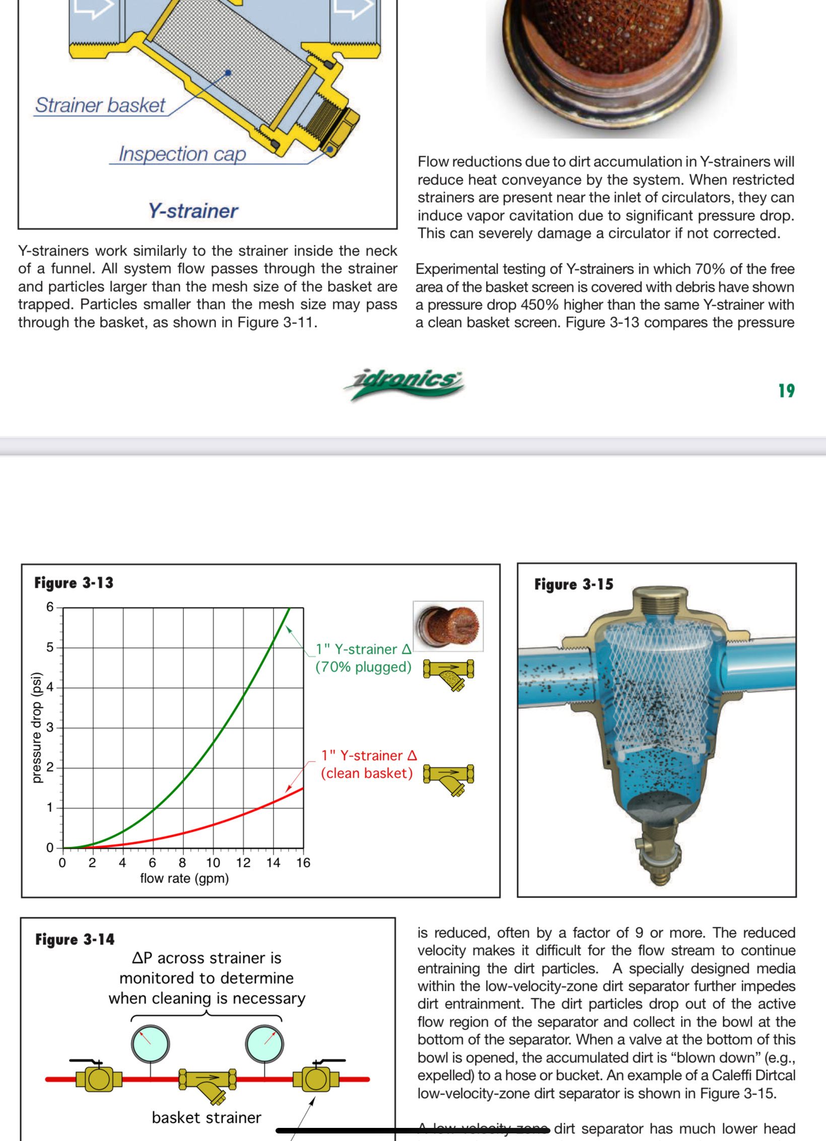

It's a long shot, but we have seen those air separators plug solid with crud. It separates in the middle, there is an O-ring seal there, to check the mesh inside.
Everything in the loop is what the pump "sees" Them HX, valves, strainers, air sep, mixing valve, manifold, loops, etc

I had issues with flow as well and this was the problem. The taco three way mixing valves were constantly getting clogged. Very fine strainers. I was getting hot water to the manifolds but not nearly enough volume of water to create sufficient flow.
Really no need for those fine strainers when you use a mix valve on hydronic systems.
Ideally there is a dirt separator at the boiler, protecting the entire system.
