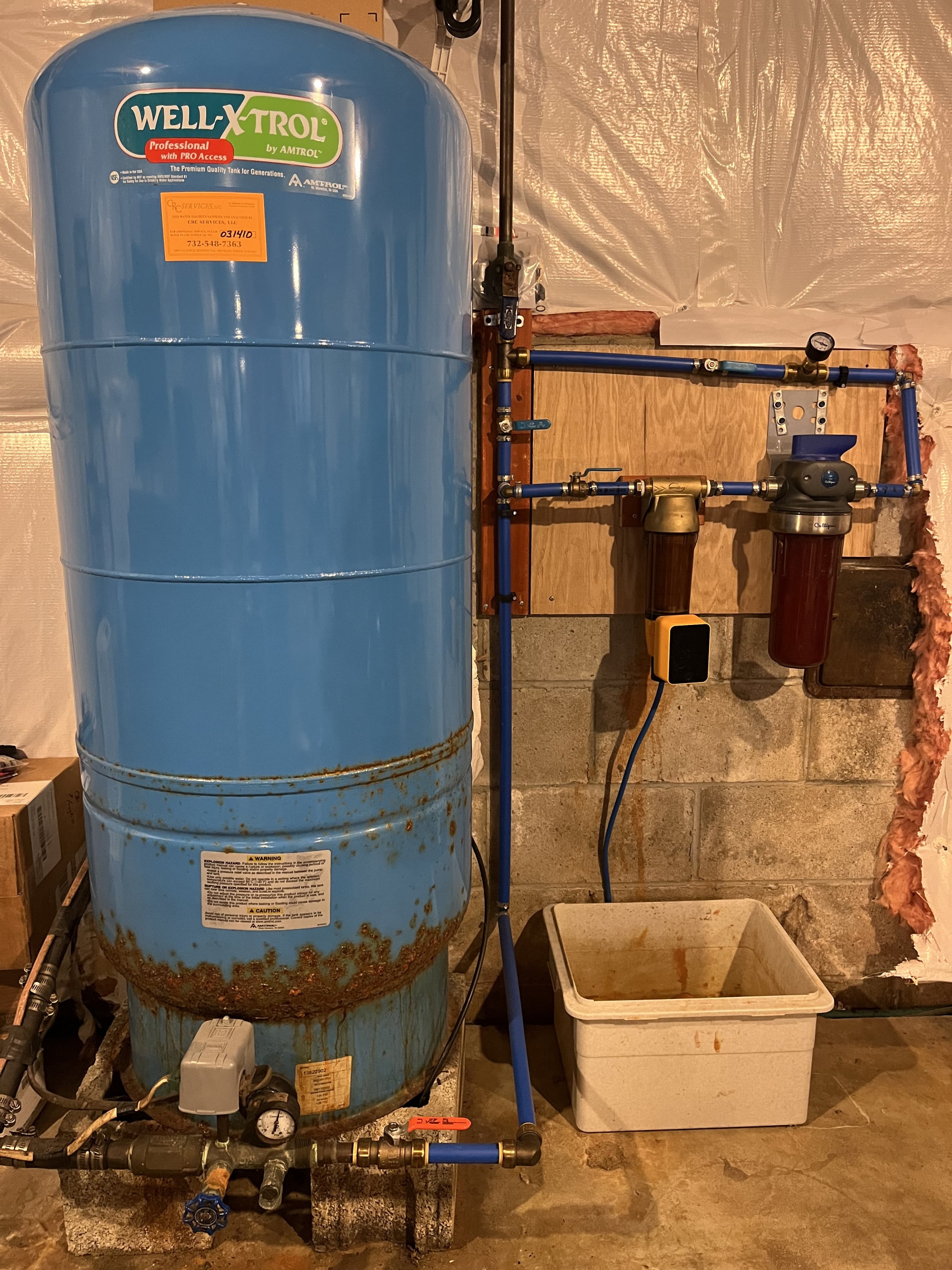

    The picture you provided last January shows a tank with a lot of rust at the base. Are you planning on changing that soon? When you move it?
    djclkirl
  • djclkirl
    djclkirl Posts: 12
    Apologies for a possible dumb answer/question here. The pressure switch is the gray box on front of the pressure tank..?
    Yes there is rust, should I sand to remove rush & paint - or I need to replace the tank?
    Attaching the same picture again.
    pecmsg Posts: 7,634
    edited March 2025
    that rust is from condensation.
    time to replace it!

    Yes, the grey box is the pressure switch. The cover lifts off and the contacts and adjustment are inside. WARNING: the contacts are not protected, and if the power is on, they're live!
    djclkirl
    I would install a larger tank when you tank needs replacement. Less cycling is better and you will have more drawdown.
    If the house has been there since 76' I would think the tank must have been replaced maybe twice before. It probably has a date on it.

    You want to be sure that you do not isolate the pressure control from the pump inlet line by placing a valve between the pump and control.
    Submersibles can produce enough pressure to blow fittings apart if no place for water to go.
    This simple fact also applies to boilers/water heaters that might have a supply stop placed between them and the pressure relief valve……someone will eventually close the valve……
