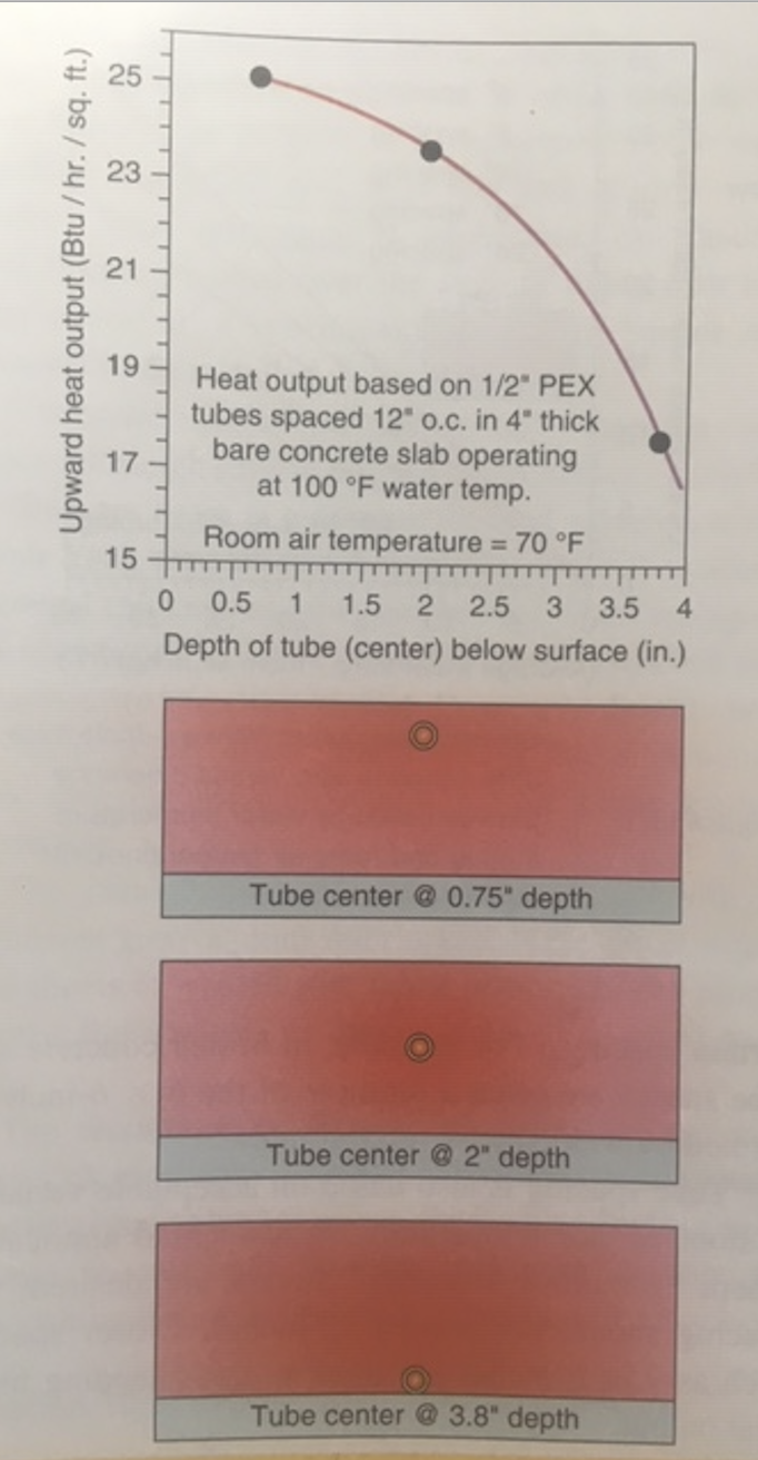

    hot_rod Posts: 28,699
    If the tube is at the bottom of that 6" pour it may need to run a bit hotter SWT, or take a smaller output per sq ft. This example was for a 4" slab 100 SWT with12" oc. The 6" oc will help also.
