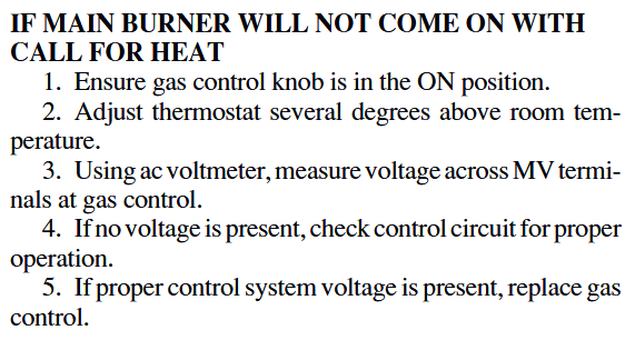

    I can clearly see that you have not followed the instructions above. I cna say that with confidence by looking at this photograph.
    Your next step is to thro that valve in the scrap pile and get yourself a new valve. You also need to test the replacement valve with a manometer. and check the flame with combustion testing equipment. Do you have that stuff? Do you know how to use that stuff?
    If you try to use that valve we will be hearing about you in the evening news broadcast?

    The datasheet on that VR8305P4337 gas valve. All 16 pages.
    https://customer.resideo.com/resources/Techlit/TechLitDocuments/68-0000s/68-0109.pdf
    The outcome will probably be the same. From the manual.
