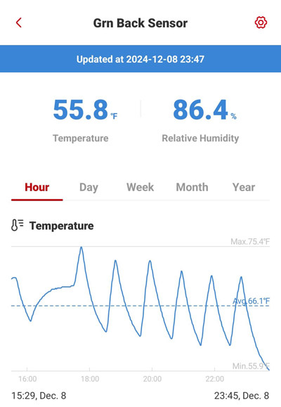

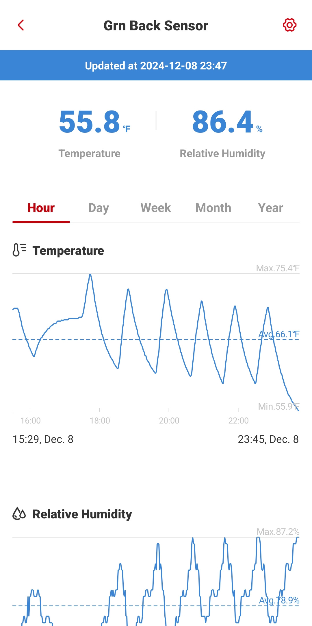

Same issue. As far as I could tell (I have smart temperature sensors and their app), heater was fine for a day or three, then on the afternoon/evening it would go through 3 or 4 cycles, then not come back on. Being a stubborn old woman, I sat and watched to catch it in the act. The pilot would simply snuff out 15-20 minutes after it cycled off. Never had a problem relighting.

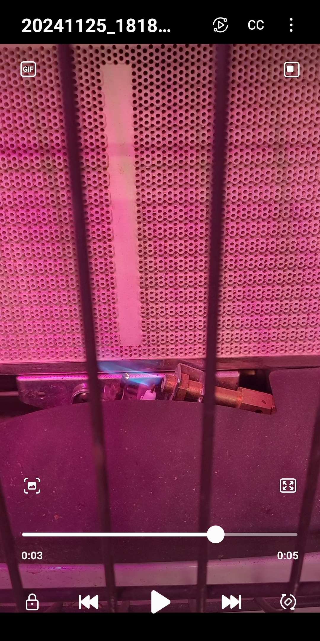

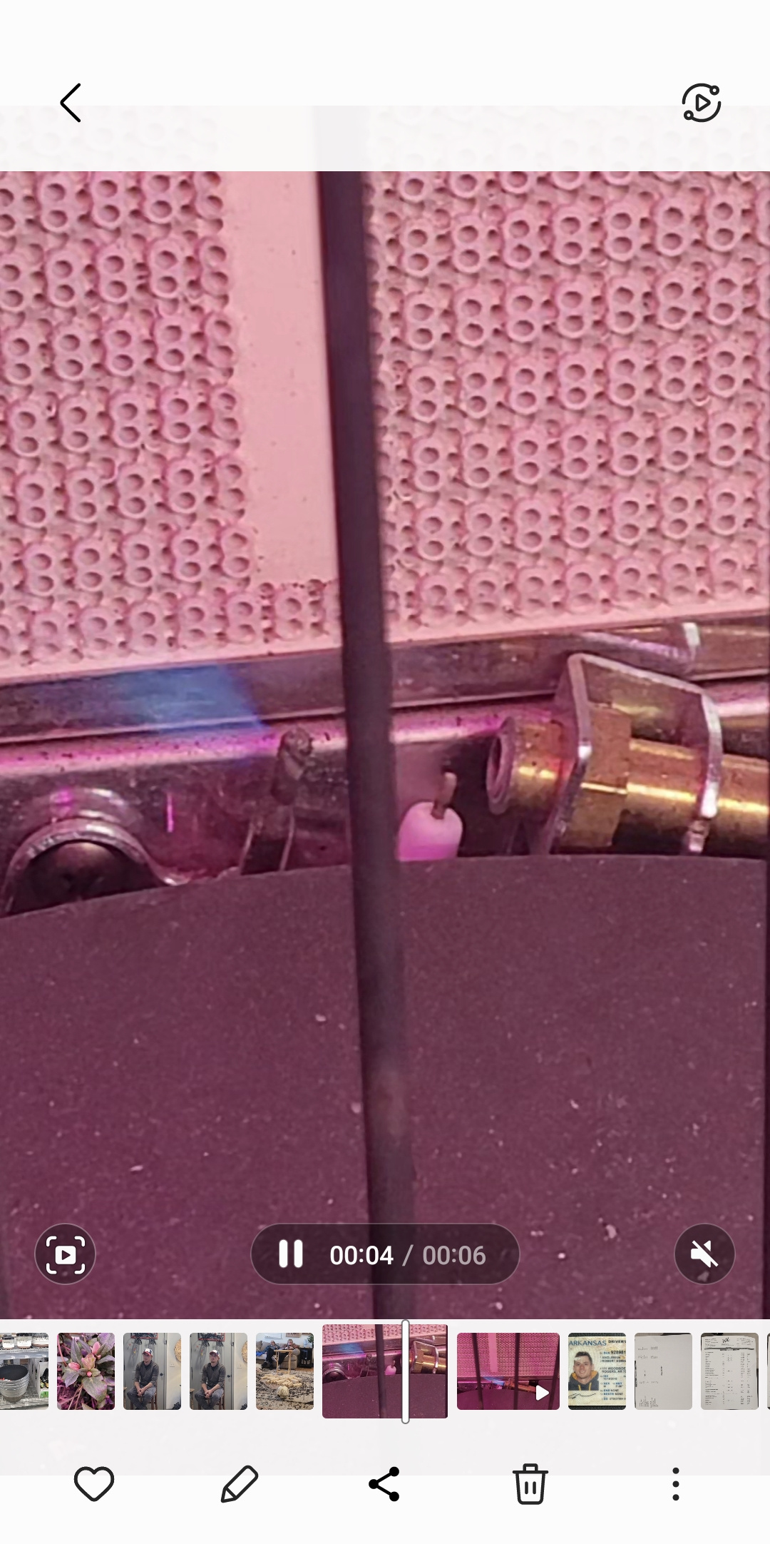

I videoed the normal pilot after burner cycle (attached); this was very similar to issue in February, where part of the flame at the tube would "disappear," then it would simply go out.
But instead of simply going out, it's like a high velocity something was acting on the pilot to the point where the flame "separated" from the pilot tube, and reappeared on the other side of the thermocouple (also attached); and there was a "high velocity" sound. I'm assuming the pilot goes out because the thermocouple isn't heated. It does this for approx 35-40 seconds before going out.

    One thing I noticed a while back is after first cycle, each subsequent cycle starts and ends at lower and lower temps, then out.

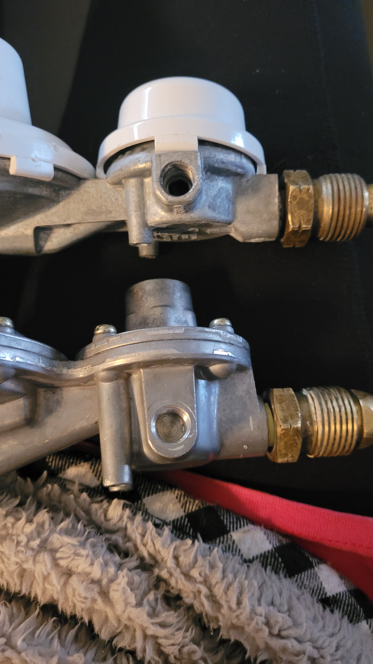

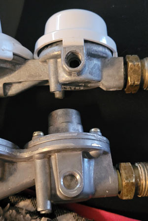

    without seeing the regulator i'm guessing the port on the bottom is the vent connection, it references the diaphragm to atmospheric pressure and if the regulator is someplace where the diaphragm leaking would be dangerous, it has to be piped outdoors
  • @mattmia2
    Sorry, it was in an earlier post, the bottom regulator:
    Untitled Image
