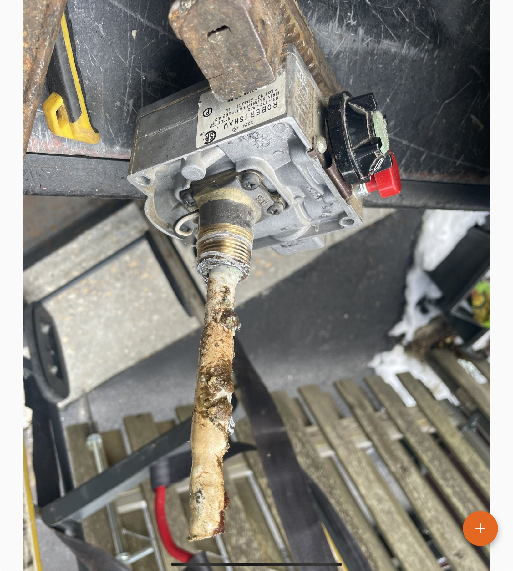

there is also an ECO built into the WH control, energy cut off, high limit control. I would not reuse that device!

no plans to reuse any of the devises removed from the tank that I scrapped for $4, but I did leave them sitting out front of the garage door in case I discover some magical use for them (boiler drain Valve, pressure relief, and natural gas controls). I will probably keep them all a few years before discovering they are wasting space. Some day when all my projects are done I will need far fewer tools and spare parts laying around. Some day.

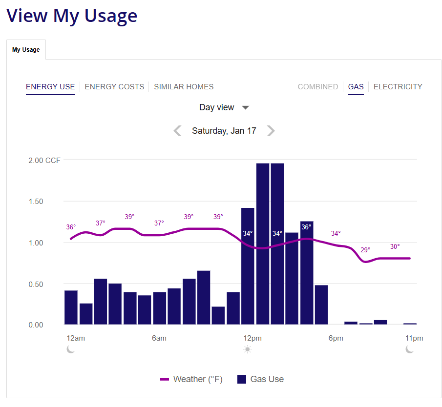

As is most of the eastern US right now, we are having some of the lowest temps in years. Lows below 10 F and highs below 20 F. I am wondering I the new boiler will be able to keep up.
And I see my electric and natural gas bill that’s due soon just came in at $713. That’s over $20/day. It doesn’t sound as bad when you hear we have an EV and $433 of the bill is natural gas (under $15/day) with two tank water heaters, 290k BTU of total potential. I am keeping an eye on things with my concept of replacing all that with only 155k BTUs. It will be interesting to see how things come in over the next two days.0 -
I believe I should trust you guys here more than a YouTube short that YouTube fed me, but I believe this short provides information contradictory to what I believe I read here. Does a water softener help or hurt water heaters? Different for tank and tankless? I wonder how I should design my combi + (electric heat pump) tank setup.
regarding my sizing/consumption. Tuesday and Wednesday this week are two days where I burnt bonfires to help with the heating and just left the thermostats to run their programs including the morning (upstairs) and evening (downstairs) increases beyond the 62 F setting.
I was pleased to see that it looks like the new boiler should be able to (at a minimum) hold the 62 F setting when running full tilt. Since it will be unlikely to heat the place anywhere near as fast as the current boiler, we will probably need to keep the temps higher than 62 F to be able to feel as comfortable getting out of bed in the morning. I wish I could pretend I’m the type of guy that would be able to get up early and start a fire, but maybe there will be some additional heat source I will be able to add in the future that will perhaps focus just on the master bedroom as opposed to the entire house. These are some of the reasons that I wonder if keeping the old boiler for a bit of time might be good to do until I can prove out the new boiler. Two primary loops? One for each boiler? Maybe put the garage boiler in the house instead of the garage? Or just buy a third identical boiler for the house? Just trying to plan ahead.
Seeing that the reported low from the power company only gets as low as 9 F, I need to wait for a few more days of data to come in bc I think I heard on the radio that it was 6 F this morning. It’s been sunny though, and our roof is painted black. Some neighbors expressed some concern about the energy required for cooling when I was painting, but I quickly responded that we spend far more on heating than cooling here.
ok. Data has come in for Tuesday and Wednesday, the coldest days we’ve had in years. I think I may need to take a look at the stove which we used only to cook rice both Tuesday and Wednesday, but I’m going to guess that spikes at 11 PM must have been from showers and the single 40k BTU water heater chiming in along with the heater. No temps get turned up automatically, and I’m unaware of any doors being left open at 11-12 PM Wednesday night. So the natural gas peak usage seems strange at that hour. Maybe my wife increased the temps? I may want to have something like the AirThings that I have in the basement that logs temps bc I don’t know a way to look at the setting history on my thermostats.

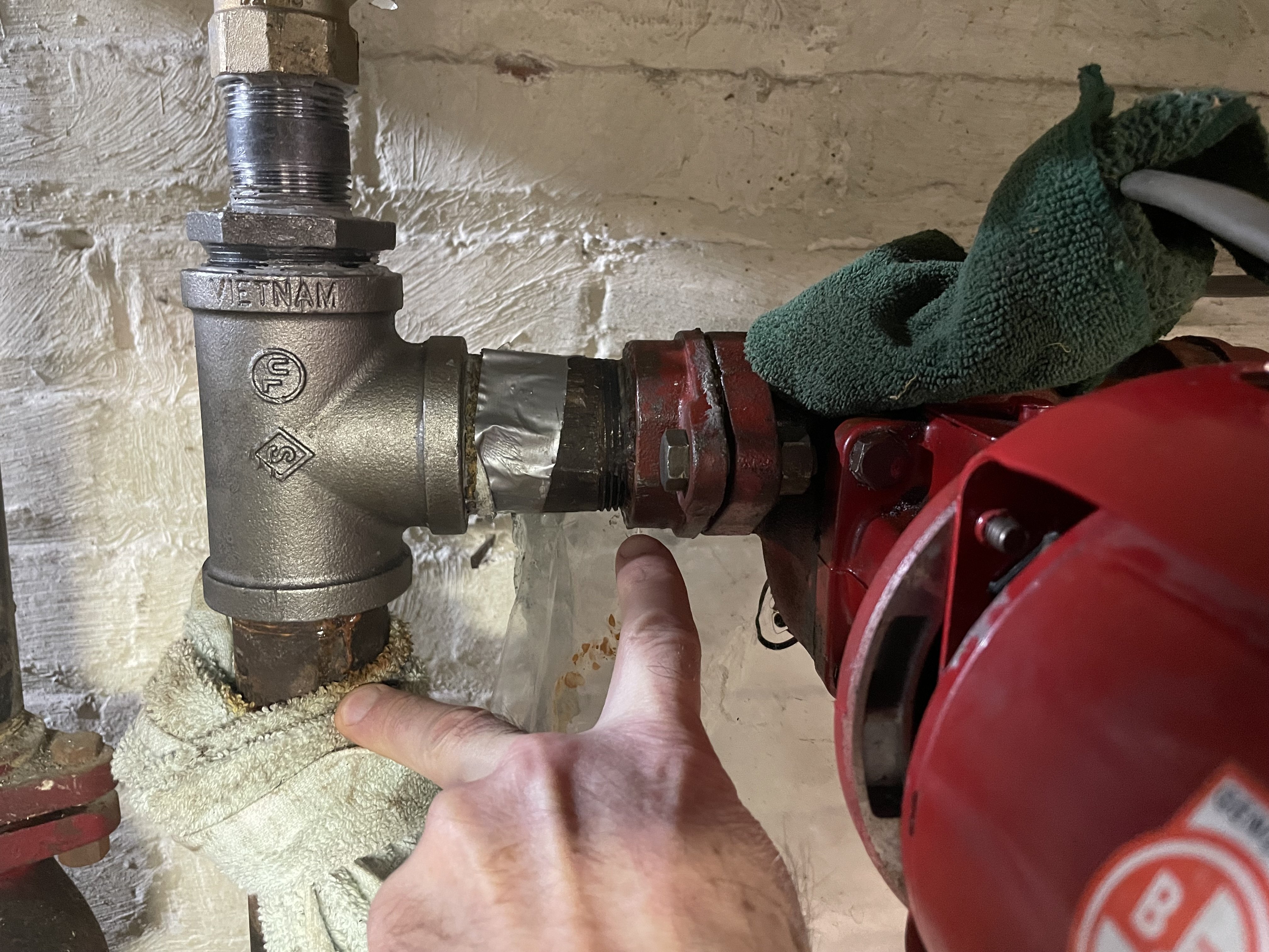

Today I noticed how much the leaking BG100 is leaking, nearly filled the ~gallon drip an under it. Looks like I will barely make it through this heating season before ripping everything out. I need to find the time to prioritize this.
I think we can live without first floor AC this summer while I redo the basement pipes. I need to consult the family on that first though. And then to decide whether to stick with the Unico or switch h to full duct work that might be better for aux heat (heat pump?) for the first floor.I may need to hire some pros, but I’m too damn cheap.
