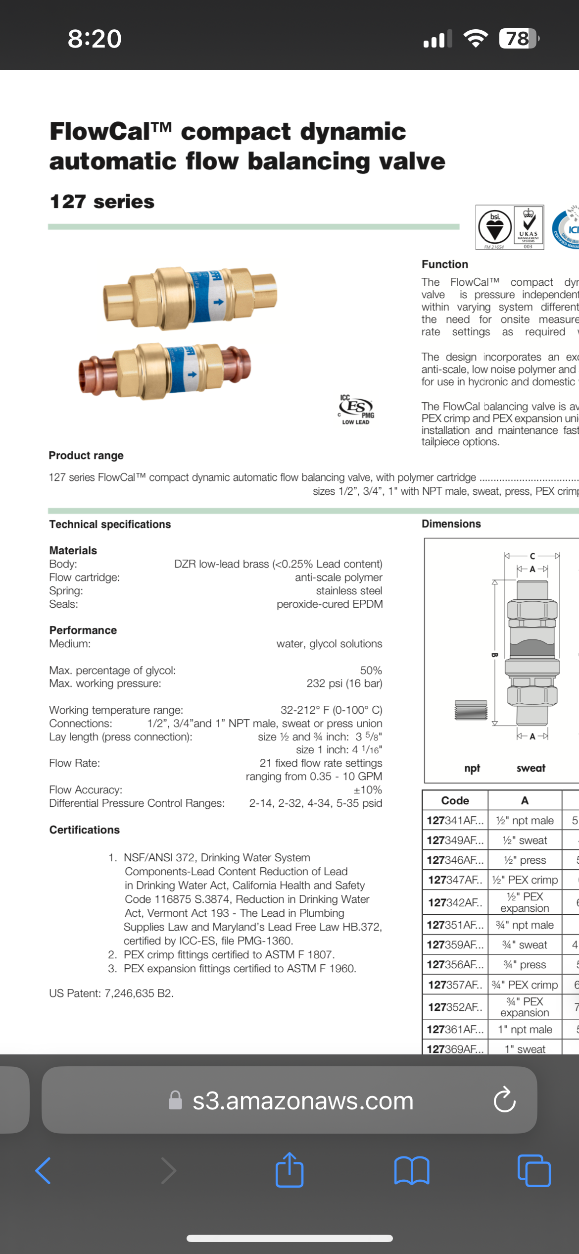

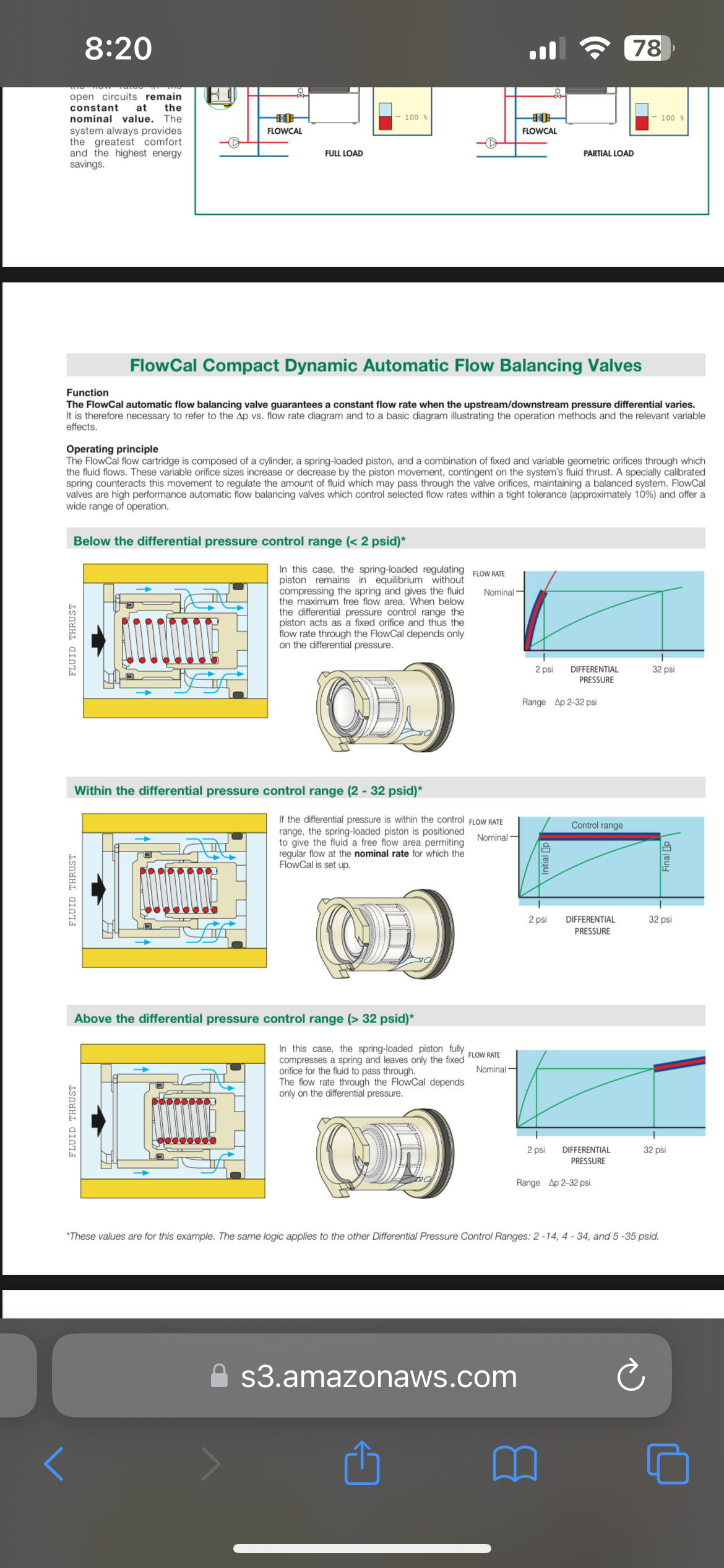

    hot_rod Posts: 28,769
    a PICV is a pressure independent control valve. A dynamic balancing valve. You order them by the required gpm. You could put them downstream of the solenoid
    They do have a pressure range they need to work within 2-32 psid for example. A Y strainer is a good idea also to protect them
    H2OBandit603
  • I would say the minimum flow would be about 6 gpm and max would be 15 gpm when it’s ramped up to 5 ton for making hot water. Any house water usage is added on. 6 gpm is like running several sprinklers. I’ve done several standing column geothermal wells that required large pumps, 3 HP, with low static levels, around 300’ and it’s feeding 3 heat pumps. Sometimes it’s only feeding 1 unit, systems run fine and the customers aren’t complaining about high electric bills. A 3 hp pump moving that kind of water at that depth is pulling about 2200 watts and they are seem very happy with the systems performance.
