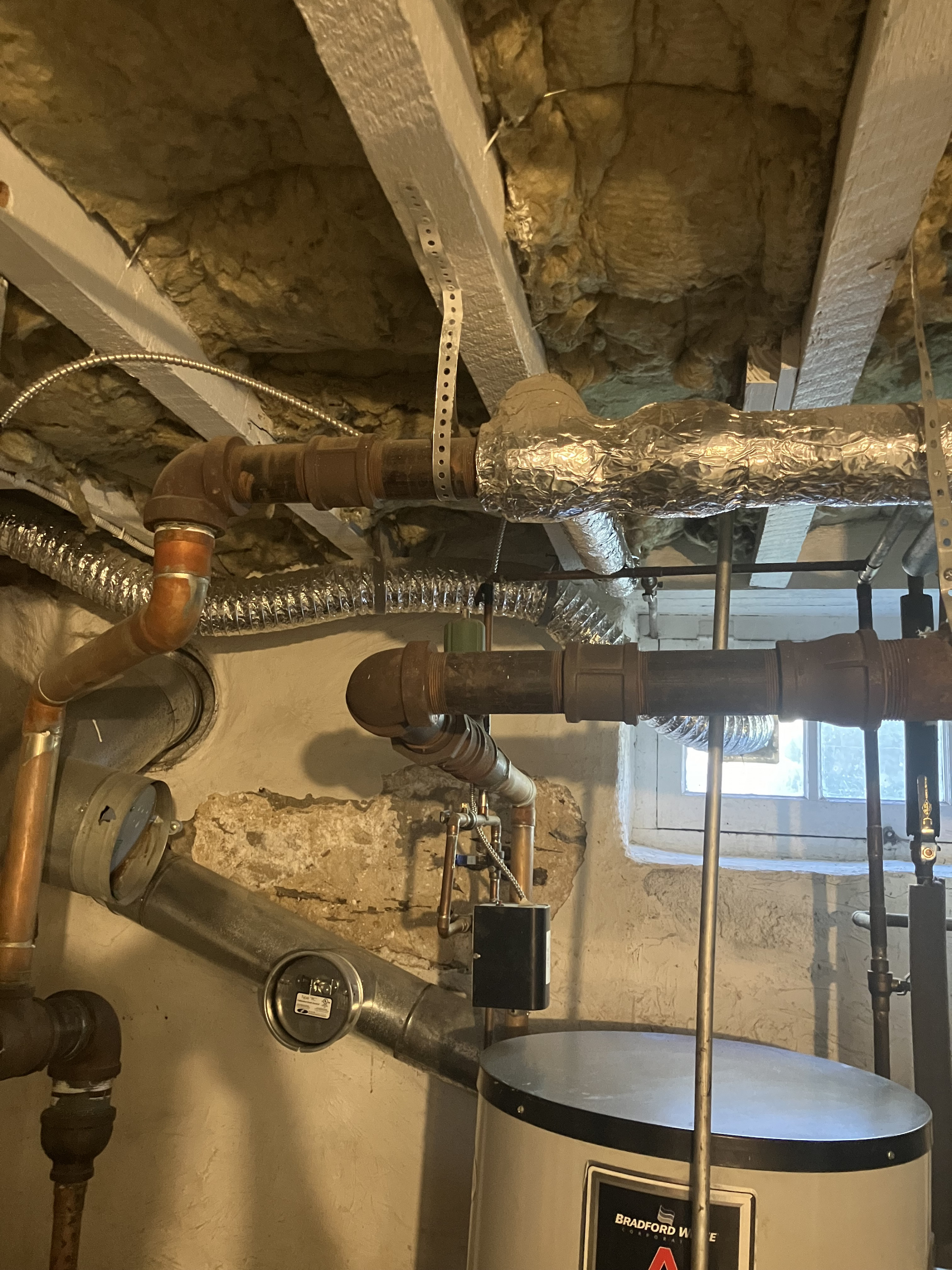

    what type of vent should I put at the end of a return line ?a gorton? What size?
    Jamie Hall Member Posts: 27,571
    What kind of "return" line? Some need no vent at all… some need a full size main vent…

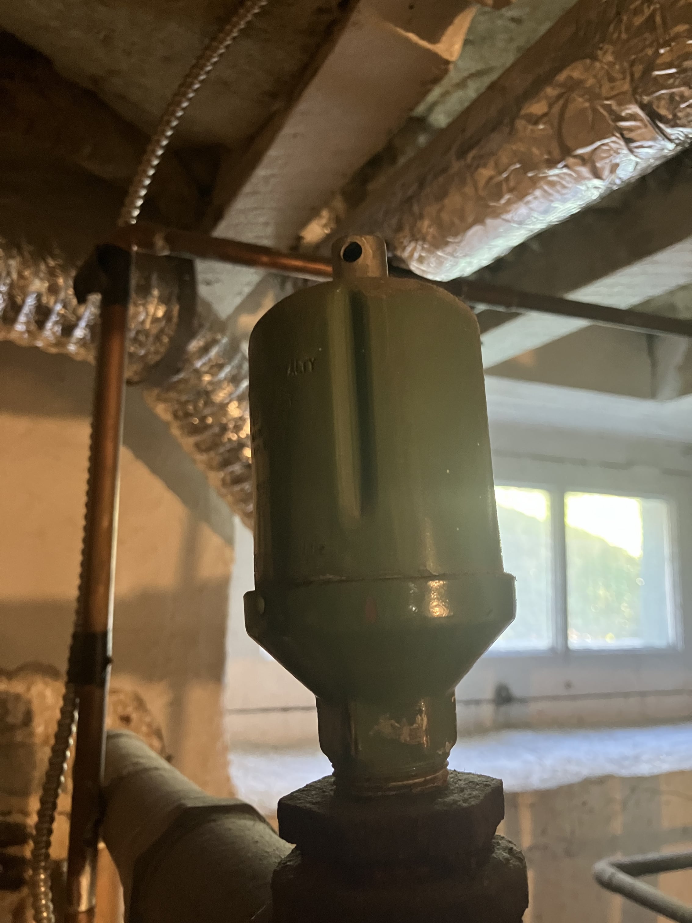

    thanks….it is a return line /cast iron…and right now there is a valve…. see at top upper right…valve is "green".

    ethicalpaul Member Posts: 8,927
    edited October 2024
    The recommended size depends on the size and length of your main. Your current one is a Hoffman which I think makes a terrible main vent in terms of bang for buck.
    One similar to that capacity is a Gorton #1 but depending on your main a Gorton #2 would be better. See this article by Gerry Gill and Steve Pajek
    What size and how long is that main?
    You seem to have a second main as well. Does that one have a vent?

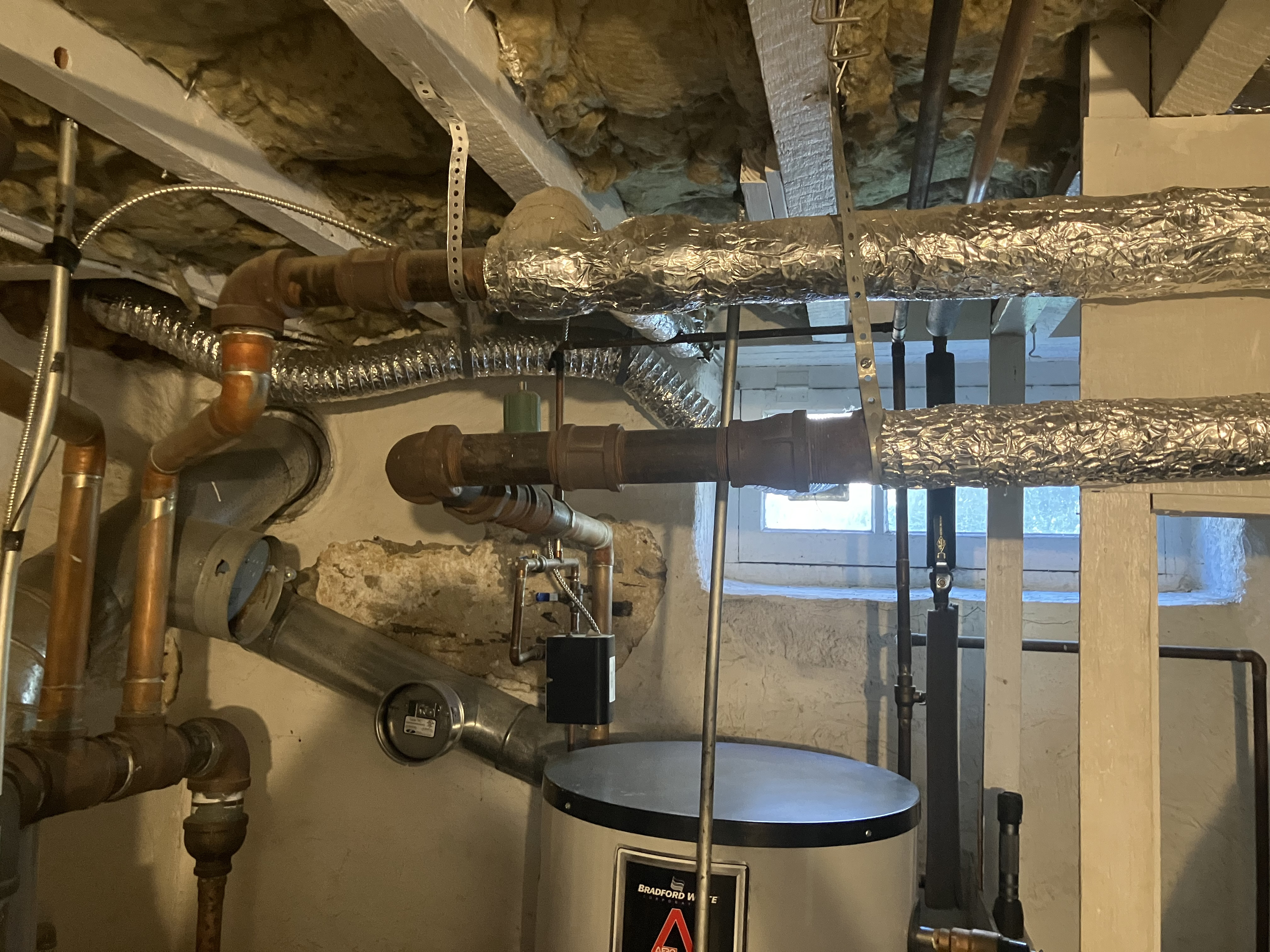

    thanks…..i think a unique system!…….one run handles all radiators except 3… that other run just handles 3 radiators (one on the first floor, one on the 2nd and one on the 3rd). the run that handles just 3 radiators does not have any return/valve. the main run about 85'….and i attached another photo…Hoffman 75 vent at the end of the main on that run. any insight will help! thanks
  • delcrossv
    delcrossv Member Posts: 2,204
    Both returns should have vents. for the short one with only 3 rads, the Hoffman 75 would work well on that. There's a convenient union on that one to place a tee with a riser for another vent.
    The other main, that runs everything else, should have a larger vent.(which should also be on a riser)

    ok….cant picture where to put that vent on the short one….piping from boiler for that short run….pipe heads off to the first floor radiator and then it continued to the 2nd/3rd floor ….see diagram…where would i put the vent?

    If it's just one outgoing pipe that doesn't come back, it's counterflow . If it just feeds the riser, I'd put a vent at the top of the riser before the 3rd floor rad. That way you can make sure you're not overheating the rad while getting the air out of the pipe.

    ok….is that why those 3 radiators dont seem to get hot unless i have temperature up high….and then it drops off when heat is on…is that because of no vent?
    delcrossvcanstaff
    Yes that is a likely cause. All the air in the main pipe has to be expelled through the radiator vents which can take some time

    Yep. and you don't want a big vent on the top radiator because that room will roast. Hence the two vents.
  • delcrossv
    And get some insulation on those copper pipes. 😉

    I inch paper backed fiberglass pipe insulation. The more you insulate the faster steam gets to where you want it (instead of heating the basement)

    question….see photos….so as a reminder….i had to mains from teh boiler…one did 98% of the house…and the other run….a quick run to a radiator on the first floor and off that run…it went to a radiator on the 2nd floor and one on the 3rd. you mentioned about putting a vent on the piping before the 3rd floor vent….can i try , before that, to add a vent on to that radiator on the 3rd floor. seems there was a spot for one….the reason is that both the 2nd floor and 3rd floor radiators off that seperate run dont get that hot and dont stay hot when they do. seems i really have to raise the temperature to get heat in them. see photos….
    On the vent on the third floor radiator. Keep in mind that vents on radiators control the performance of that specific radiator. Vents on mains — or risers — allow steam to reach the radiator rapidly.
    So… in this case, a vent somewhere on that riser — the closer to the top the better — will be the most help. A faster vent, or extra vent, on the radiator may help that one radiator, but isn't what is needed.

  • alanm
    alanm Member Posts: 149
    Just following up….so the main has about 85' and handles 15 radiatorsh…right now there is a hoffman 75 main vent…i dont know or can tell if workign or not…or if that could be causing some problems…with this size….should i replace with the same or something different? thanks
