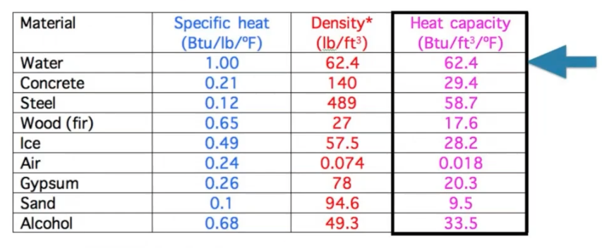

    The most recent Coffee with Caleffi webinar talks about thermal storage and a bit about phase change tanks.
    https://www.youtube.com/watch?v=BDspXgtzLZU&list=PLuuV0ELkYb5VE0I4evUZ30b5U78CRlRdg&index=2&t=3926s
  • @hot_rod ha how is that chart accurate? Of course the ice phase change stores more energy than water. Not that it makes sense for most residential installs either way.
  • DCContrarian
    DCContrarian Posts: 1,602
    It's for ice kept in solid phase. If you change phase from ice to liquid ice has about 180 times the heat density of water.

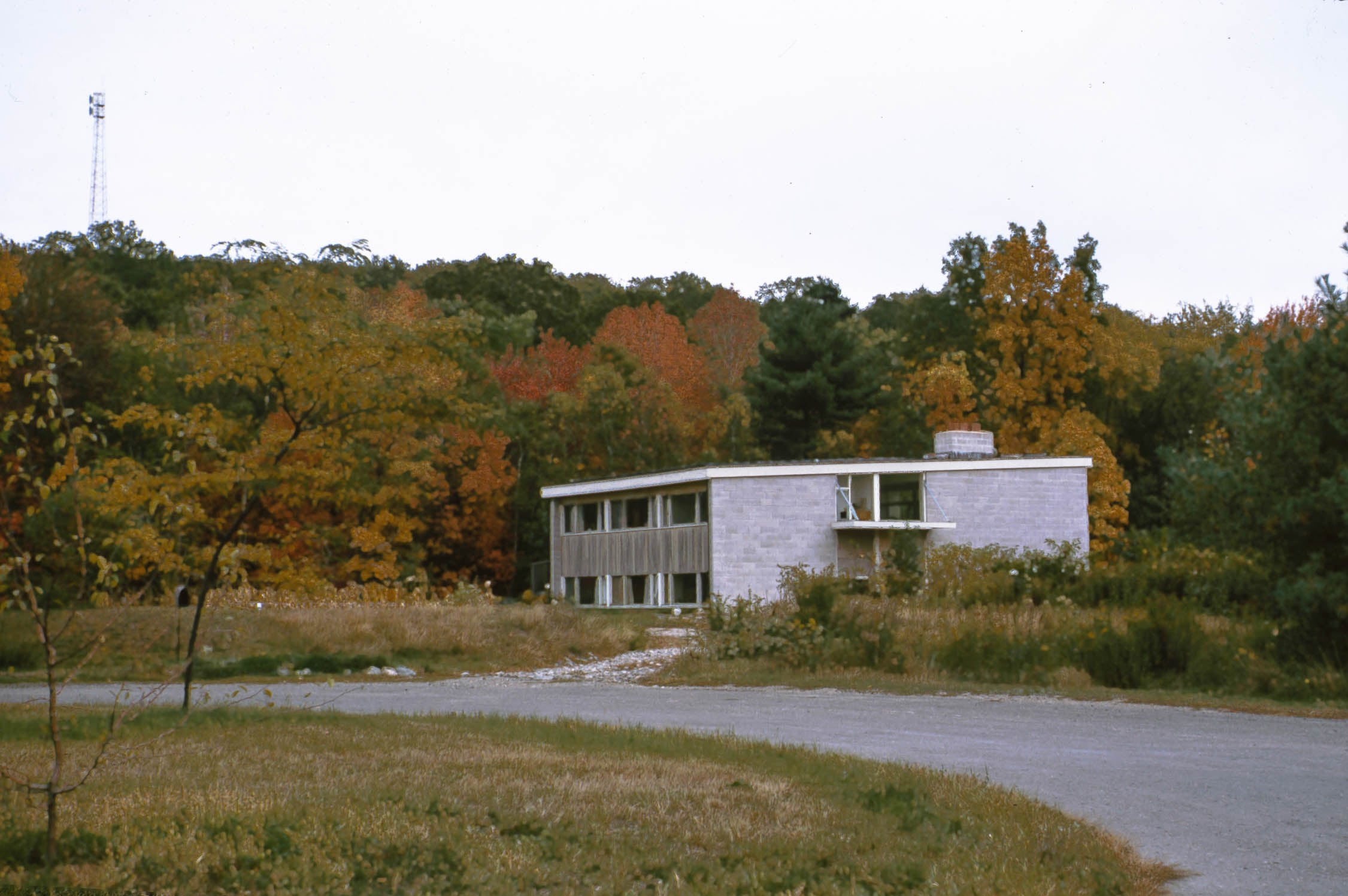

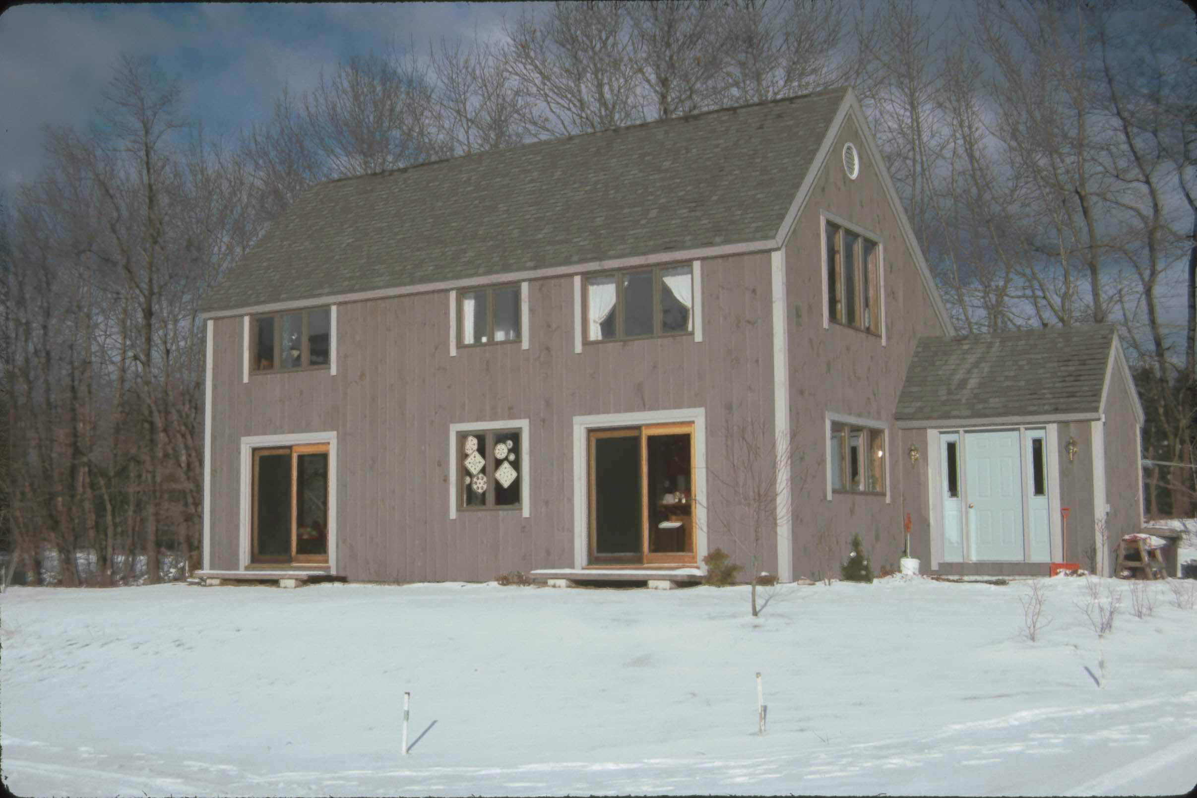

    Um… well, I beg to differ. @DCContrarian . Here are two houses, both of which I was involved with building, both of which I have lived in, and both of which did a fine job of "self-modulating
    There are two others I'd love to show — the Winterkeeper's House on Star Island, and the Shrewsbury House, but I don't have good pictures of them.
    But I suppose I'm deluded, and they don't work, and I'm just imagining things…
    And I might add, since no one seems to believe me (or my father-in-law, or Bill) I can see why they lost interest in discussing how it was and still can be done. Sorry.

    So Jamie, I want to make sure we're not talking past each other. The second one looks to have a quite large chimney coming out of the roof, with what looks like several flues. Is passive solar the only heat source or does it complement something else? Because if it's the second I have no doubt that it contributes to the heating of the house.
    It's when you try to build a house where passive solar is the only heat source that the numbers just work against you.
    Jamie Hall Posts: 28,056
    edited October 2024
    Building codes and mortgage bankers are queer cattle, @DCContrarian , and where that second house (the salt box) was built the code required (and still requires) that there be a more or less conventional heat source in the structure which meets their computed heat loss requirements — or no CO or mortgage, both of which are useful.
    Neither the building inspector nor the bank agreed that passive solar heat would ever work…
    So yes, there is a chimney in that house, with a flue. And there is a nice big Jotul stove in the living/dining area. In the ten years after we built it, we used it once per year, just to make sure it worked each year (the current owners don't bother). Otherwise the stove was and remains completely superfluous.
    Now as it happens that nice big chimney, which is mostly solid masonry, is also part of the passive solar design (it's part of the heat storage "system") but with a mass of upwards of 40 tons, it better be passive… It didn't have to be there, but since we had to have a chimney and stove and flue, why not work it into the architecture?
    And I agree, if you try to work against the physics, it will defeat you. If you work with it — as we did — it helps you every time.
