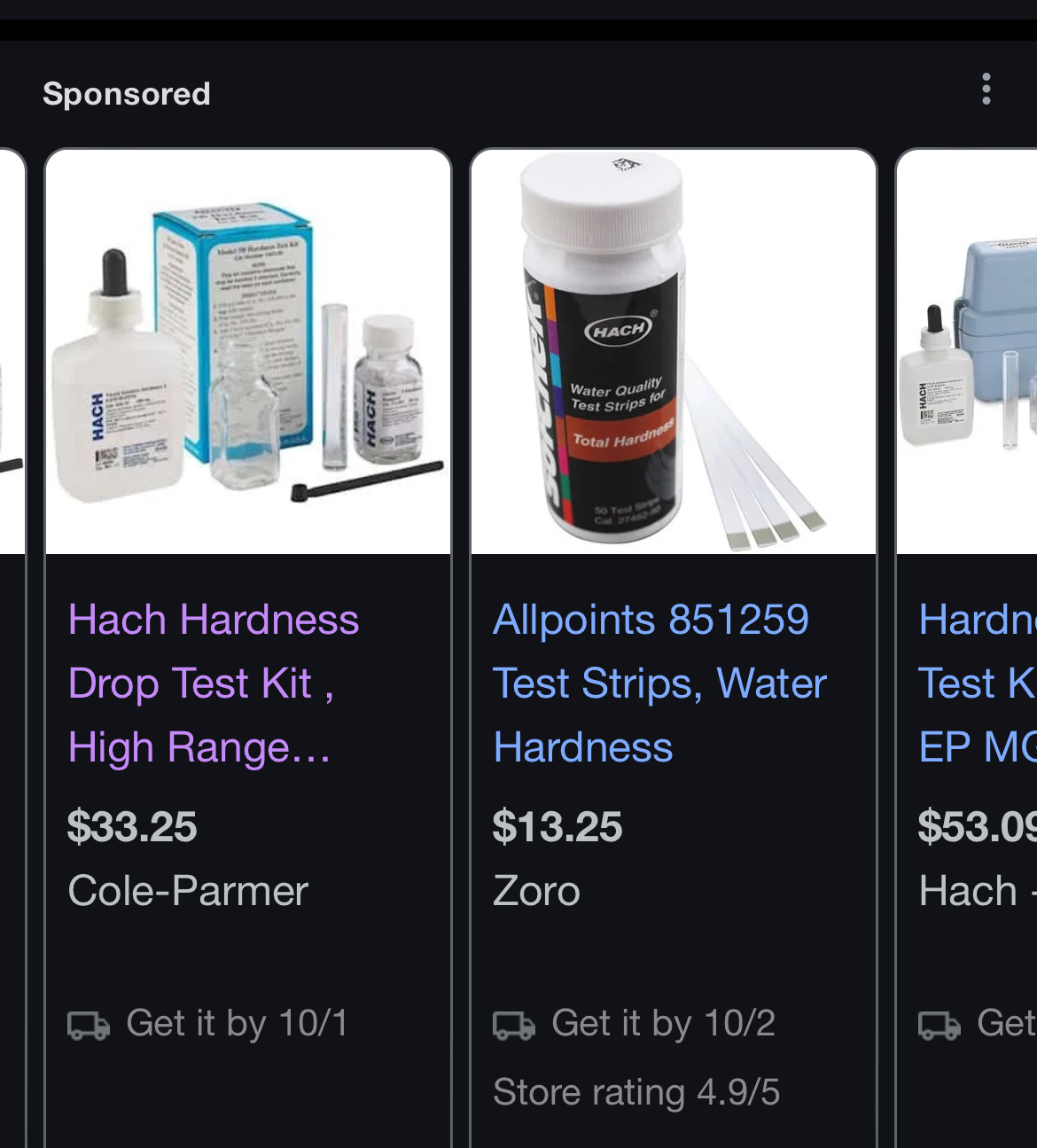

test kits or strips are fairly inexpensive
Most manufacturers suggest hardness in excess if 7 grains needs to be addressed
