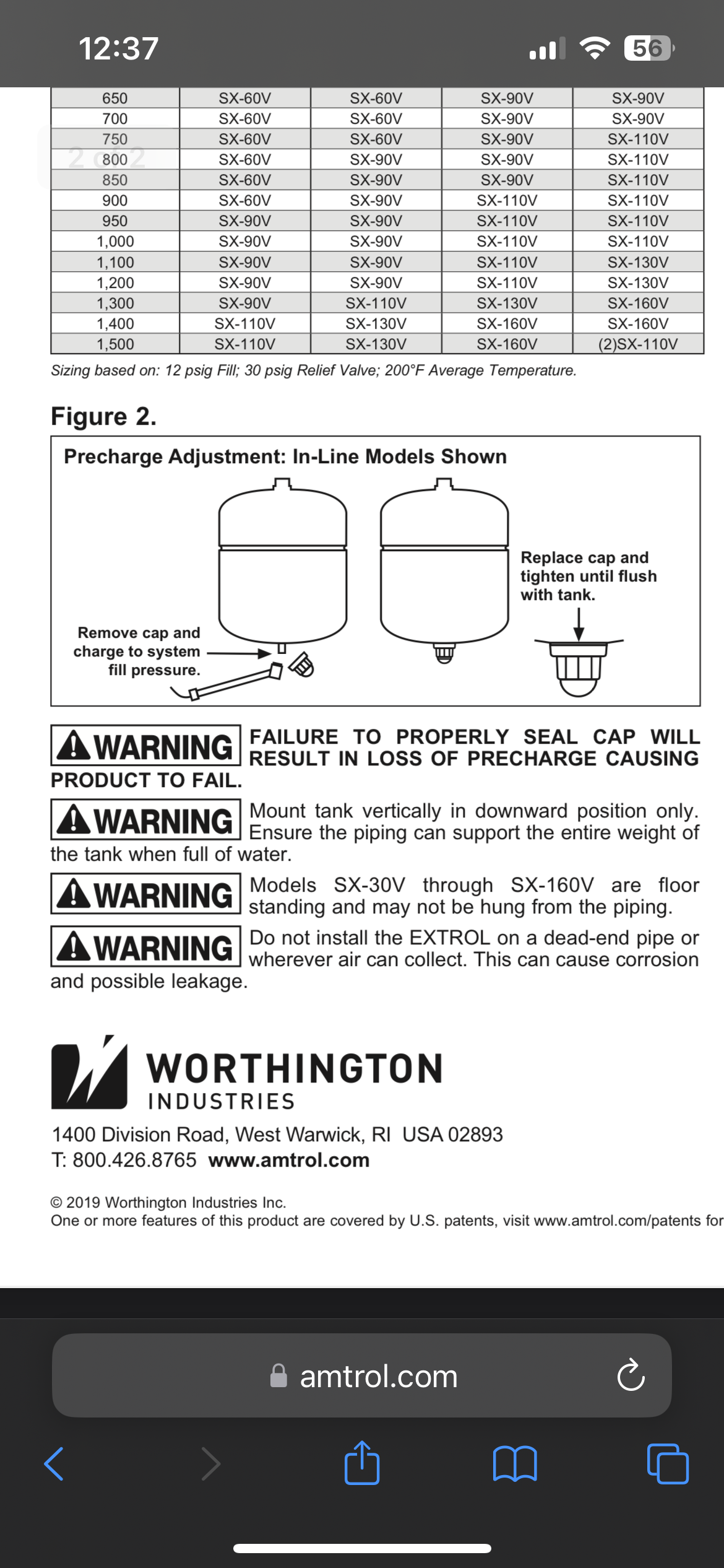

Seven years ago I pretty much re plumbed my entire heating system. I also have limited space so a lot of stuff is crammed together. I did not have the space for the expansion tank so I hung it from the ceiling. Looking at the directions for mounting the tank it is currently not installed correctly. it is also now leaking so I need to replace the tank. I also don't see how I can install it from the ceiling and follow directions. My old tank hung from the ceiling for 30 years with no problems, this one lasted 7 years. I still have the old tank and the frame work for mounting. The new tank and the one I am currently using is a Amtrol EX-60. Is there advantages for the new style tank or should I just go back to the old style?

    I wish I would have understood thing better years ago when I undertook this project. Extrol shows nipple down and water at top of tank. It makes more sense to have water at bottom of tank. I believe that was what you suggested. I do not have the room like Ironman shows or I would have put this tank lower somewhere. I have in the system what I think is called a hydraulic seperater, they have an air purger at the top so as EdTheHeaterMan said I can't put the old tank back in use. It looks like I need to rotate my tank so water is down and keep an eye on the air pressure in the tank. To do a replumb job as extrol shows would be a tremendous job and I am not up to it. Is it possible to remove what I am thinking you called the nipple and put in a pipe and a 90 and re plumb it a little to make it easier to add air if needed?

    That is the best way to position that tank. If you invert that tank so the labels are upside down, you may find that the tank fails sooner. I don't think the manufacturer places the labels upside down on purpose. I believe that labels are placed on those tanks properly and the water is at the top and the air is at the bottom by design. A few will say that it does not matter, but if you ask the manufacturer, the preferred installation is the water connection at the top.
    Annual maintenance should include checking the air pressure in that tank at the beginning of each heating season WITH A PRESSURE GAUGE. Add air as needed. just putting your fingernail on the Schrader valve to hear air come out is the exact wrong way to test that tank. All that does is let more air out. and you want the air to stay in the tank. common knowledge is that the membrane will allow some air to pass thru over time. and that can lower the empty tank air pressure by as much as 1 PSI per year, and that fingernail test will lower the pressure even more. after a few years of that, your tank will be undersized. Adding air pressure may fix it if the membrane has not failed by the time you figure out that you have a problem.

    I’m not sure how to avoid dead end piping as Amtrol suggests,

    The tank is not installed as suggested by other comments and by Amtrol. I am defiantly going to install a union. I though of the water also. I have installed a piece of metal to the top of the hanger and put a rope through that and tied a rope to the tanks pipe on top. I should be able to ease the tank down with that. A big disaster would occur if that tank fell. Thanks for the tip
