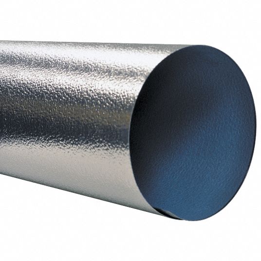

    4. Insulate it and cover it with a metal shield, no boxing required. The metal shield protects the insulation and adds some appearance. You can paint the metal if you want. Pretty common in commercial/industrial buildings with steam.

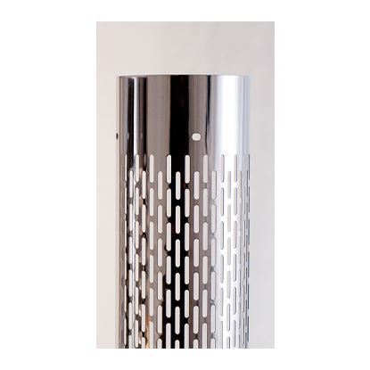

      And a last option is to paint the pipe and leave it uninsulated. If you are concerned about a child or animal burning themselves you can get a pipe protector. Typically used for exposed gas dryer vents, pellet stoves, etc. They usually come in 4ft sections.
