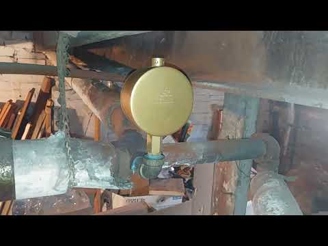

No one is responding, so I will:
1. It doesn't matter much honestly. Anywhere around the end of your mains is fine. There is this idea that there is a "slug of water" that slams down the main when steam starts to be produced. This is a myth so just put the vent somewhere. Raising it a little above the main is fine if you have room. It doesn't hurt.
2. Your mains are quite short and obviously insulated. I would put a Gorton or Maid O Mist #1 (they are basically the same) on each one.
3. If there's not a reducing tee or other handy fitting hiding at the end of your mains, then I'd have a couple feet of asbestos removed from the end of each main, and then drill and tap a 1/4" NPT hole in the top of each pipe
4. Try https://heatinghelp.com/find-a-contractor/
Is it worth doing? Hard to say. I'd say it depends completely on how much it will cost to touch that asbestos. 10 to 20 minutes from start of call for heat to receiving steam at your radiators doesn't sound bad. Is it 10 or is it 20?
Also it depends greatly on how much time has passed since the last call for heat. A main has to be heated to steam-hot in order to let the steam pass, regardless of venting and that takes time.
To get a better idea of the actual time your system takes to clear the air out, have it do a call for heat just a few minutes after a call for heat ends and all the radiators are nice and hot. Remove a vent from your closest radiator and see how long it takes for the steam to appear there. Even that can be misleading since your radiator, no matter how hot it is, will still condense steam so you might not see it come out until some time after steam has reached it.
It's just a lot easier to time this with an existing main vent which you don't have of course.NJ Steam Homeowner.

@ethicalpaul said, "drill and tap a 1/4" NPT hole in the top of each pipe"
I assume this suggests the vent be threaded directly onto the main or a fitting or two be added then the vent.
My question is, "Does tapping the main meet code?" I'm not a student of the codes, so I don't know. I also recognize the temperature and pressure, under normal circumstances are pretty low.
Maybe a saddle tee with an appropriately temperature, pressure and steam rated gasket is allowed.
Steamhead shows us how he taps a cast iron tee for a Gorton #2 main vent.
https://youtu.be/vgiDA6ufbmk All Steamed Up, Inc.
