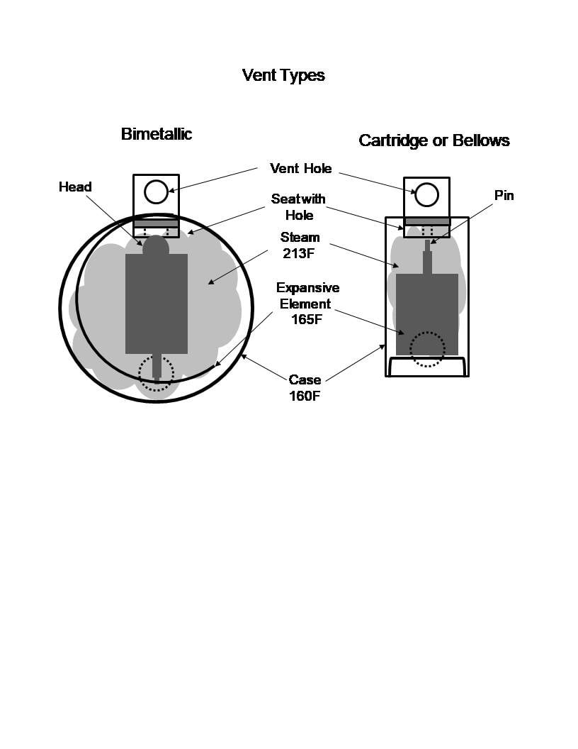

Each vent regardless of type has:
1] Input opening
2] Case or Housing
3] Seat with air port
4] Pin/head and float
5] Thermal element
6] Output opening
[See Vent Diagram]

2] Closed position:
The steam and or heated air entering the input will heat up the case and the thermal
element attached to it. This transfer of heat will cause some of the steam to condensate
and flow back through the input opening. The case and thermal element will heat up to
a higher temperature. The thermal element will expand forcing the pin / head into the
seat with enough force to close the air port and preventing steam from escaping. In the
case of a bellows system, the expansion and force is determined by it’s volume and the
amount of and type of chemical [usually alcohol] contained in it. In the case of a bi
metal system, the expansion is determined by it’s length and the closing force is
determined by it’s thickness and with.

    It can't. This has to do with understanding on what goes on in a radiator, mains and vents. I will explain this at a later date.
  • Correction, I should have stated that it can. Here is why: see diagram
    1] When steam enters a vent or any closed metallic container, the temperature of the steam is determined by the pressure in the container
    2] The steam will make contact with the walls of the container or case and transfer heat to the case resulting in condensation and an increase in the case temperature and indirectly the expansive element [bimetalic strip, bellows or cylinder]. The temperature of the case and expansive element is determined by the thermal conductivity of the metal case, case thickness, steam temperature and air temperature. I have measured a 3 to 5 degree difference between the case and expansive element.
    3] The case temperature must reach a level that will heat the expansive element enough to make the head or pin contact with the seat opening and do so with enough force to keep it closed under pressure [negative or positive]. This is determined by the coefficient of expansion and mass [or thickness and length] of the expansive element.
    So the steam can be at 212F or 216F and the vent will fail to close because the expansive element is not hot enough or will not stay hot enough. I have tested vents with cylinders that would cycle open and close because the cylinder or bellows would close, lose heat through case convection, then open letting in more steam heating up the cylinder causing it to close. This would happen anywhere from 2 minutes to every 25 seconds.
