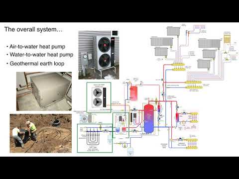

    Curious to better understand why I would need a buffer tank between the heat pump and the primary loop. I mean, the propane boiler doesn't need/use one? Why can't I just hook up the heat pump supply & return to the primary loop directly?
    It has to do with the way heat pumps run and are controlled. Heat pumps work best when they run continuously at a constant output and if they have a modulating compressor they can match the compressor speed to the load and run continuously. An air-to-water heat pump will have a variable speed compressor and variable speed circulator, and the control electronics will try to modulate both the compressor speed and the circulator speed so that the water leaves at a fixed temperature and returns at a fixed temperature. If the return temperature starts dropping it will turn up the compressor to produce more output, and turn up the flow to maintain the temperature differential.
    If the return temperature starts rising it slows the compressor, until it gets to the minimum modulation, maybe 25% of output, at which point it starts cycling the compressor on and off. The circulator keeps running, so that the compressor can tell when it's time to cycle back on again.
    On the inside of the house, thermostats turn zone valves on and off to regulate the temperature. Since the circulator has to run all the time, there has to be some place for water to run when all the zones are off. That's what the buffer tank is for. Compressors typically have a minimum run time, the buffer tank also serves to soak up capacity and prevent short-cycling.
    It's not conceptually that different from the way boilers work, where thermostats control the zone valves but it's the aquastat and the water temperature in the boiler that controls whether the boiler fires. Boilers typically hold enough water that they effectively act as their own buffer tank.

    I think that the buffer is required to keep the heap pump from self destructing from short cycling.
    This is very informative.https://www.youtube.com/watch?v=CVXGMuB8wlU
