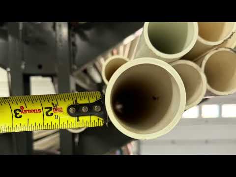

It occurred to me that lots of trades guys don't use this simple formula, I hope this sheds some light!
https://youtu.be/XZ0tFsXNf5w?si=exq6f_kQbqgEG5xr

    I like his insertion math. I was taught to measure center to center and subtract to the bottom of the socket. This seems easier and more accurate.
    On one of my plumbing licenses test you had to calculate two parallel offsets, then build with 1" copper and solder them.
    They cut the solder joints apart to check for soldering skill also.

    I have used 1.414 for years and it is absolutely accurate if measurements are accurate.
    Most of my co workers wouldn't use it they just hold a fitting up there and guess
    That is fine but if your using it for large size pipe 3," and larger steel pipe it becomes impossible to hold those heavy fittings in place to get a measurement. You have to use it by calculation.
    I also have a method of measuring for using it with a rolling offset that is simple and works great
    I can remember doing a rolling off set in a hallway with 3" threaded gas line. There was literally no play to move the pipes it worked great.

    I went back and looked and I am pretty sure the math is correct. I was trying to show 2 ways to get the answer and probably overcomplicated things. I tend to do that a lot my brain runs faster (or slower) than I type or draw.
    One way is to think of the offset as a 45 degree triangle. A squared + B squared =C squared. C squared is what you need that is the length of the 45 degree pipe. Once you get C squared you x 1.414 and then make the fitting deductions as usual.
    The other thing I was trying to show is how to figure out a rolling offset. If you can get a C-C measurement then you just treat it like any other 45 degree offset.
    What I used to do when I couldn't get a C-C dimension easily is if you can picture two pipes heading for each other that need to be connected by a rolling offset is
    1.get the center line measure for each from the floor or ceiling and subtract the two measurements to get the height difference. Then measure from a wall and get the two center line dimensions and subtract them as well to get the horizontal difference.
    Now you have a height difference and a horizontal difference. See the new drawing attached

    Im getting 19”
    do you still need to draw it out?
    Sq root of 181 is 13.45, x 1.414 is 19

    Answer looks right. So you can get the same answer 2 ways. The triangle method like you did A sq +Bsq=Csq etc.
    Or draw it by marking the two pipe centers on the floor or on cardboard etc then draw the line between the two centers. Then measure the line you drew with a ruler take that measure ment and x1.414.
    This is how I usually did it on the job just draw it out and measure the line and do the 1.414. Faster than the triangle measurements.
    My drawing is not to any scale so you can't actually measure it it's just for show
