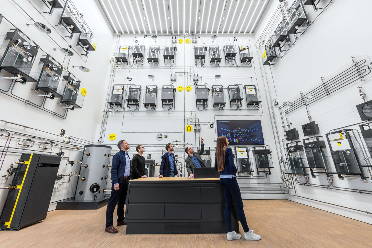

    I Agree with the Chlorinated/high temp/Flow restrictions..
    After my 2023 ISH visit we toured with Viega at the new training center "Viega World"..
    They had a display on how to properly design domestic distribution/recirculating systems without allowing the formation of legionella yet conserving energy and water.
    This display would go into a flushing cycle at which point every fixture was sanitised.
    Image of display:
    https://web-assets.viega.com/is/image/viegaprod/EX_ViegaWorld_Prevista_DE_2022_001-1?$700$
    Viega also has a Special concentric fitting for domectic recirc lines (Pipe within pipe).
