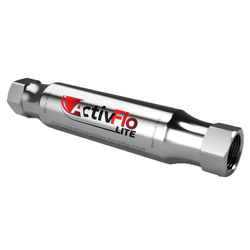

    It would be interesting to try one of these conditioners
    I think RO or DI water would be too aggressive. An ion exchange water softener not  quite enough removal?
    supposedly these devices keep minerals in suspension  and they flush thru
    https://www.zilmetusa.com/zproduct/activflo-lite
