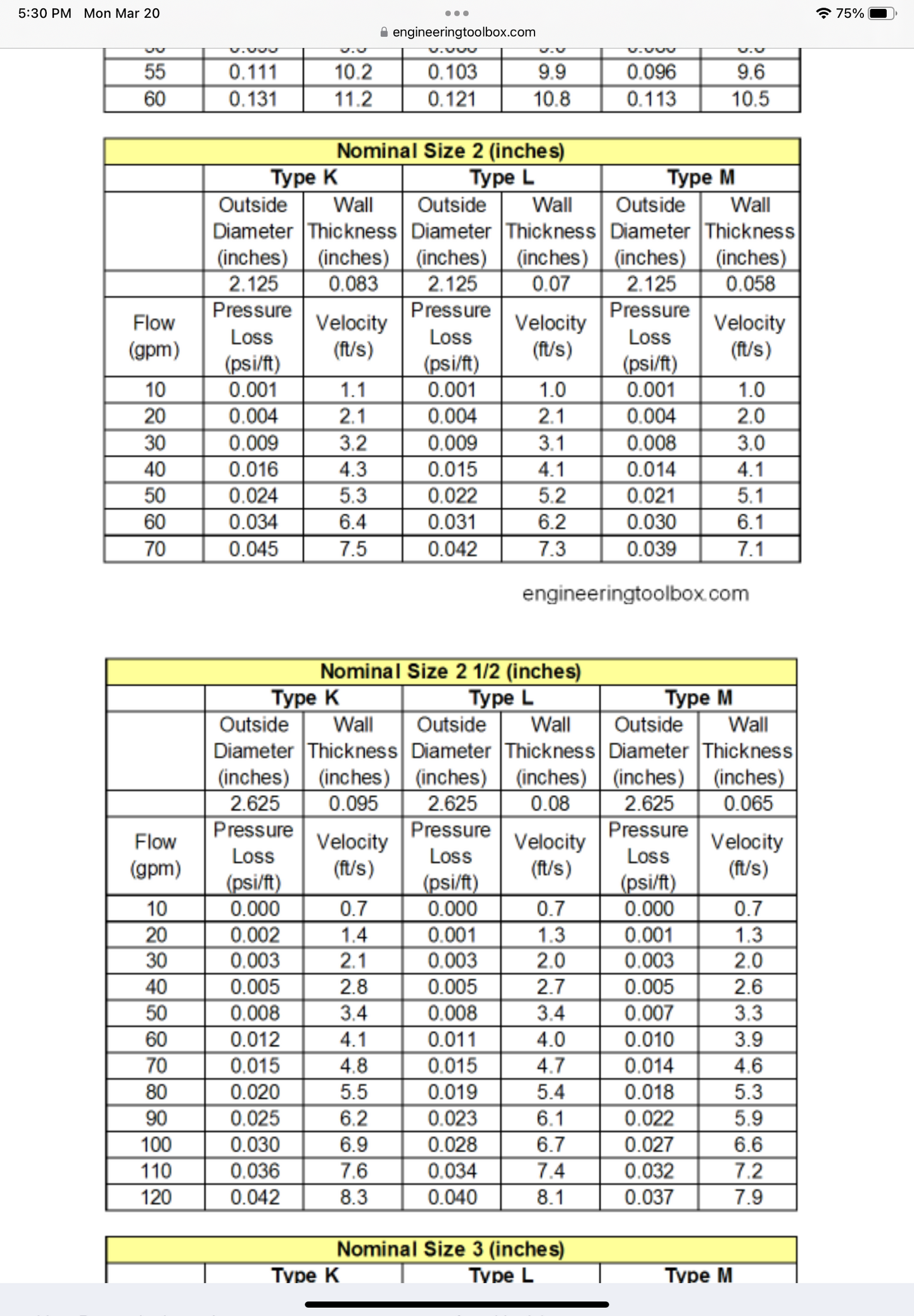

these tables are more accurate as they are for different types of copper. Some of the tables out there are conservative, rule of thumb. These are based on the engineered flowrates.
2" copper L, should be fine flowing 30 gpm, assuming it not 100' long🤔

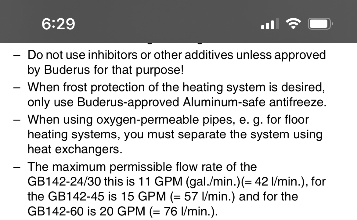

Looks like you model could handle up to 20 gpm. I don't see a pressure drop chart in the manual. I doubt that 15-58 can move 20 gpm?

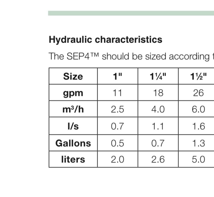

Here is the sizing chart for the Sep 4. You might go with the 1-1/4 if you think you need 15 gpm or more.

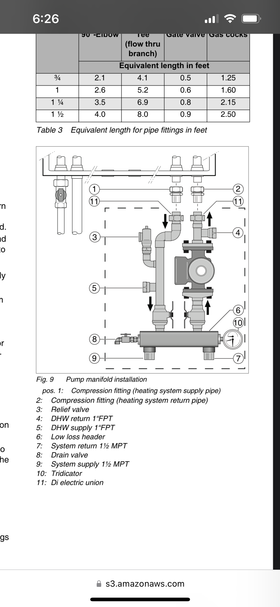

the low loss header kit they sell looks to be 1" pipe size, so?Bob "hot rod" Rohr

Thanks for the copper tables - want to make sure I get these headers sized right. The table’s Type M copper numbers seem to agree with the 20 gpm @ 2 fps and 30 gpm @ 3fps for 2 inch that I was working with. I modeled the house in the loopcad software and it seems to indicate that the design day scenario worst case (5 degrees outdoors, 70 indoors, 10 delta t for floors) would be 23 gpm total for all 5 circs with individual circ heads ranging from 5 to 13 ft. The headers will only extend 5’ out of the side of the 4 pipe buffer tank.
Do you think the 2 inch header will work for these 5 circs at the same time in this case?
23 gpm in 2" type M would be under 3 fps, that should be fine.
I would go with an 1-1/4" sep if the 23 gpm is accurate.
