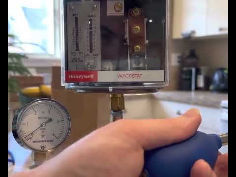

Brand new Vaporstat doesn't seem to work - pigtail question
I just got a brand new 16oz Vaporstat to replace one that seemed to have failed, but now I am wondering if there is something wrong with my control tree setup. Here's the issue: I set the Vaporstat to 2oz of pressure, but the boiler will get up to ~18oz. If I set the Vaporstat to 6 oz of pressure, it will get up to ~22 oz. So, roughly 16oz more pressure than it should be. I have measured the boiler pressure with two methods: A 32" WC gauge attached to the same control tree as the Vaporstat, and a manometer attached to the sight glass drain, which should be 100% accurate.
The Vaporstat is what is controlling this pressure -- I know because I have listened to it with my ear against it as the pressure rises and falls, and it's clicks correspond to the boiler activating and deactivating.

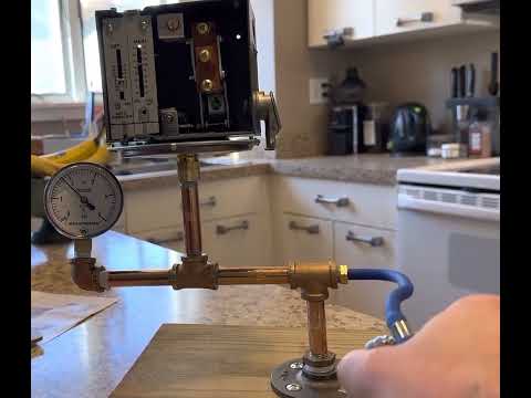

I am in the process of building a bench testing rig to independently verify what pressures at which the Vaporstat activates, but those parts won't be here for a few days. In the meantime, the support team from the Honeywell distributor suggested that the amount of air gap between the water in the siphon loop and the vaporstat may have an effect. Does anyone else have any thoughts on this? Should there be no air gap at all in the nipple leading up to the Vaporstat? Does it matter at all?
The control tree is filled with water, and no steam gets up to the controls and gauges. I have verified this by confirming the nipples leading up to the controls are room temperature.
Some pics are below. Thanks in advance for your help!

    Hello @Fdarby82,
    The water in the pigtail, or in your case the "control tree" pipes does bias the readings. In my case it is only about 0.25 Water Column, the boiler is the higher pressure. If you really want to know if you are playing with junk controls connect your Manometer right under the new Vaporstat with a 'Tee'.
    The pipe connection to the Vaporstat is air tight ?

    mattmia2 Member Posts: 16,647
    1.7 inches of water is one ounce per square inch so if there is an air leak and some of the nipples are filling with water and some are not, the weight of that water could cause an ounce or 2 difference between devices but not the 10+ oz/square inch you are seeing.
    You do need some sort of sealant on the threads, even at that pressure they are likely to leak without something to fill the valley of the threads (but I don't want to start that discussion again).
    I'm not sure what happens if an air leak means water is getting to the diaphragm of the controls.

    I figured out another way to test whether the water in the control tree is biasing the readings -- I swapped the 32" WC gauge and the new Vaporstat, and I am getting the same results. The 32" WC gauge continues to work fine in the Vaporstat's old position, and the Vaporstat continues to let the pressure go to 18oz+ when set at 2oz. So, I think I'm satisfied that my Vaporstat is bad.
    That test to me only proves that the control tree piping is not plugged. If the Vaporstat pipe fitting still leaks in the other location it still would not work properly. The Manometer connected directly under the Vaporstat verifies the pressure that the Vaporstat is actually seeing.

    I think I see what you mean.... but if there was an air leak in the Vaporstat connection to the nipple, wouldn't it eventually consume the air bubble in the nipple and either stop when the water well comes up to the Vaporstat (due to the higher viscosity of the water than air), or wouldn't I see water leaking out then?

    I appreciate the advice... I'm going to be removing these and reseating them with sealant. Better safe than sorry on that, as I guess if there was a leak, the water well might drain out through it and eventually expose all those controls to steam.

    Try moving the manometer test point up to just below the vaporstat and see what that reading is.
    Bob
    I'm building a bench test rig, so hopefully this will answer any questions about functionality of the controls.

    Here's a video of the 16oz Vaporstat which I'm returning. It's set at 10oz, with about 8oz differential. Besides the "clicking" sound I expect to hear when it hits pressure and returns under the differential, there's a distinct sound of metal popping, like a metal diaphragm flexing forward, then backward. I don't think that's supposed to happen, right? Anyway, this part is being returned, but if anyone has input about the popping sound (not the clicking on pressure, the separate "popping" sound), I'd love to hear it!
    https://youtu.be/onMgSHqt3kY
  • GBC_illinois
    GBC_illinois Member Posts: 104
    edited February 2023
    New vaporstat is here! I already had the bench test setup ready, so I tested it before installation, and it works exactly as I expect it to. It doesn't do the metal "popping" sound like the one I'm returning does. Video is below. If anyone knows what the metal "popping" sound is, I'd love to know. Next up after this: Bench testing the old pressuretrol which serves as a secondary pressure controller before the high limit cutoff. I suspect this is not working at all, but we will see!
    https://youtu.be/4Bs36rkVUgg

    Pressuretrol bench test. We had an old pressuretrol as our secondary pressure controller, in theory it would cut out before the high limit cutoff. But, even though it was set to minimum with a minimum additive differential, it still doesn't cut out until after our high limit control does. So, it's working, but it seems like 3.2psi is just the minimum pressure it can cut out, which is much higher than I thought, given it's settings.
    Here's the vid:
    https://youtu.be/bDRyU92p-4o
