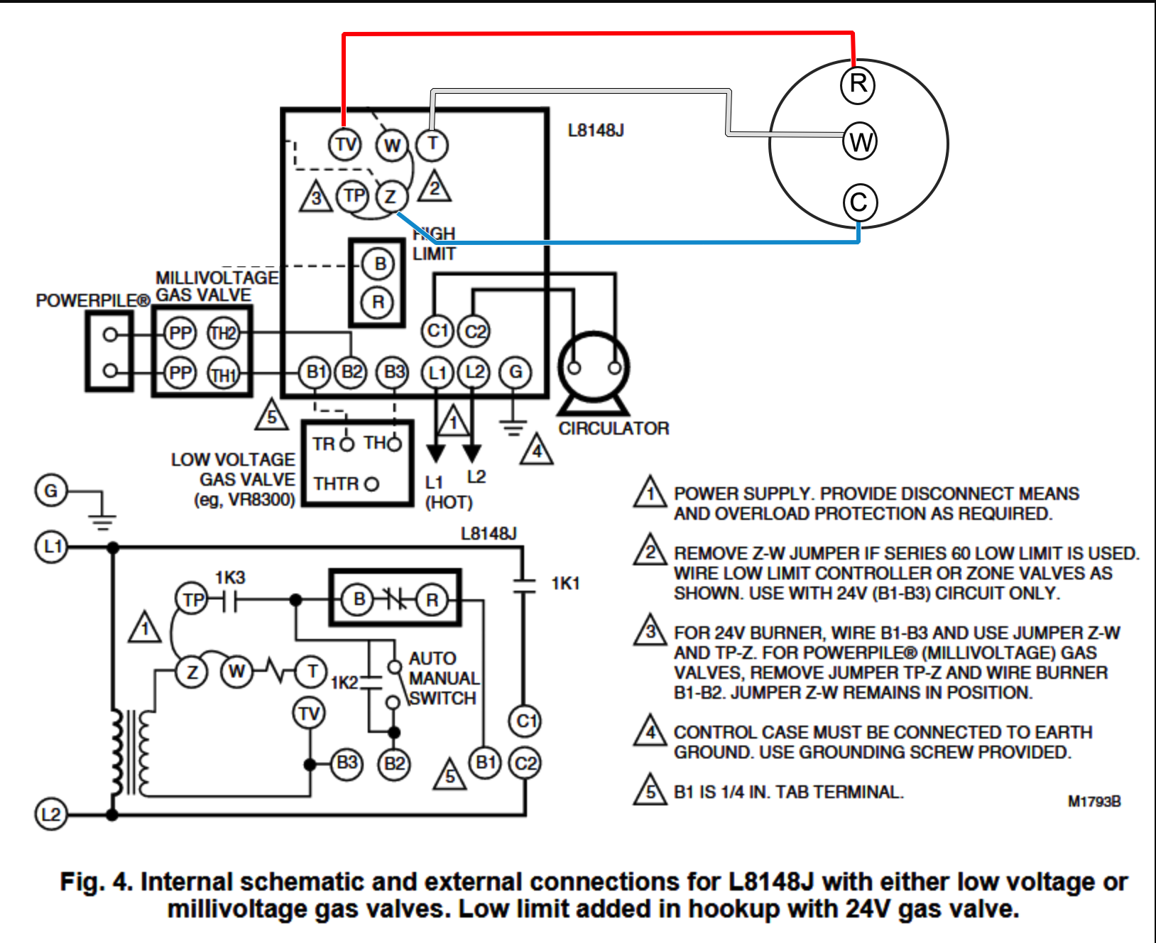

Which is the C (common) terminal on a Honeywell Aquastat L8148E?
I need to install a Nest Power Connector to my Honeywell Aquastat Relay Type L8148E control board on my heat-only system (hot water boiler). I have the control board manual, which does not identify the common terminal. My best guess is it's where the blue wire connects to a terminal marked "B." The two low-voltage wires from the thermostat (red and white) are connected at the top. The common terminal is somewhere else. But where?

    TV on L8184E control = R on the NEST
    Z on L8184E control = C on the NEST
    T on L8184E control = W on the NEST
    Leave the jumper between Z and W on L8184E control
    Must use the terminals in the proper order so you don't get a SHORT @109A_5
    And you do not need the NEST power connector accessory
    Wire the thermostat like this.
    Don't worry about this information @109A_5 said "As to not put your Aquastat's transformer in jeopardy I would use a separate transformer for the NEST and an additional relay if needed.. That transformer in your L8148E can handle up to 2 zone valves... more than enough power to accommodate a thermostat.

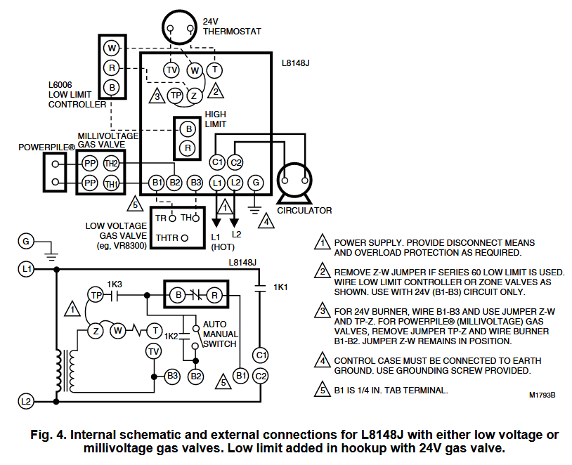

    I don't agree. B2 and Tv look like the common to me. The high limit to B1 is breaking the 24 volt hot

    or
    remove jumper z-w
    add jumper to t-tv
    connect z at aquastat to r on thermostat
    connect w at aquastat to w at thermostat
    connect c on thermostat to either t or tv on aquastat

    @EdTheHeaterMan , your recommended wiring diagram probably does get the job done, but I think @pedmec has the better way. EDIT: Better How? requires relocating jumper wires. Is that really better? especially when you don't do this for a living
    The line in question is the 24v from the transformer, through a thermostat contact, powering the 1K relay coil, and back to the other end of the transformer.
    The Common in an AC circuit is the point of zero volts, neutral, usually the white wire, and could also be tied to ground. In the diagram above, that would be TV and B2. So let's make that the common, or "C" wire.
    By removing the jumper from Z to W and relocating it from T to TV, you have created the place that ties directly to COMMON and will always be Zero volts. Connect W to W on the NEST, and power the NEST with 24v by connecting R to Z on the aquastat.
    SIMPLE.

  • this is all that is needed
    Don't change any jumper between Z and W on L8184E control. Leave it where it is.
    Must I remind everyone that Electric is colorblind and it can't read either. This works for the control that @erikengquist shows in the picture. L8148E. It does not work for other controls like the L8148A

    B2 is neutral on the line volt side. There's a reason Honeywell puts a cardboard divider between the line and low volt terminals.
    W/Z is Common on the low volt side.
    You will sometimes see diagrams using W for switching through the thermostats or completing the circuit on zone valves, but not on thermostats that require 24v power.

    The L8148 comes in three versions. The L8148A controls line-voltage burner circuits; the L8148E,J control low-voltage burner circuits; the L8148J controls millivoltage burner circuits. All models control
    line-voltage circulator circuits. L8148A,E,J have provisions for adding low-limit controllers; L8148E,J can power valves in multizone systems.
    And this is where the confusion might arise. B2 is common on the line voltage models. However B2 on the low voltage model may not necessarily be common on the E and is not part of the low voltage circuit in the J model. It is isolated for millivoltage use of B1 and B2 thru the limit.

    EdTheHeaterMan Posts: 12,948
    TV = R
    T = W
    Z = C
