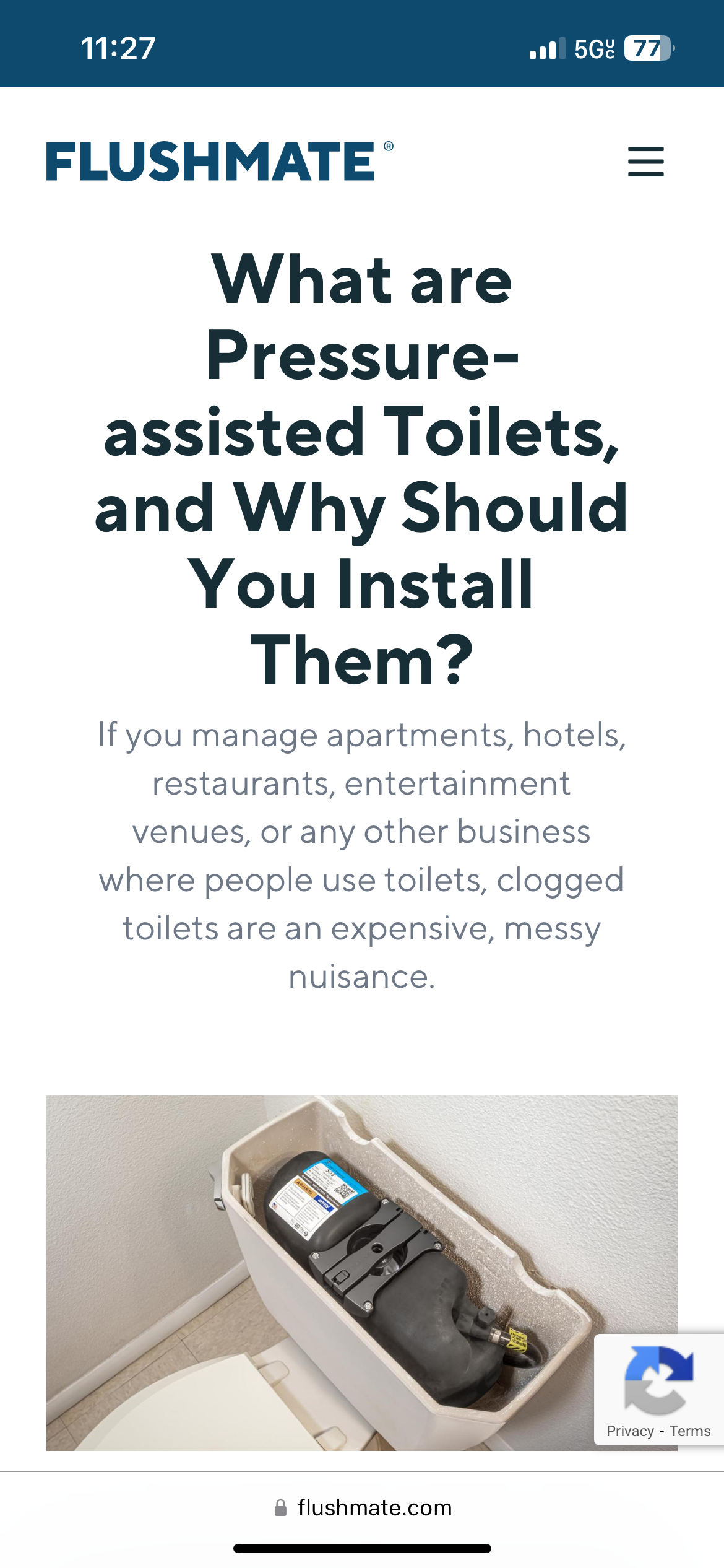

    If you expect a potential problem get a toilet dual flush, a flushometer, or one of the pressure assisted with the Sloan pressure tank system type
