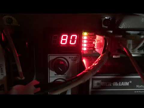

Hello,
I was hoping I would be able to get some help regarding my Boiler that won't stay lit.
I have posted a youtube video here that demonstrates the issue that I have been having.
https://www.youtube.com/watch?v=uTT0Ia6k0B0
Essentially what is happening is the flame will initially light, but then the flame will go out. The system appears to be trying to re-light periodically, but fails. If I manually power the boiler off, and turn it back on, it will light, but then it will go back out again after a few minutes, and then attempt to relight itself again and fail. The linked video is about 13 minutes long, and has a pinned comment which shows the points where the flame goes on & off, and reset attempts are made.
This is a Weil McLain GV90+ Series 2 model. I had replaced the Module Control Unit a few years ago, because the first one was faulty. It was replaced with an upgraded part. I did inspect the Module Control Unit today, and it looked fine. I didn't see any fried circuits like I did on the one I replaced a few years ago.
I also replaced the ignitor a week ago in the hopes that would fix the problem. Replacing the ignitor didn't seem to help with the issue, as the problem is still occurring.
I took a quick snap of the pressure gauge as well. It should be attached to the posting.
Let me know if there is any more information I can provide.
Thank you.

I notice that the flame indicator light goes out, but all the other lights stay on. This means either that the flame goes out by itself for some reason, or that something is reducing the gas flow below where it can sustain, or that the control isn't getting the word that the flame is present.
It may be the control board. Or it may be a bad connection in any one of the wiring harnesses (or a bad ground), or a problem with the gas supply. Beyond that, without being there, can't help you much.Br. Jamie, osb
Thank you Jamie and Edward for the insights!
I cleaned out the condensate trap as suggested, as there it was filled with rusty metal chunks. I don't think it has been cleaned for at least a few years.
I do recall that the condensate trap had gotten clogged before a few years ago, but last time this caused the boiler to make a popping sound. It is interesting that this time it decided to have a different disfunction. I don't quite understand why.
The boiler has been working properly for the last 12 hours at least
. I am not sure if there are other underlying issues, but I would think the suggestion of having the boiler serviced regularly is a good idea.
