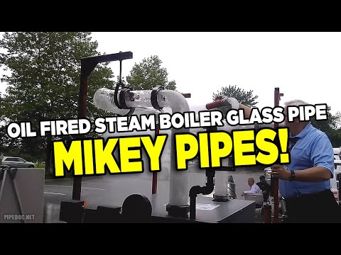

    The one contractor showed me the recommended Piping configuration (from Burnham) , which I also saw on this site and the Wells McClain boiler demo:
    https://youtu.be/8qPphcgj_0I
    Hey did not say why the corrrect piping would extend the life of the boiler. I assume that the thought is that not as much water would escape reducing the number of water refills (addition on Oxygen).
