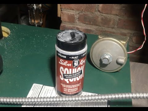

You may or may not be aware of what Squick is supposed to do, but now here is my video showing exactly how Squick affects wet steam caused by oil in a boiler, and in a test container. I also review and discuss the Squick patent from 1963 and even give my opinion about the product, shocker!
I hope you enjoy it. If you have any questions about my process you can leave them here or on the video. The video is too long, so there's a nice table of contents in the video description but you may miss pearls of ignorance if you don't watch the whole thing. And of course there is a 6 minute section where the video is rotated because I'm too lazy to re-export the thing and my hard drive is full, sorry about that.

    EBEBRATT-Ed Member Posts: 20,982
    I watched about 95% of the video. Good job @ethicalpaul
    So yeah, the Squick works. Skimming is better. I think mixing it with water and pouring it in the safety valve opening is fine.
    Should contractors skim? Yes!!
    Will most of them skim? No
    Is Squick better than nothing? Yes
    It's good for the contractors that won't pipe the boiler right anyhow.
    Maybe those guys can use Squick
    But they won't be able to read the instructions for using it anymore that they read the piping instructions
    They will throw the whole can is because more is better

    Good video!  I knew Squick had been around for decades so it had to have some value in some situations.  Now I know more
    ethicalpaul Member Posts: 9,002
    edited January 2022
    Thanks, all 3 of you.
    The thing is, it really doesn’t want to mix with water. But it’s so light and fluffy it might kind of “flow” through an elbow if fed through a funnel or paper cone

    I'm glad you are having good results @Zipper13. I'm not familiar with Scout--I'll keep my eyes open for it.
    But I will offer that if your boiler bangs on start up then there is likely a piping issue that you might look at having addressed. If you start a thread with photos people may spot something that is causing it. Look for places in your main piping and radiator supply piping where a sag or low spot will collect water. Since it happens at startup, any water that has collected in a sag will be cool and can cause water hammer as steam hits it. Then it warms up and the banging stops.
    Also, I would not advise draining 1/2 gallon every other week. It may not do much harm, but there should be no reason for it. Old boiler water is good boiler water in my opinion. Let the loose crud build up over a season and blow off (or drain) a half gallon or gallon maybe once a year at the end of the season. Or maybe even just every other season. And remove, inspect and clean your probe-type LWCO every year or two.

    Scout followup:
    I had a look at it and it seems to contain TSP and our friend from the Squick video diatomaceous earth (that's the part that won't mix with water).
    So I would classify it as a cleaning product that one might consider as a one-time post-installation cleaner/oil absorbant. Even though the Hercules (Oatley) company's marketing folks want you to keep buying and using it over the lifetime of your boiler, I don't see a reason for that.
    A lot of manufacturers do recommend a one-time use of TSP and then flushing after new installation to wash out a lot of the oil but if you want to do that (and I did with my boiler), plain old TSP is a lot cheaper than this stuff ($17 per quarter pound!!)

    @ethicalpaul The SDS for Scout available from Supply House also shows Barium Sulfate and Diatomaceous Earth as other ingredients. Another source shows amorphous aluminum silicate at up to 90% of the mixture. I don't have a bottle handy to check the label but it seems there is more than TSP in there for Scout.
    And I'm sorry to have derailed this thread away from Squick! I was just interested that both seem to be poorly mixing fine power treatments
