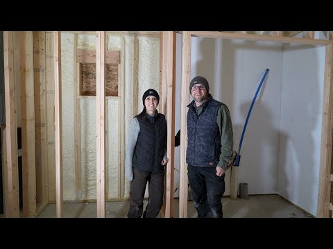

Yea lets build an off grid house with an outdoor boiler in NH and not put heat in the bedrooms. Nah we don't have no codes up here. A couple space heaters and it'll be fine...
Maybe we should scrap the IRC, NEC, IBC, IPC, etc. And just let natural selection do it's thing... If only it wasn't for dumb luck.
Yes I know technically you don't need heat emitters in every room to meet the requirements. And this is often possible with high performance houses. But they ain't building a high performance house. 2-3" of spray foam on 2x6" walls hardly cuts it and 3" on the vaulted ceilings doesn't even come close. They gonna be cold.
/rant

    Too bad they opted for an outdoor 'smoke dragon.' They'll be processing and storing a LOT of firewood, or else buying it in and storing it. They could have spent the same money and bought a really nice INDOOR wood boiler and burn 1/3 the amount of firewood. Except they didn't allocate the indoor space for an indoor boiler and DHW.
    Solid_Fuel_Man
  • JakeCK
    JakeCK Member Posts: 1,502
    I don't even know how they plan to heat domestic water. No LP or NG, and they are running off solar and batteries. They do have a very large solar array but I think they are still going to end up way over taxing it and will come up short at the worst possible time. Coldest, longest night of the year with a ft of fresh snow on the panels. And they have made no mention of solar water heating. Maybe an indirect off the boiler?
    They have said their plan is to build a bigger house in the future and heat both with that boiler and use that little house for something else so maybe that's why they aren't concerned about heating the upstairs. But for the cost of pex and the weekend afternoon to run it, it is cheap insurance.

    I know it can work, and the code handles that by going by a minimum temperature that needs to be met. Not by demanding heat emitters in the room(s). But considering how little insulation they're using for their climate I'm willing to bet they will have problems when it gets real cold. Bottom line they have not mentioned in any of their videos any heat loss calculations, how they have sized the boiler, or even any kind of calculations for the radiant slab. Based on their indecision it's a pretty safe bet they haven't done any of the math off screen. Yet they were willing to spend 10's of thousands on foaming the house and still falling short of code minimum. Lol
  • psb75
    psb75 Member Posts: 1,101
    A side benefit of spray foam is its air-sealing component. So...they've at least got that going for themselves. Downstairs radiant won't make the upstairs comfortable. It depends on how the two levels are separated (i.e. loft, # and type of stairwells etc.).
  • JakeCK
    edited January 2022
    The air sealing is going to be real good. At least initially, doesn't spray foam potentially shrink and pull away from the framing as it ages?
    If it was a loft like setup it would probably work. But it isn't, just an L staircase.
    Edit: Actually that begs another question. How are they planning on handling ventilation. Doesn't foam off gas too? :P
  • psb75
    Foam doesn't shrink...lumber sure does though! Good questions about ventilation. ALL designers/builders today should pay close attention to air quality issues. It's a hot topic of course, that is now 'raging' during the pandemic!

    I simply cannot understand the love for spray foam in a studded wall. All that thermal bridging. And it's so expensive, better to have spent money on a real wood burner.
    I could be off grid with my electrical consumption. Actually we just had an 80% increase in electricity.....so I'll just conserve more.
    For what it's worth, my own home has no emitters upstairs and radiant slab below and R35 walls and anR60 ceiling. Triple glaze windows etc.
    JakeCKkcopp
  • JakeCK
    edited January 2022
    Exactly. So expensive yet not as effective as other options
    They did have a professional carpenter build the structure and dry it in. But he was old school. Headers even on non bearing walls. And all of the headers were dimensional lumber with plywood to make up the difference. Advanced framing allows for foam board in place of the plywood if your with in the limits, and doors and windows can be built with out headers on non-bearing walls. Reduces the usage of now very expensive lumber and reduces thermal bridging.
    They really are a good example of a family with more money than brains. 🤷
    OH, in one video he mentioned that spray foam increases the strength of the house 300% because it glues it together. Hurricane strapping would probably be more cost effective if he was that worried about it.
    Also at r-35 and r-60 your coming up close to passive house levels of insulation. I bet you leave windows open until November...

    I work on repairs, and new construction, residential and commercial, with some industrial mixed in.
    It amazes me at the vast differences in wood framed buildings. I've seen some 100+ year old stuff which is horrendous, but is still standing. Joists cut with no support, heavy cast iron plumbing hung on them twisting them. 2x6 floor joists spanning 15 feet at whatever spacing they decided to do irrespective of the last ones they put in. This isn't from some 1960s bastardization either.
    I've also seen 1950s construction which is the same. Also some construction from the post war era which is so straight and tight that I bet you couldn't fit a sheet of paper between any of the [square cut] lumber.
    There are very few people in construction who truly understand how heat moves.....leaves a structure. Here in climate zone 7 that is an important factor. Sheet good insulation products are wonderful for that.
    To me spray foam is best for retrofit in older homes. Especially good for sealing up an attic very quickly with as little damage as possible to the interior.
    @JakeCK when I walk onto a jobsite which is new construction and I see headers in gable walls with a truss roof.....it's the same mental reaction I have when I see a contractor putting the circulators on the return on a new I stall boiler. They simply don't understand what they are doing. They just do it the same as they did the last one.....
    Rant over....for now....

    The spray foam link is a little alarmist - it is on a site that sells air-sealing materials in competition with spray foam insulation. I agree that one should not rely on spray foam as the primary or only air seal because of the likelihood of failure, but one should not rely on any one "thing" alone - there she should be backups and multiple layers - they will all fail somewhat over time, for some reason.
    My home renovation took place over a nearly five year time period. It is a 1920s arts and crafts home, framed with larch (very tough, rot resistant). The outside was wrapped in VP100 Blueskin and I also put 2" of foam in the walls. I also had to do a lot of acoustical caulking on the framing, and I eliminated every thermal bridge on the framing with 1/2" of polyiso insulation. The remaining wall cavity was filled with rockwool (time-consuming - I wouldn't recommend doing this, and wouldn't do it again). Attic has R-60 or more insulation (mostly cellulose, a little bit of Rockwool). It is all about attention to details - there is no one magic bullet, as much as the spray foam industry would like you to believe they have it. I did most of the air-sealing and insulation work myself because I would not trust a contractor to get the details right.
    In any case, the walls were open for two years after being spray-foamed and before I installed the Rockwool. I never saw any shrinkage (I was looking for it). The frame was all old, dry larch, so that helped - there was no framing shrinkage. I can imagine that new framing that shrinks would be a problem with foam.
    In any case, heat loss is maximum 20,000 BTUs per hour at 0 degree F in a 7500 degree day climate with <1.0 ACH50. Square footage is 1750 square feet.

    I question too the amount of foam installed. I've been following this channel for almost 2 years as entertainment. I had to comment to the guy that when his wife runs a nail gun she needs eye protection. You have to wonder how he finances all this stuff. He got a nice tractor/loader for free to showcase it on the channel. There's money to be made right now on the Tube and he is cashing in.. I'm amazed that every time he digs in the dirt he unearths boulders the size of a VW bug. Either he's pulling in $$$ from the channel or he inherited a nice trust fund. I wouldn't mind 1/4 of the guys energy.

    Maybe this is a better example of what I'm talking about:
    Any else see a problem with this?

    He seems to have done a good job with his water and air control layers. Zip sheathing well taped, the windows look to be properly flashed, full Ice and Water on the roof. House will be tight. Might need an HRV/ERV for air exchange.
    Thermal layer? I would not have done the spray foam. I would instead have used ZIP R to break the thermal bridge and dense packed the stud bays with mineral wool.
    But I am saying this not knowing what short term price gyrations he had with his supply chain.
  • JakeCK
    edited January 2022
    He didn't frame the house or really do the zip sheathing. That was mostly the contractor he paid. It is well done though. His attention to detail around the windows is good, won't have a problem there. Maybe he learned from his shipping container debacle. This will be a tight house. But unless he adds more insulation to those stud bays he'll be at maybe r12 in the center of the bay. Considerably less where the framing is. Unless he uses an hrv he will have moisture and air quality problems. He's going to want an hrv over an erv just because of the moisture. And because of the low r value of that foam is he's gonna have mold. 4" of polyiso over the sheathing would have eliminated the moisture potential and combined with 6" of cellulose would have made for a really warm house heated by nothing but his own flatulence.
    Zip r is only about 3r I think unless I'm mistaken. Far to low for the climate to keep the sheathing above the dew point, they easily get into the negatives Jan. and Feb.
  • woobagooba
    woobagooba Member Posts: 186
    edited January 2022
    "He didn't frame the house or really do the zip sheathing" ... but he was smart enough to pay for a proper job.
    You can get ZIP up to R12. ZIP R or polyiso ... agreed w/ mineral wool or cellulose in the stud bays. Again caveats with supply chain / pricing madness.
    What he do ... 4" inches closed cell foam in the walls? That will net him about an R20 wall (accounting for 20% thermal bridging of the studs). I was told last year that dense pack and spray foam were quoting close in price.
