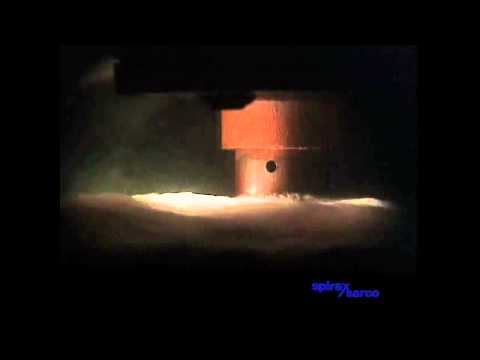

    https://youtu.be/UES7BCmBups
    You could simply drain, replace with fresh and fire boiler to boil off oxygen. Attached video is surging caused by dirty water
