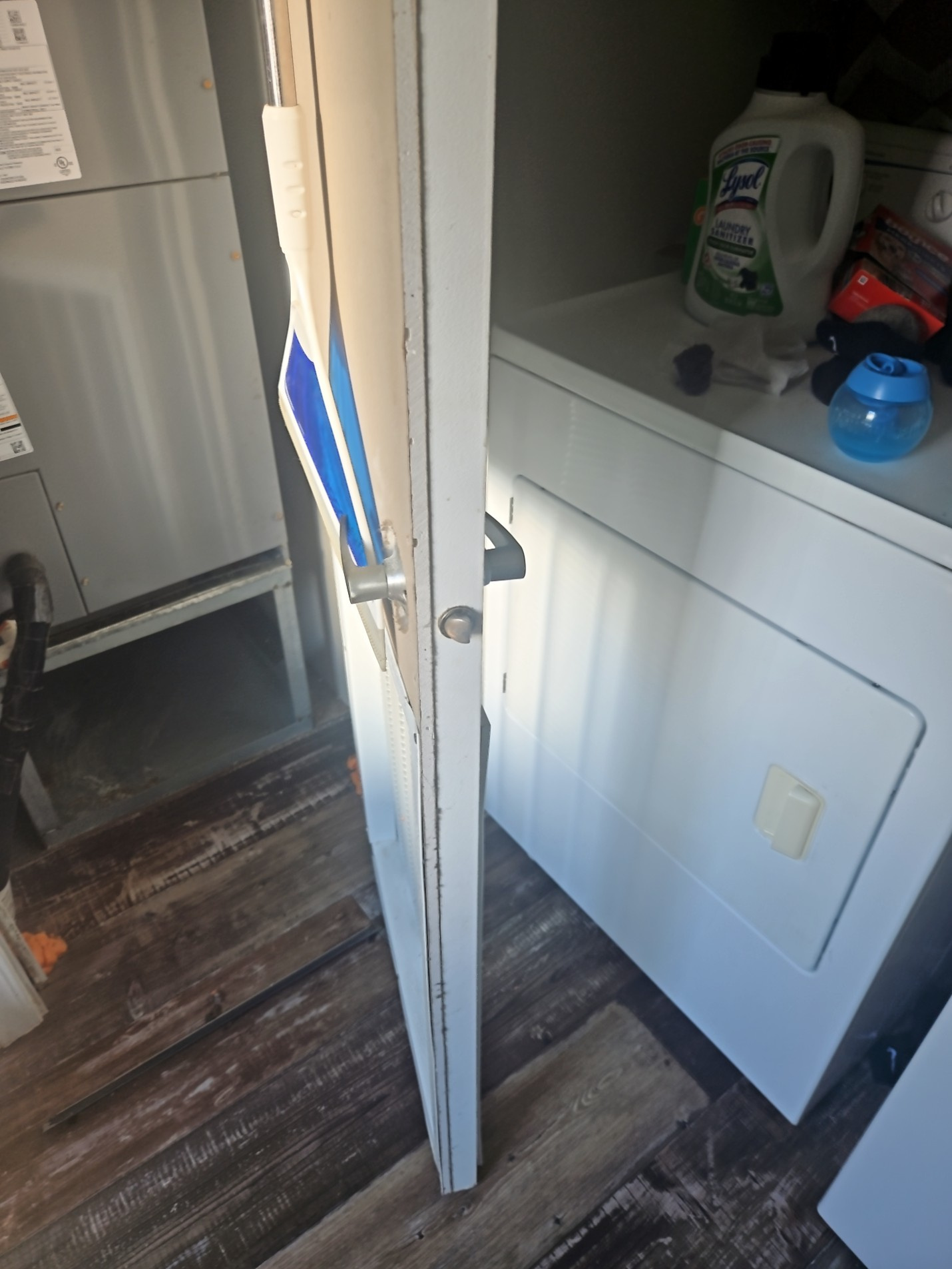

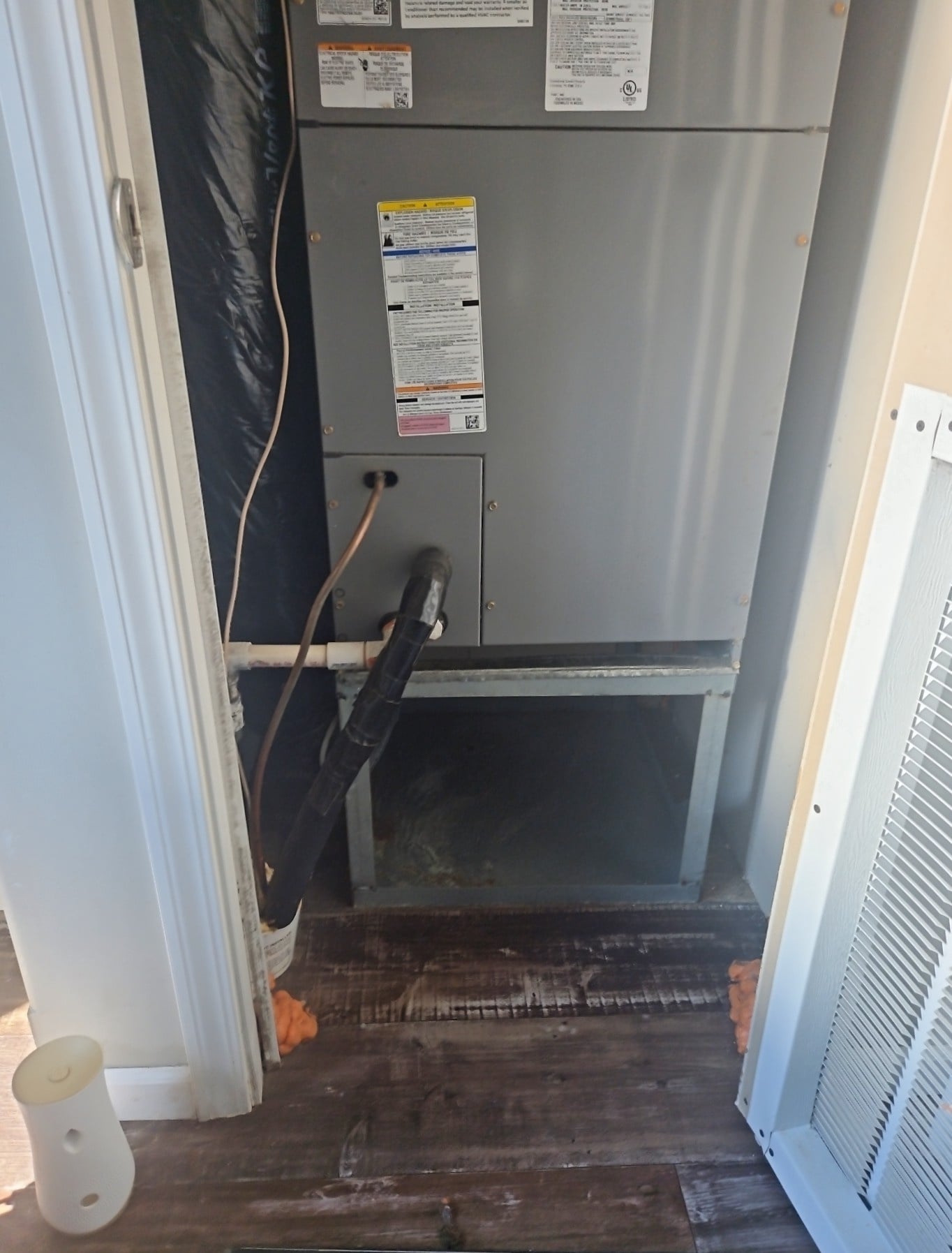

Hi! Just to clarify, I know NOTHING about any of this (which is why I am here) So, I live in a brand new double wide. Went to change the filter and realized whomever installed it, put a pipe right in front of the filter slot. I contacted the company and they said “you just have to bend it”… what? Basically have to bend it in half and tear the filter up to get it out, getting new one in took over an hour and it’s basically shredded…plus I’m sure you aren’t supposed to bend the filters like that, as the little particles could get sucked in the HVAC and defeat the purpose of the filter? Idk. But they refuse to fix the issue, so idk what to do. House is still under warranty. I just want second opinions before I have to battle these people. Thanks!

    But if it was mine, and there was no way to get them to fix it I'd be looking at sealing that room and around the door up completely and somehow adapting filters to that door. It would give a whole lot more surface area to the "filter" and make it easy to change. Perhaps you can get two off the shelf filters that will fit the door well.

    Where does that drain line go to? Just draining to the earth below?
  • JUGHNE
    JUGHNE Member Posts: 11,623
    I would guess that drain hose just dumps to the crawl space under the home.
    That is the standard method. And in MS there is probably a lot of humidity there already.
    For the few of these I have done, I bring a solid drain out of the skirting to daylight.
    (you could look for that outside for water dripping out)
    Also being on the suction side of the blower, there should be a trap in the drain.
    They may have formed the hose into a "S" trap below the floor, but maybe not.
    This could lead to the AC coil water drain pan overflowing and water dripping onto the floor under the furnace.

    With the house under warranty and the install instructions NOT being followed, contact the builder and demand it be corrected.
    Its clearly in the IOM to leave access for filter changes and as others have stated a P-Trap is needed on that drain.

    North MS, and yes that’s exactly what they did. There is a pipe that runs out into yard that comes out of skirting.

    One possible solution is to filter the entire door as ChrisJ mentioned above.
    The old school method for mobile home door inlet air return was to use something called "filter media", it comes in a roll that you cut with a scissors.
    You cut it to fit the inside of the entire door.
    It has to be held in place as the blower is trying to pull it into the furnace room.
    What was used was a wire frame that had 2 x 4 squares in it.
    It had to cover the entire media and be strong enough to hold the filter in place.
    The wire is somewhat like a light gauge fencing weight.
    It is flexible enough to snap into the lip of the door.
    Sometimes a light duty spring is used to secure the frame in place, that would require holes drilled in the inside lip of the door to hook the springs to.
    If you could come up with the combination of 1" cardboard framed filters that would cover the door completely then several springs would hold it in place.
    The room has to be sealed tightly so all the air goes thru the filter material.

    I am truly impressed that the condensate drain is run to daylight. It still needs a trap but they may have run it up hill to go outside which would produce the water seal of a trap.

    I would be more worried about the evaporator not draining and dumping all over the place on hot humid days and not really worried at all about bugs but that's me.....
  • JUGHNE
    Just about every day there is hot and humid until Sept.
    Again if they ran the horizontal part uphill to the outside then the pipe would stay full of some water creating the trap.
    I have seen Utubes where in the south they may run the cond line under the slab and come up outside. The entire line is full....like a wet return in a steam system.
    Susposally no problems with plugged lines.
    Orderoftwisted.....is there a steady stream/dripping coming out of the outside pipe?
    Or do you hear it sucking air and burping water like a slurpie?
    Is surging then plug with your thumb for 60 seconds and release. If a gusher of water comes out then maybe no water seal trap.

    get a tin knocker to fabricate an angle slot in the bottom. Larger filter areas are best.
  • ChrisJ
    ChrisJ Member Posts: 17,622
    I still like my idea earlier in the post of adapting a large filter to the door.
    A nice 20x20 or something standard and huge.
    HVACNUTPC7060
    HVACNUT Member Posts: 7,613
    Agree with @ChrisJ. If the closet is tight, a filter grill in the door would do it.
