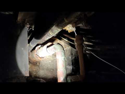

    I'll post a video for the group a little later when I can. There is a sub-basement apartment and a cellar which is the base of 8 feet. The leaking pipe has a walkway built over it for an additional 4 feet. I'm fairly positive it is solid cement. The design is very unusual even for nyc which is why FDNY will often stop by just to show the building off to explain special building designs. I was told they only know of two in Manhattan like it, with two buildings separated on the same property.
    When John from Gateway stopped by last year I actually inquired about installing a second small boiler just for the rear building as I really liked that idea. The difficulty is that you would need to install a flue, which is again very costly as well as difficult in getting NYC to approve another boiler.
    I like the idea of trenchless pipe ramming, but I'm guessing there is no space to work. It really is a tight space and they must have planned for there never to be any issues with the pipe with the cement that deep.
    The 1/2 inch piping is definitely a dry return well over the boiler line. It "works" but as you can imagine there is an extreme hammering in the risers and the water backs up to the point you can hear water in the last riser. The radiators on that riser don't actually even get steam on busy boiler days due to the flood of water that the steam can't get past and the heat comes from the boiling hot exposed riser.
    This is a 1 pipe steam system so the idea of converting to hydronic isn't really possible without more construction.
    As for the comment about money and "doing it right", this is a tenement, rent stabilized property and the bare minimum was done to maintain it for many years. Nobody was getting rich here. In the last four years, I've replaced the hot water storage tanks, the boiler, and installed a new flue. As you can imagine there are also many issues with the building that are not plumbing related that I still have to consider as well.

    I was mistaken about the size of the smaller pipe. Does it look like maybe 1 inch? Here's the video of the situation. It is very rough.
    https://youtu.be/hIhr5yG8zLE

    The steam pipes don't actually go through apartments. They go directly from cellar to cellar. I was thinking there wouldn't be enough room to use any major machinery. The leaking pipe I showed you I'm sure isn't enough to work. You're talking a width of maybe 3 ft. The height of that ceiling is also an annoying 5'7" maybe.

    PS that 1" which drops I expect from the video is a condensate return. pumped could improve the hammering but really not that bad compared to the 1/2" you intially thought you were dealing with. so the header drops to the leaking feed with a return to the boiler just prior to going through the wall by the stairs. and all of that is 8 feet below the surface from your video and dicta. but I don't see why the steam feed couldn't go up the 8 feet and cross the yard. you would probably have to drill under the stair way that has the bikes parked next to it but that is an even more discrete task.
    and BTW, I don't buy that it is solid concrete down to the pipes, except where the stairs and retaining walls descend. still not an easy or rational excavation but i don't think you have to replace at the same elevation.

    Even 1 inch -- and it does look bigger -- is useless for carrying any amount of steam any distance, especially if it's countercurrent. I really do think you will be much happier repurposing that as a dedicated return from a condensate receiver and doing whatever repiping is necessary at the other end...
    from the video, i think that copper is already configured as maybe a common flow return (although we don't see the end of that in the auxiliary building). because it seems to be running at a relatively similar elevation to the leaking steel pipe, maybe even a little higher but it's hard to gauge which would cut against the return theory. there is a vent butI'm pretty sure if I followed the video correctly that that vent is to let steam back around from the other building so it wouldn't be a contra flow pipe albeit that is a guess because the pipe in the supply building is so low. I guess maybe the steam could drop down but that sure looks like a return to me. and the copper drops maybe 4 or 5 feet with no connection at a higher steam delivery level from the boiler so i think it is maybe already a return or common directional flow pipe in any event.
